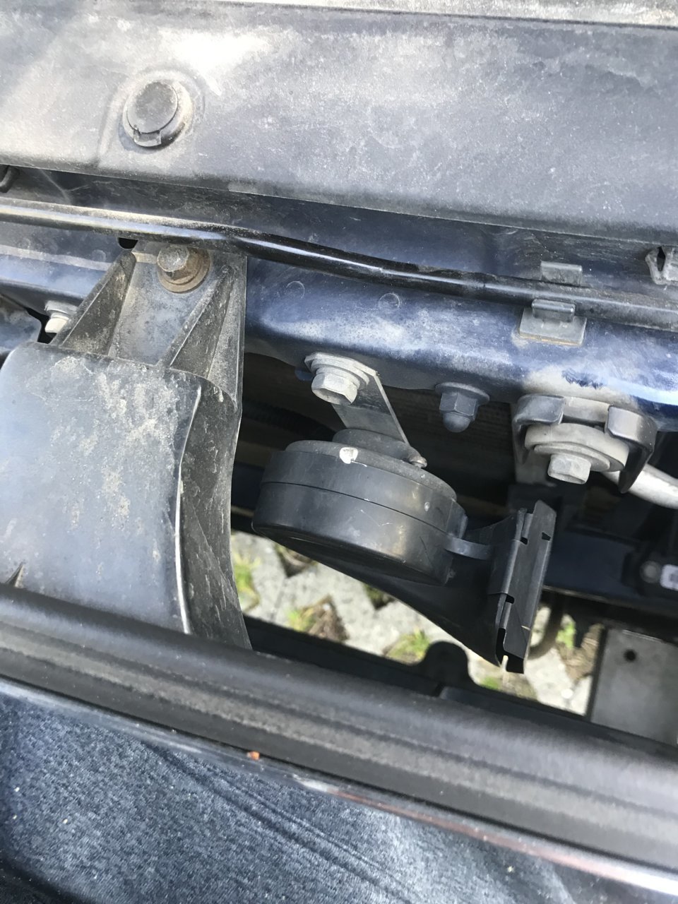

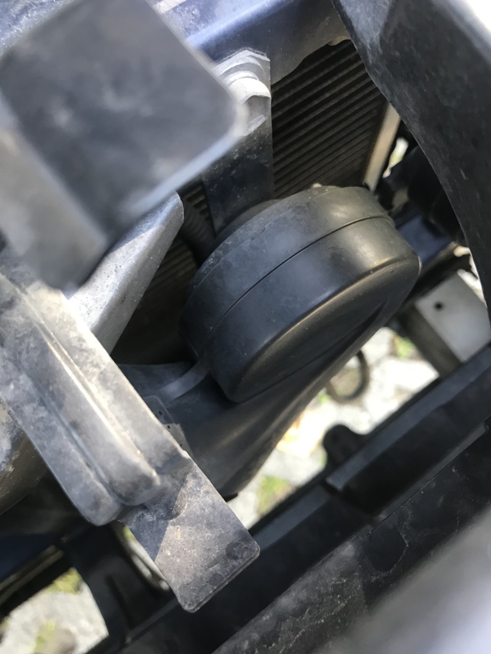

    Pop the hood open and take some pictures and post them up
    Gotta be an aftermarket horn hanging around in the engine compartment somewhere .

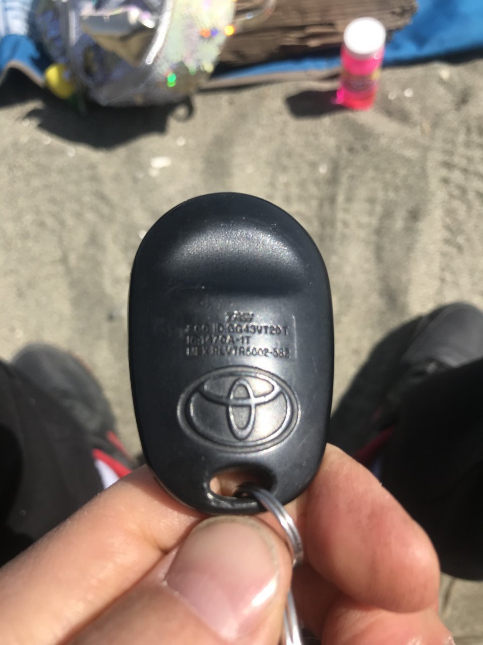

    Got a picture of your key fob ? is it factory ?
    Any signs of wiring under the dash ?
    Doesnt sound factory to me

    I tried that yesterday and the horn started going off which I realize is an aftermarket alarm.

    I posted some pics earlier. There is a cluster of wires under the hood beside the battery but there is a switch wired in the dash that at least a couple of them go to... the switch has power and when I turn it on and check the 2 wires they are live. I’m thinking maybe the previous owner had a light bar or something they took out before selling. So I unplugged the 2 horns under the hood separately and it didn’t make a difference. When I unhook both of them it takes the horn away completely, I only want to remove the horn when locking/unlocking not the actual horn on the steering wheel but it seems they’re all the same horn.

    Yea I tried multiple times, it didn’t work I think I have an aftermarket alarm or something although it is the stock key fob.
