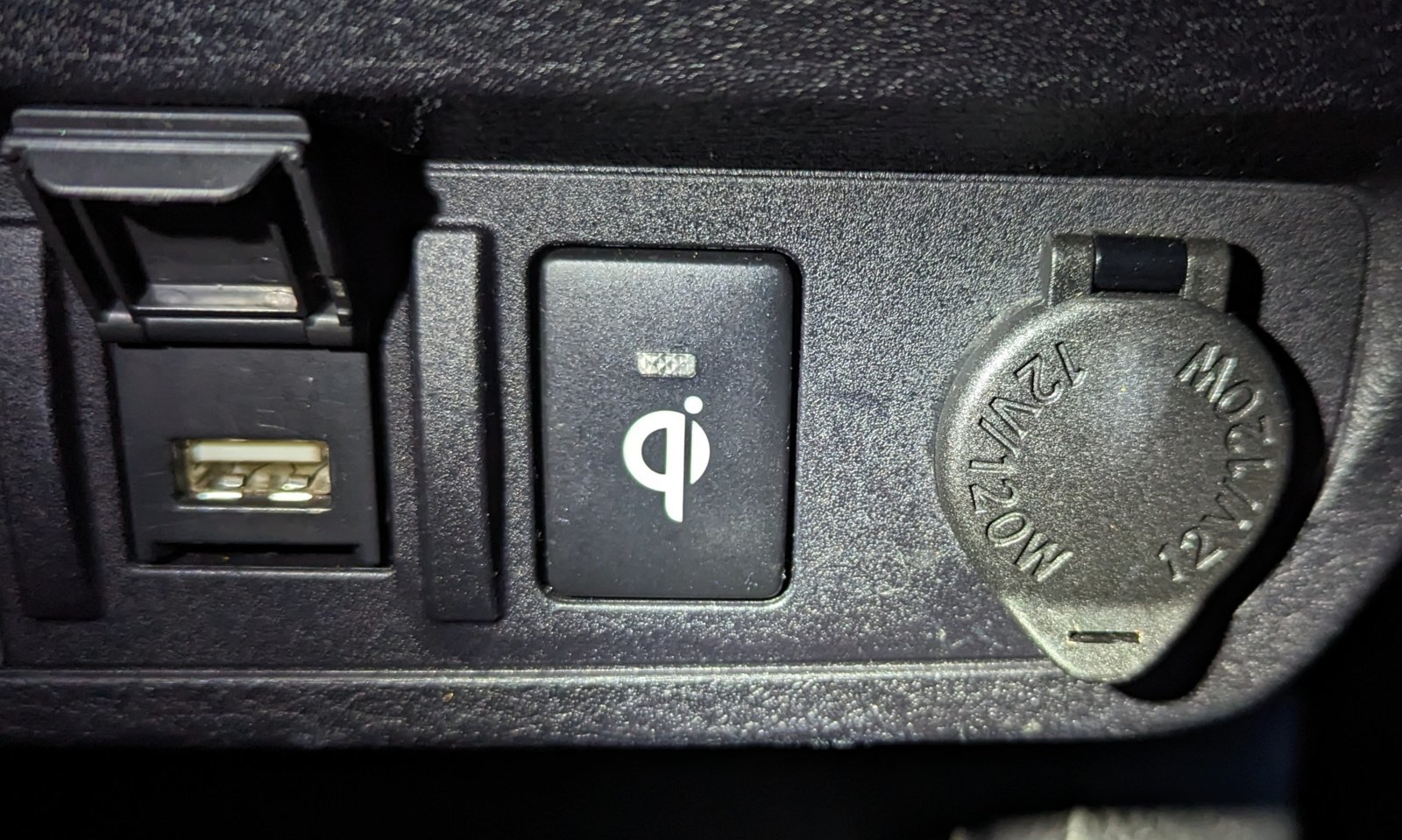

    Hey, guys; WTF does this button do?

    Wireless charging

    What he said, specifically Qi spec wireless charging. That’s what the logo is - letters Q and I.
