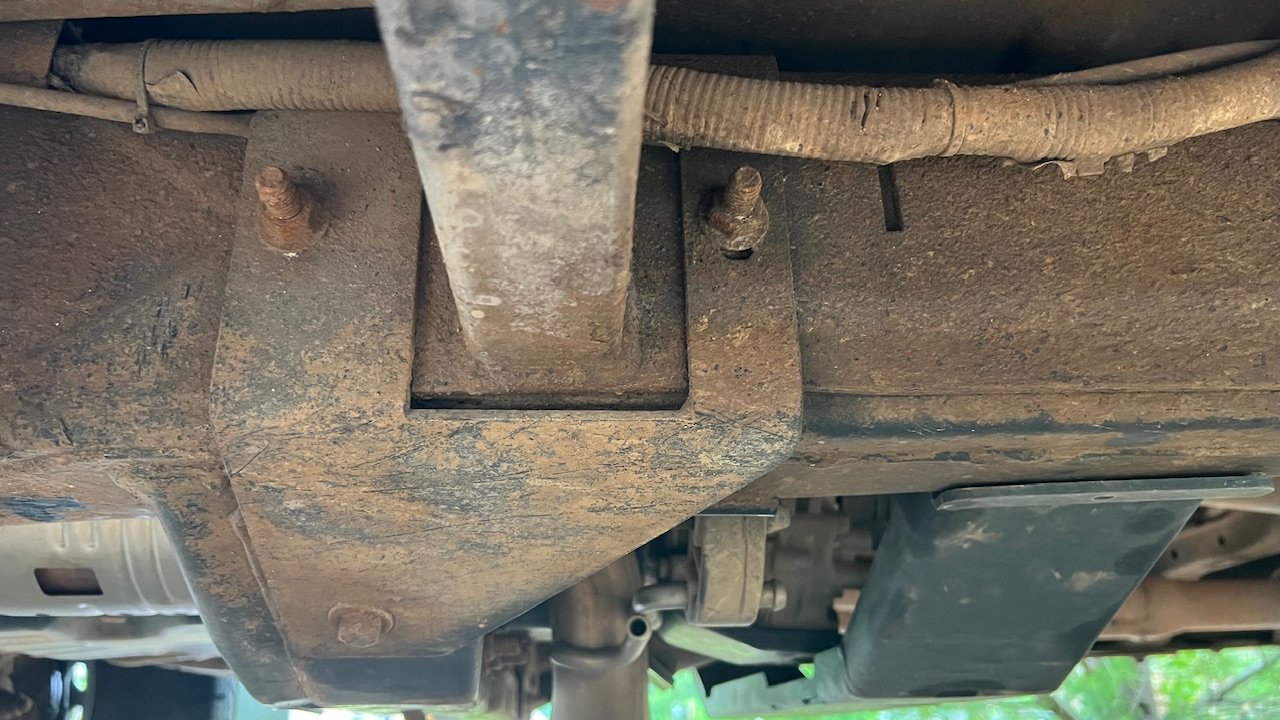

    On another note I finally finished putting those front brackets on the RCI sliders. I could not for the life of me get my arm past the brake lines and into the frame on the driver's side so I opted to just stick with only two bolts on that bracket. I drilled two holes on the bottom of the frame and got an additional bolt added on each side. We're at 6-7 on the driver's side and all 8 on the passenger side. Ended up drilling out the sheared bolt and got a long enough replacement bolt to get a nut on the other side to keep it snug. Buying the replacement hardware came in handy. I have plenty more if anyone else decides to get RCI.

    Yeah, that front driver's side plate was a bugger. I don't have big manly forearms, but I remember they were still scraped up after fighting with the brake line and getting into the frame. Not looking forward to doing that again anytime soon. I'll have to do as much refinishing and rust repair as I can with them on the truck.

    In hindsight, I would never get powdercoated sliders again. It seems like the rust works its way under the powdercoat and spreads. Mine were really bad last year when @OldSchlPunk sandblasted them for me.
    It's actually pretty easy. Although, I really wouldn't want to attempt it on a trail.

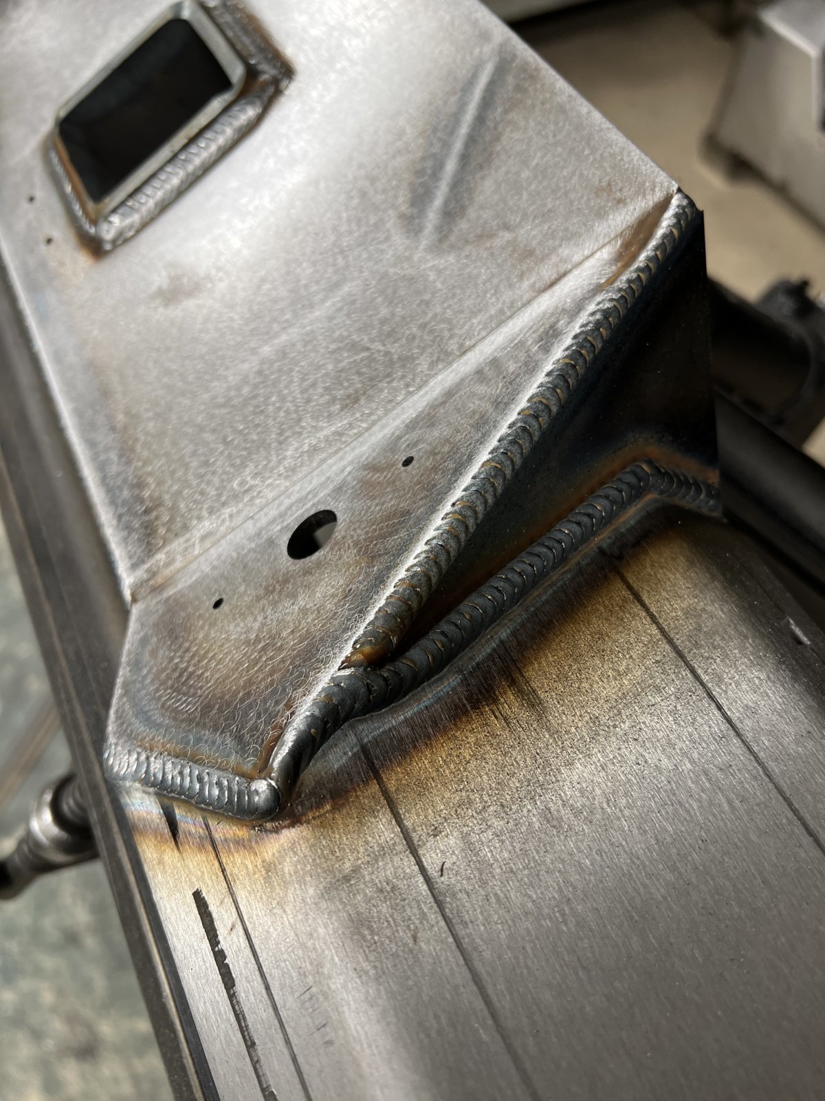

    My bumper offers the most clearance/departure gain of any bumper available for these trucks and quality is unmatched. If you have any questions shoot me a message! IMG_8196.jpg

    Here is how I got the nuts on my front bolts started https://www.tacomaworld.com/threads/rci-sliders-installed.614523/#post-20882819
    Once started I used a long breaker bar with socket on the nut to hold while tightening.

    my forearm is/was just skinny enough to get my fingers to the forward most hole. I opted to put the bolt inside the frame as I didn’t have enough purchase to hold the nut while starting it. Once in I was able use side pressure with a wrench to hold it while getting the outside plate on.

    Got any pics from farther out that show the whole bumper?

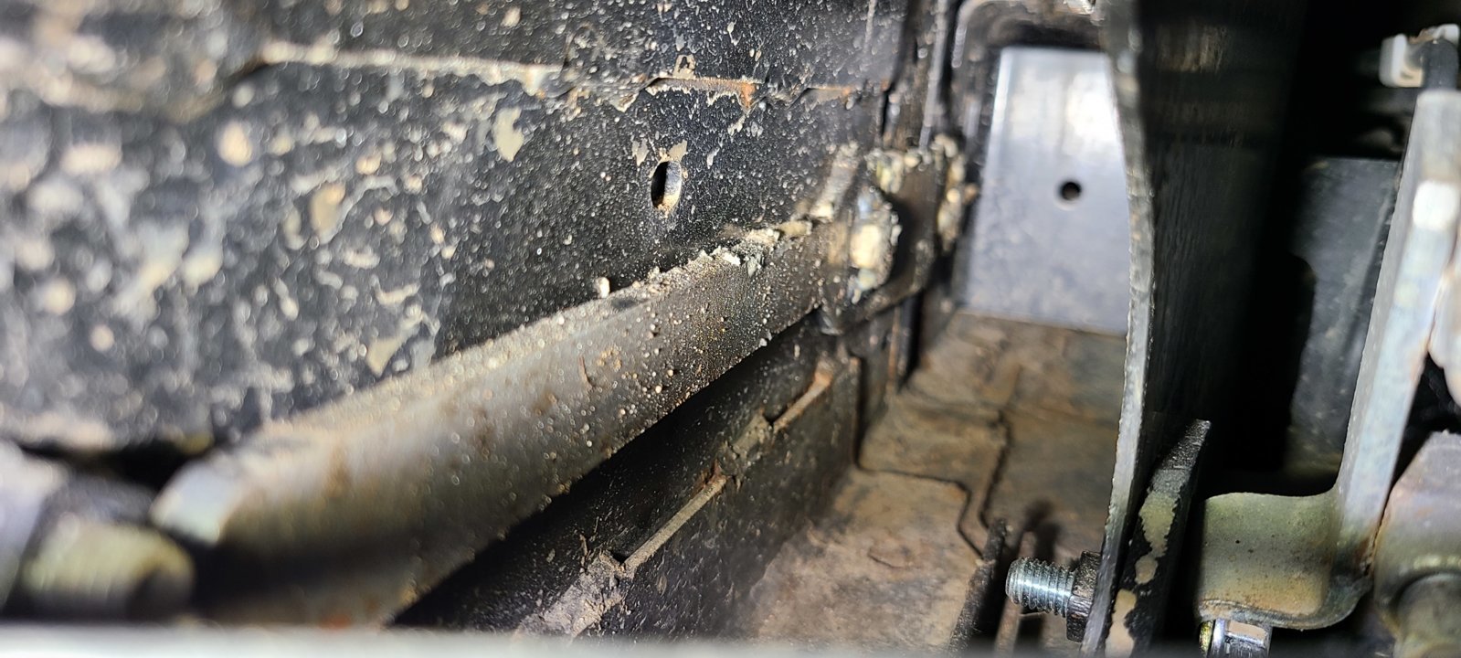

    Finally working on clean up from Arkansas. Jesus what a mess. Disassembly of the door panel just to clean… it will take years and more effort than I am willing to give to erase it completely IMG_1394.jpg

    Wow, you're taking the panels apart.
    Here's an (smart-ass) idea to keep your door panels clean.
    https://www.4xinnovations.com/2005-2023-Tacoma-FRONT-Tube-Door-Set_p_93.html
    Not sure about the interior.:rofl:
    We can discuss it at Tigerton.

    I have thought about making something like that... but, yah. The interior... My seat is getting pretty worn, so maybe time to take it all out and bedline the inside...

    Those welds are beautiful.
