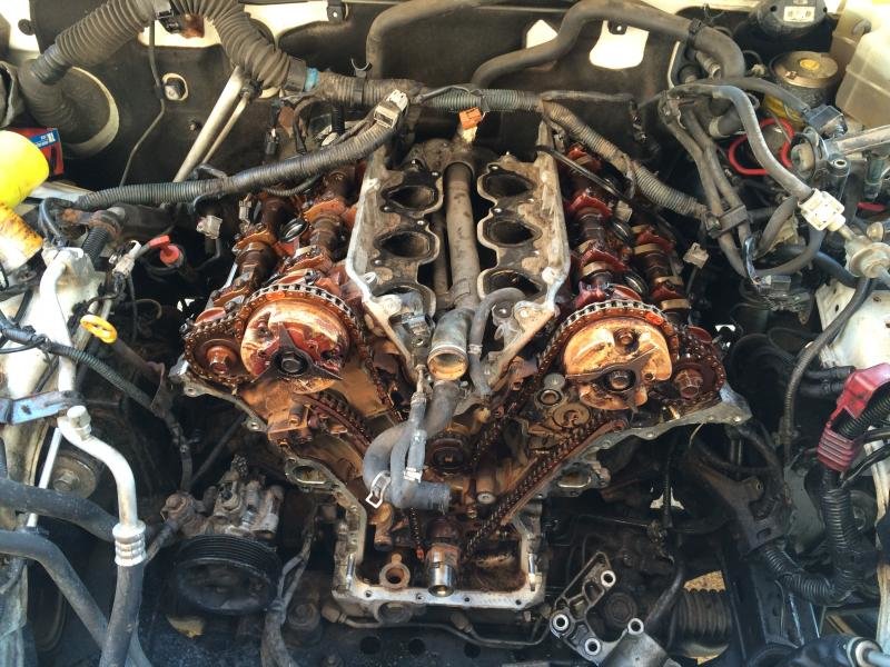

    Almost, almost.
    Well, today was much less productive than I had hoped. Turns out crank bolts are notoriously hard to break lose, and mine proved no different. I spent probably 5 hours trying all sorts of things; running to the auto store, Ace, scouring the internet and fabricating a cool looking, but worthless device, to hold the god damn pulley still while trying to break the bolt loose. Eventually, what tuned out to be the absolute easiest and least complicated method worked awesome.
    I threaded two bolts through the pulley's threaded holes, and bottomed them out into to the engine cover (probably not the recommended procedure, but by god it worked) and then 4 feet of cheater bar and she popped right off.
    Ended the day with the valve covers and timing chain cover off, ready to pull the chains, camshafts and then head bolts, which should go pretty quickly. Not my pic, but this is what my engine currently looks like, mine looks MUCH better in terms of residue which makes me feel pretty good about the condition of everything other than the HG in the motor.

    Good! I was about to post something about sludge.
    and if you're taking all these pictures, why are you posting others?

    King/Dirt King
    Laziness of pulling SD card, photobucket etc., my photos are just for backup and hopefully won't be needed. Copy paste a URL is much easier :D
