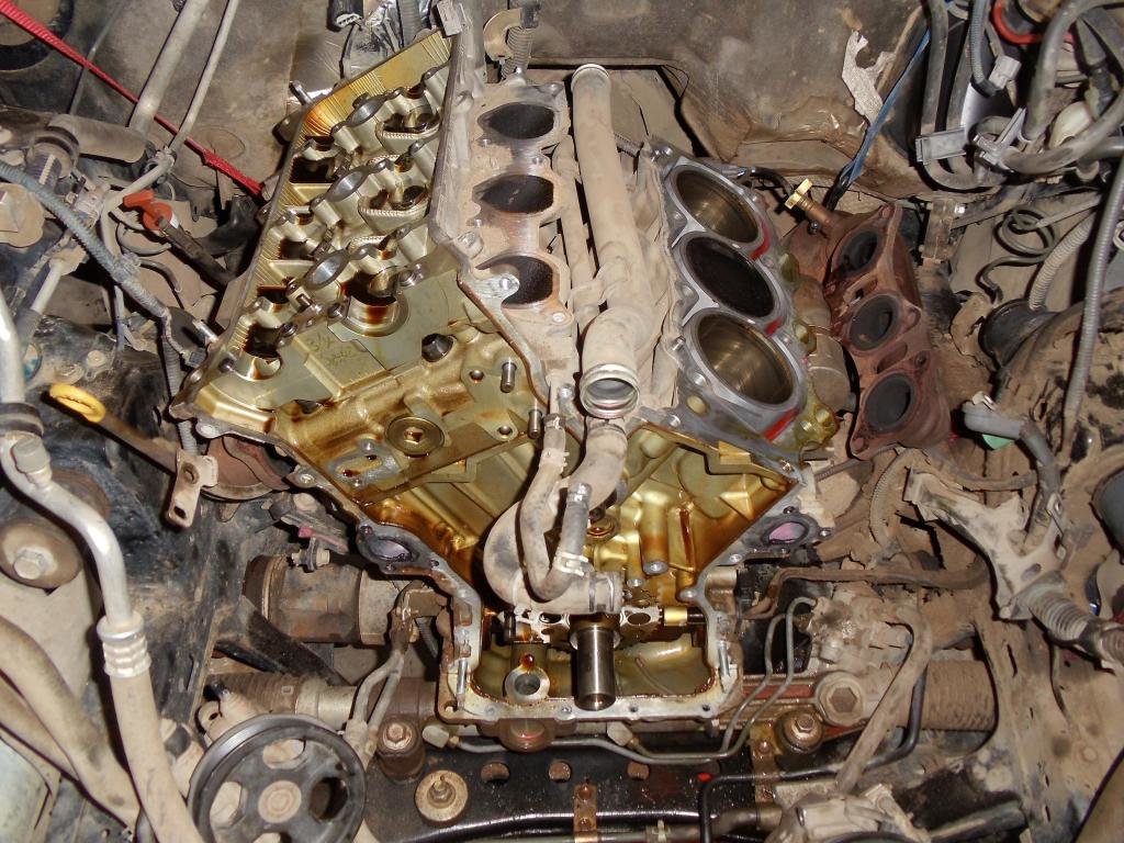

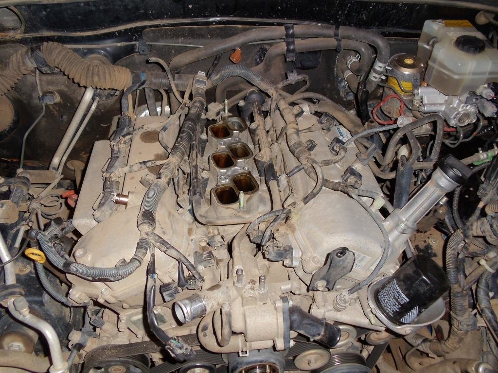

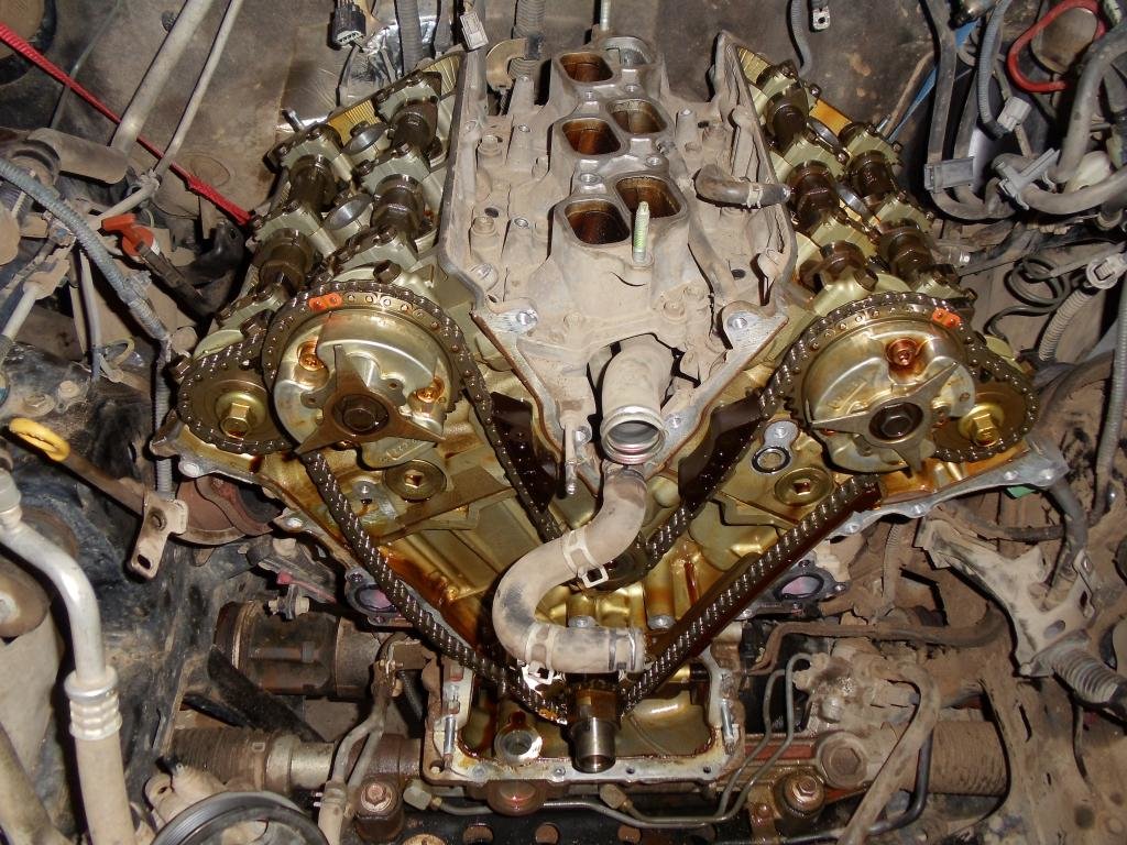

    Haha, thanks. We got the heads on and the timing chains setup and then worked on his swingout for a while, all in all a productive day for both of us.

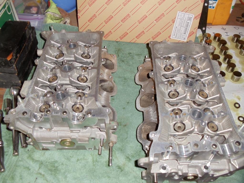

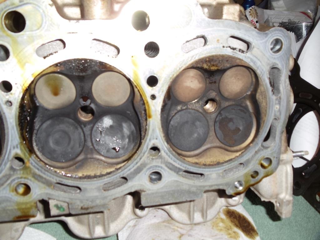

    This is the left (driver) head, #6 is the one on the right, you can see build up from the misfire, and slightly cleaner area surrounding the valves compared to #4 on the left.

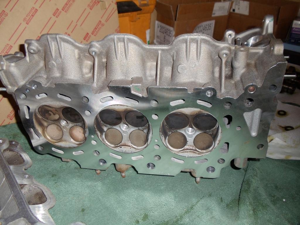

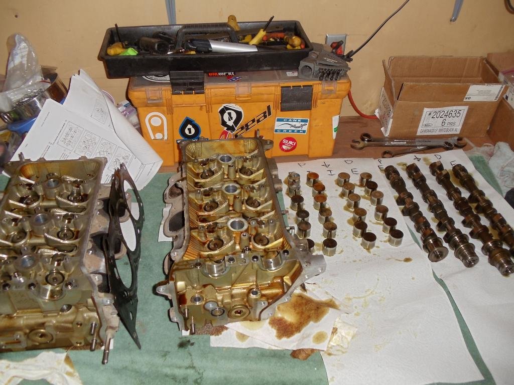

    Cleaned up heads, they took .003" off of both.

    I'm assuming you checked valve clearances once you had the heads and cams back on?
  12. Dec 9, 2014 at 2:34 PM
    #312
    Wishbone Runner
    Wishbone Runner [OP] Because 4R
    Sep 9, 2012
    #86546
    6,353
    James
    CO
    04 SR5 4Runner
    King/Dirt King
    Nope. I did not have the means to do so, nor was there any real reason to think that they needed checking. The lash caps went back in the same spot, and nothing else was messed with that would affect the clearance. All other that have done this did not either.
    Should have? Probably.
    Worried about it? Not really.

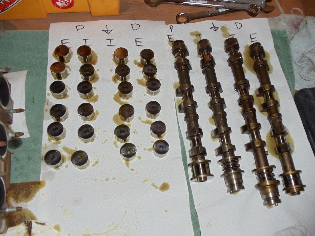

    I just saw all your shim buckets open end down in the picture there...
    Did they not have shims in them?
  14. Dec 9, 2014 at 2:44 PM
    #314
    Wishbone Runner
    Sep 9, 2012
    #86546
    6,353
    James
    CO
    04 SR5 4Runner
    King/Dirt King
    No not separate shims, each cap is marked with it's thickness. They looked like this, but with a number printed on the bottom of each one. The ones I looked at varied from 37 - 45, not sure what the units are though, 1/1000 inch?

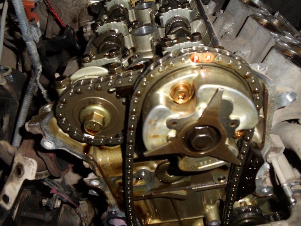

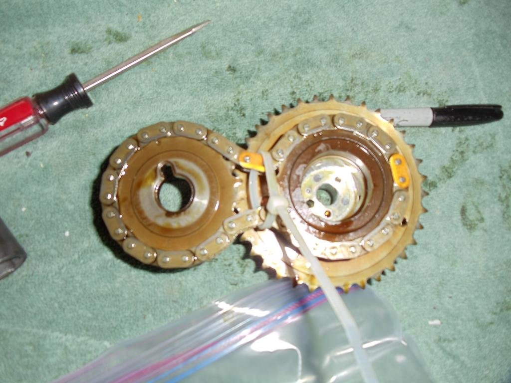

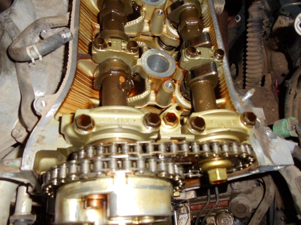

    Here is one with all tensioners in place (not mine, I apparently did not get one). There is one on the main chain, and one on each of the VVTi chains.
