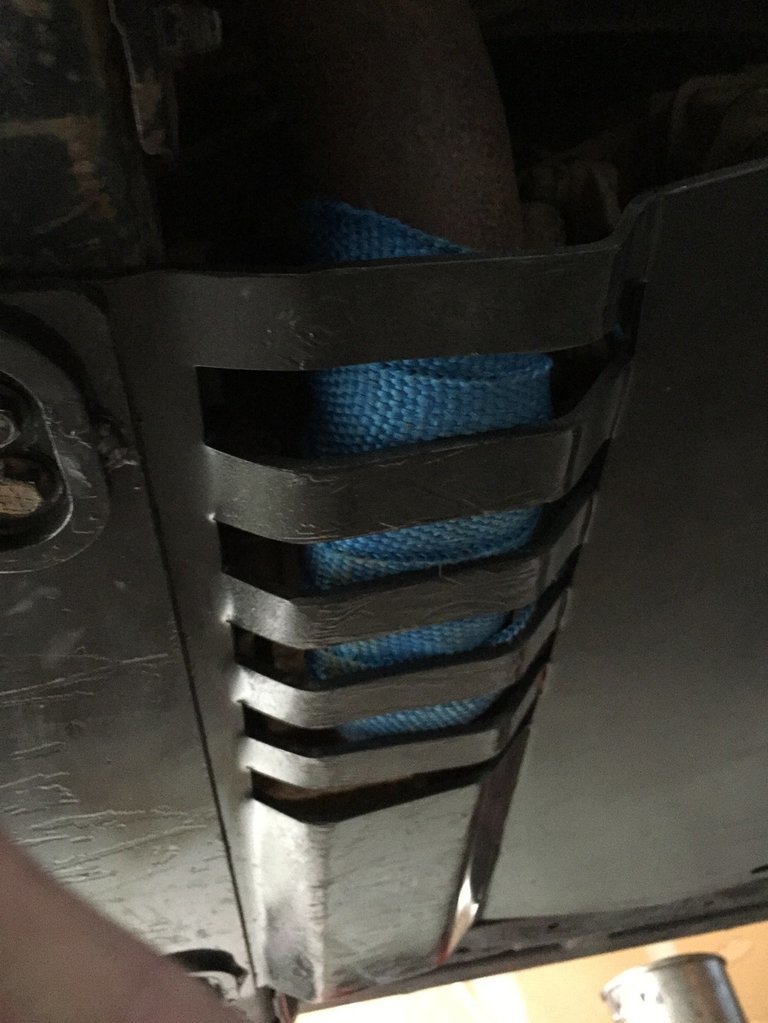

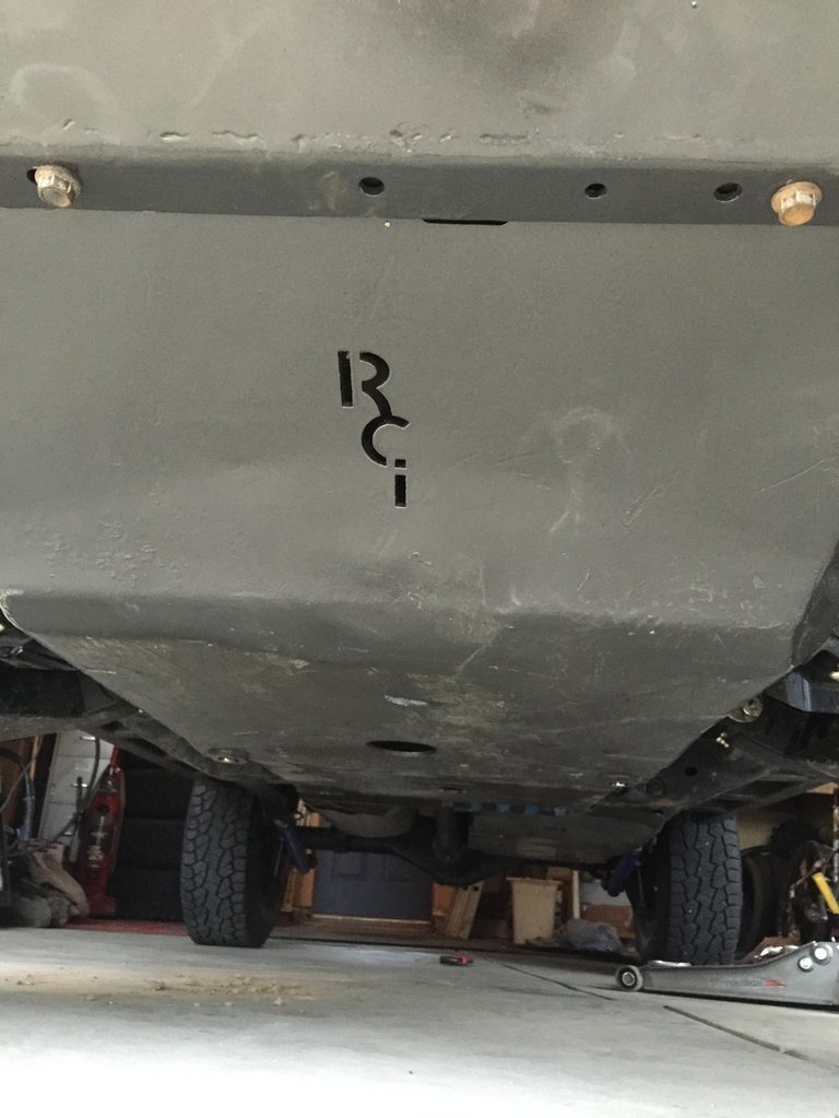

    Got all my skids back on after a few coats of paint. They are in pretty rough shape, I did what I could to beat them back in shape, but I fear next time them come off they may not make it back on. I Bought a this set, but now I feel I could build a much sturdier set myself, we will see how they fair this summer.
    Also wrapped my crossover with header fiberglass wrap to get rid of the rattle of the pipe on the skid that drove me insane last summer. I'll reroute it eventually, but for now this should do.

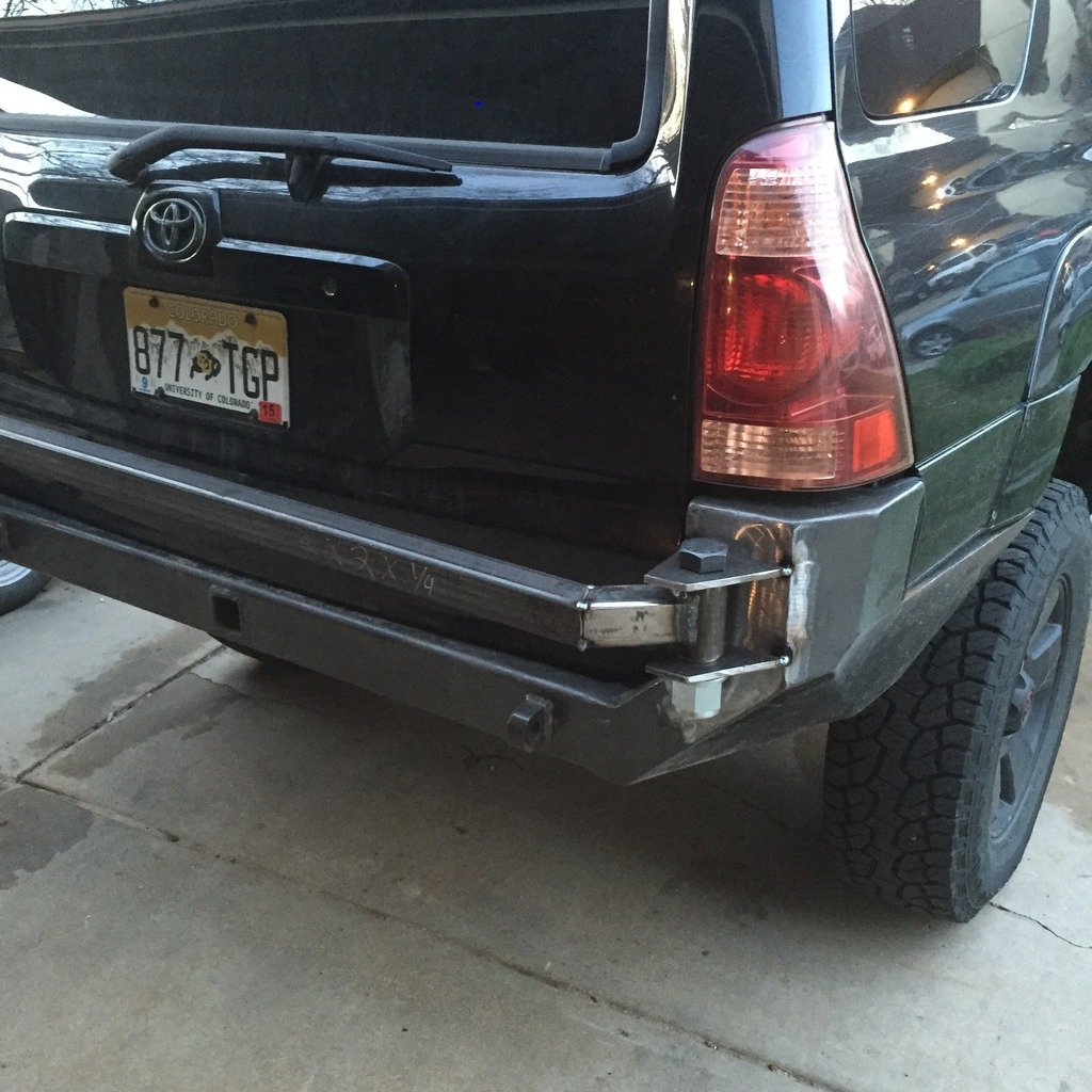

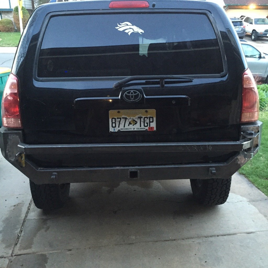

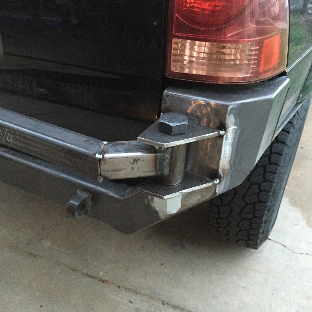

    This evening's work:
    B37C681E-F34E-45DC-B2B7-332CC3831BAE_zps_f8fe33c477e751b51de0f075cd9f859648057bcb.jpg
    78BC0DBF-0954-4957-B5DC-877222128EF8_zps_05a0416dbe1e20deca81b8f5fc65cccee7d56ca0.jpg
    56B4D87E-95AB-476B-B760-94358C9C746C_zps_3d89e9e3b6d75da265afe36eef84f71ff604d678.jpg

    2012 TRD Off Road Double Cab V6 6Speed
    That's a big ass bolt!
  18. Apr 20, 2015 at 8:07 PM

    Haha, sure is, 1.25".

    Nice! Are you planning on gusseting the hinge mount at all? Is that nut nylock? Those are... "fun" to get tightened down :D

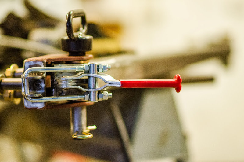

    What are your plans for a latch?
    This is what I did for the latch on my Jeep's tire carrier - I should have done like a 5/8" pin, the 1" was overkill, but it was the stiffest latch I've done yet, really reliable. I was happy with it.
