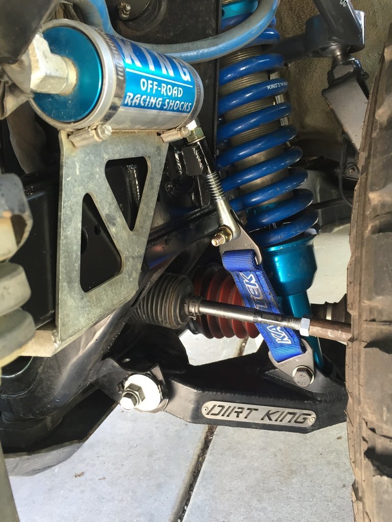

    Got my front setup wrapped up this weekend.
    6C4866EF-6606-43F6-BA7A-23758F8DA68E_zps_e5a404e52b52b69ec92d11c060e4dac023ece10b.jpg

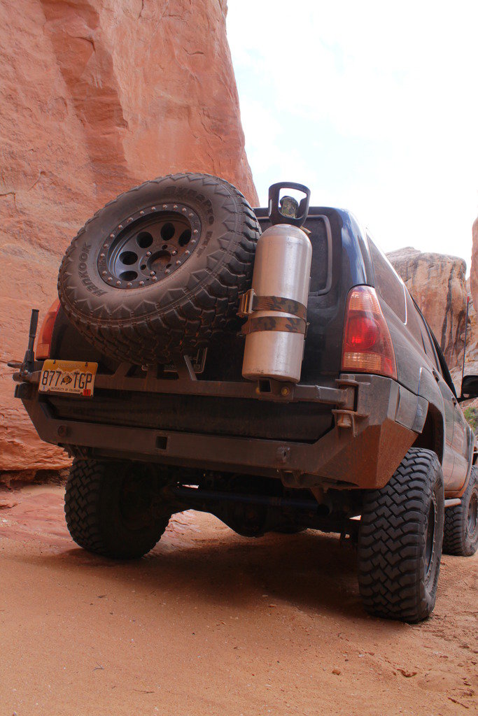

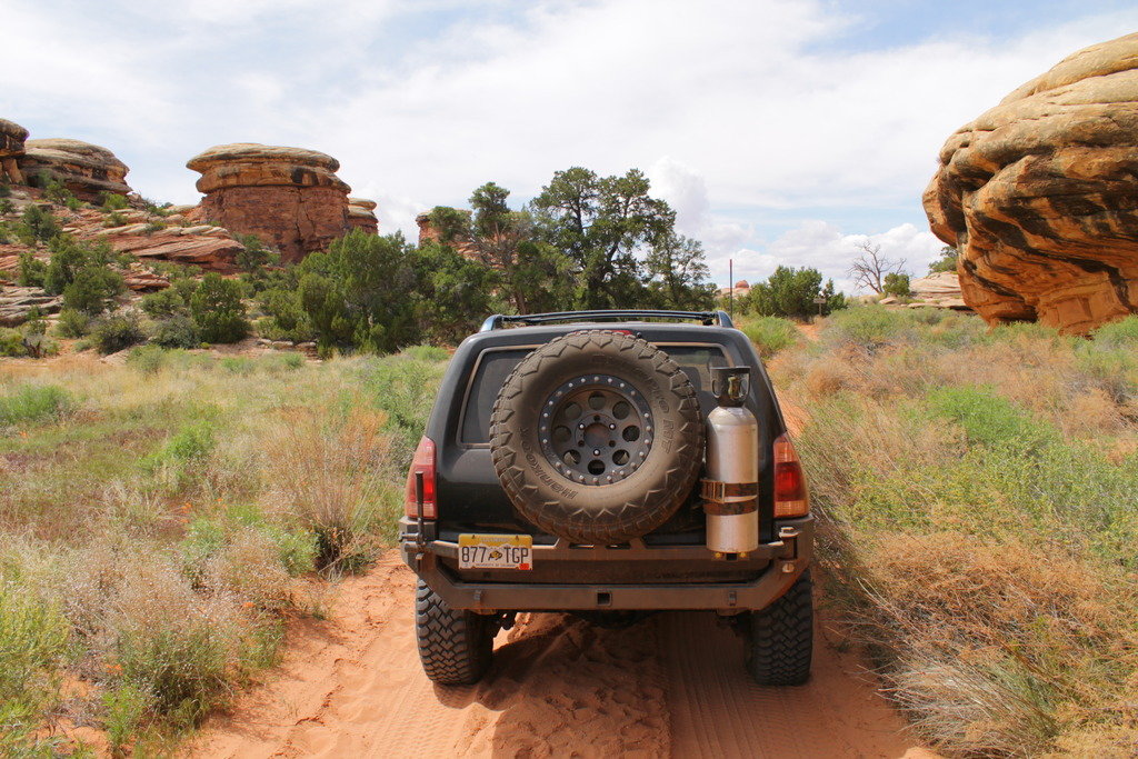

    Finished the swingout last week and giving it a shakedown in Moab this week.

  19. May 26, 2015 at 8:56 PM
    #419
    Tx9812valve
    Tx9812valve Well-Known Member
    Jan 28, 2015
    #147390
    120
    Colorado Springs
    04 TRD SC V8 4Runner Icons
    Nice man! You have any side shots? Looks like you still have a helluva departure angle even with the spare hanging off the back.
