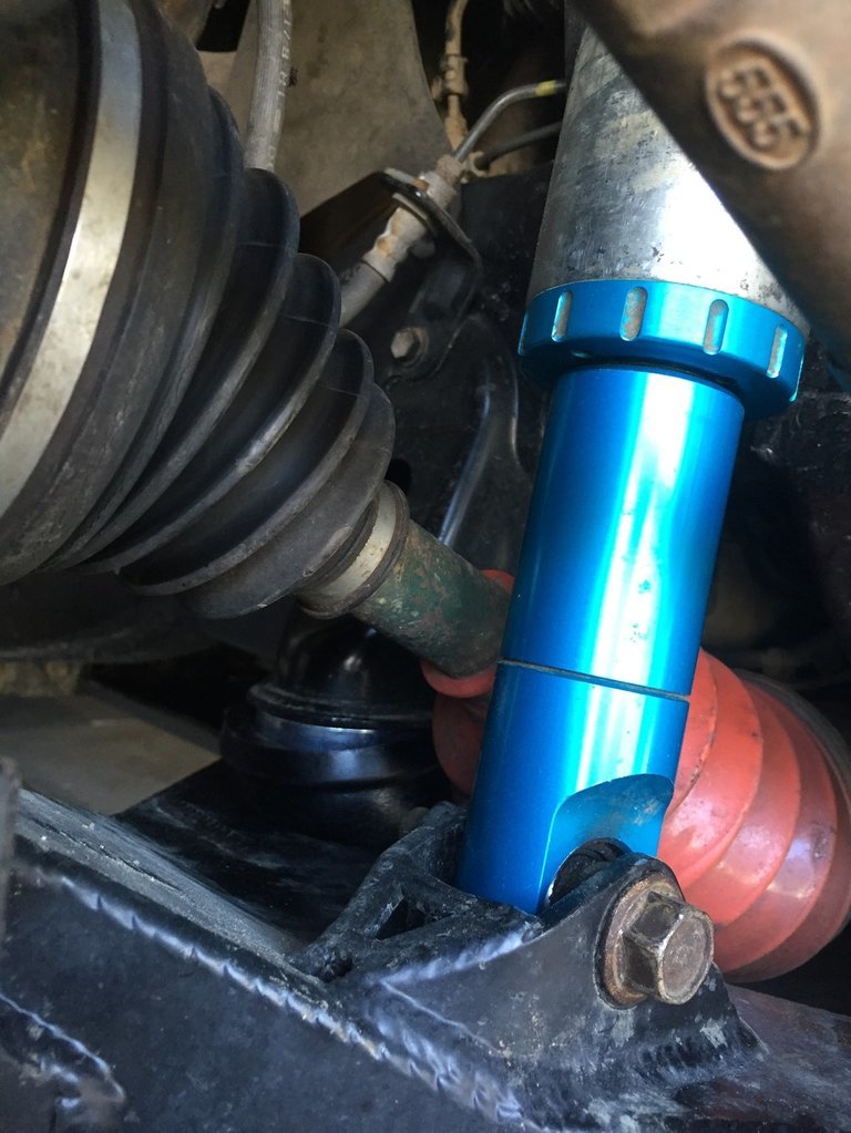

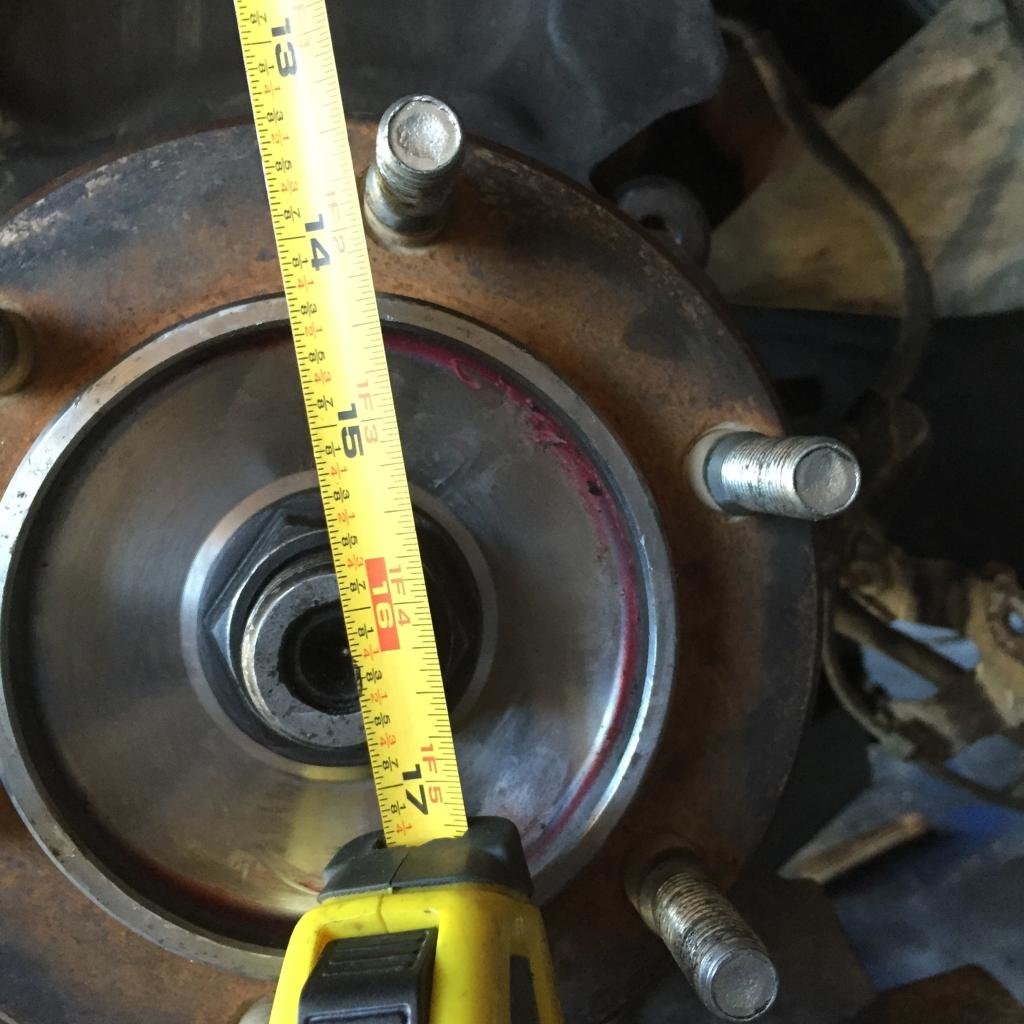

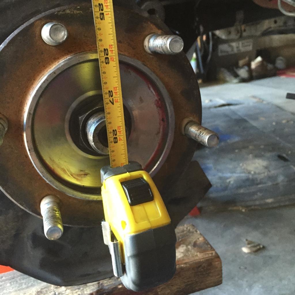

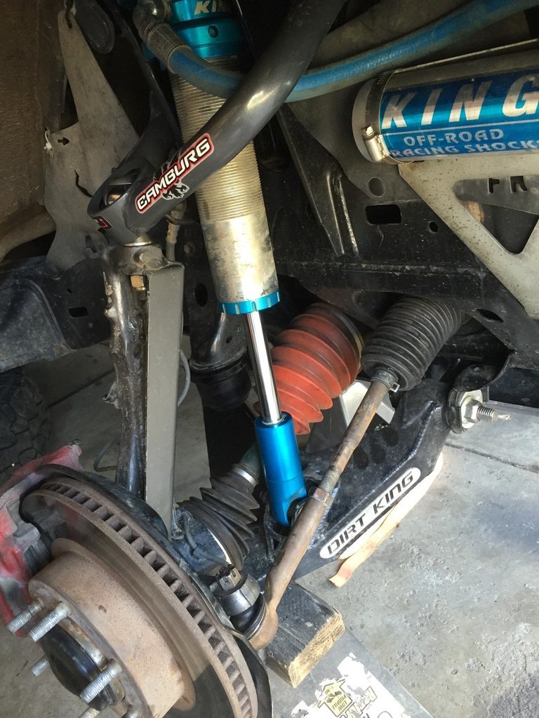

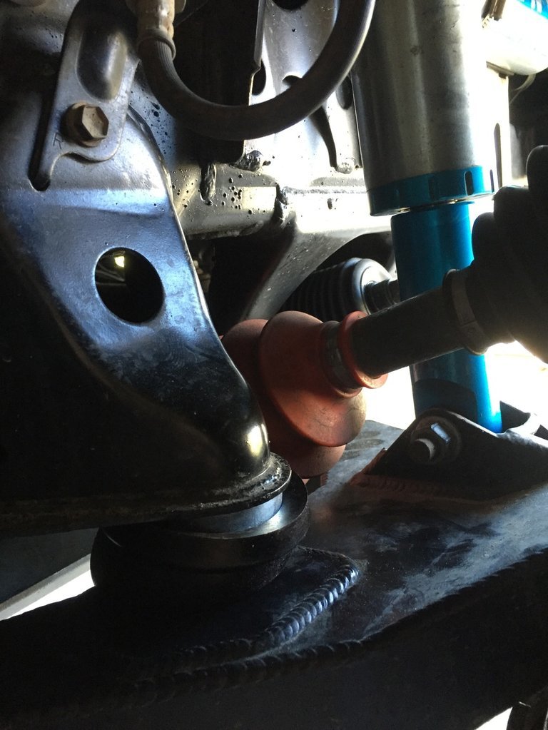

    Based upon these pictures and some measurements I have found of your model King's (25001-119), I have determined your extended height is 21.687", your collapsed height is 16.750". Your allowable stroke on these coilovers before the spring perch is 4.937. If the perch really is .250" (1/4") then your overall new collapsed height is 17" flat. Assuming the 2x1 suspension travel theory on your setup (which is what it is on stock travel Taco's, you guys as well I would take a highly ventured educated guess) your final allowable travel on the setup is 9.374 " (4.687x2).. I want to know how you lost over 2.4xx" worth of travel after adding in bumps and the shocks?!
    Adding the bump alone puts your setup right at 10.375" if I read your measurements correctly on the last page. So you went from 11.750" wheel travel to 10.375 wheel travel. A full 1.375" of wheel travel lost just from installing bumps... I don't understand why or how you lost so much?

    I assume you are referring to the 11.75 from the below post, that was without the shock in, just checking the travel of the arms and CVs, which is well beyond the shock's ability, a shorter collapsed length is the only thing that will fix that. The bumps are not taking any appreciable amount of travel out, just setting the limit the the shaft length, where are you getting that?Bumped and strapped should be right at 9.5", which is the consensus on MT travel.

    21.9-16.37=5.53
    4.625 bump pad to frame
    If its a shorter collapsed length thats needed then as it appears, custom non OE is the way to go to get more travel out of these trucks. :)

    Yes, except I would need to tub, as I kiss the sheet metal as it is. Not worth the effort for another .5" of travel. 35's would be even worse, and I have a 1" BL already.

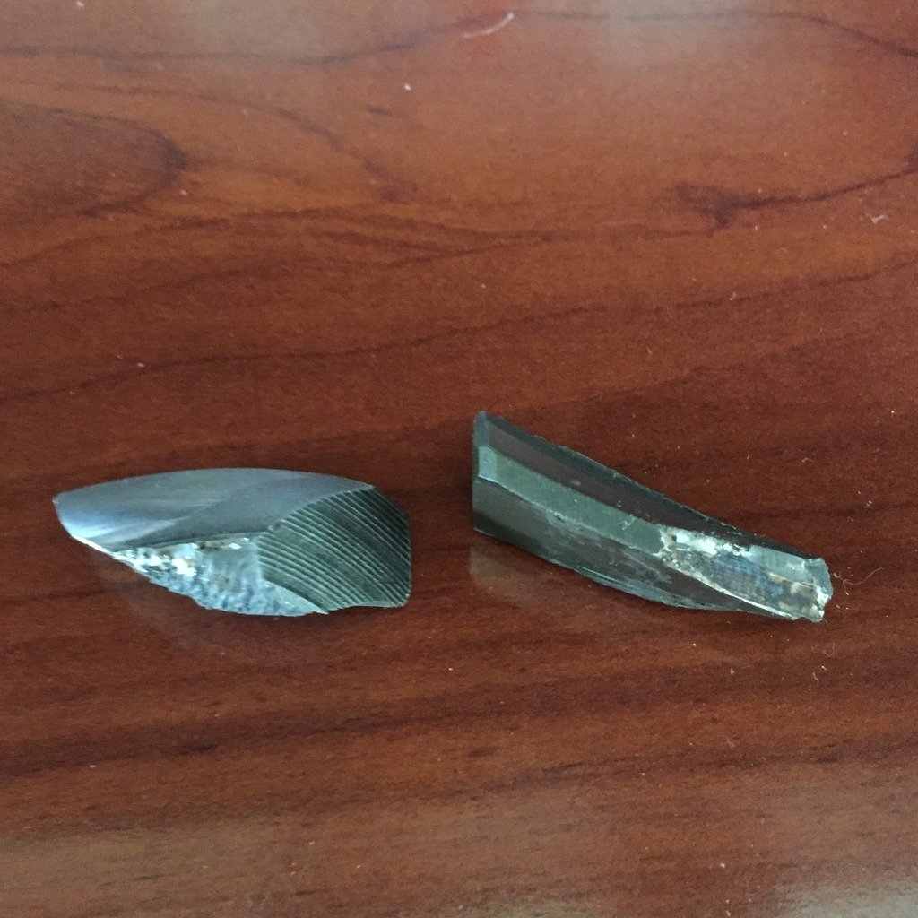

    I became an alchemist in Moab, and turned metal shards into stickers.
    D0F78F2C-F89A-4F05-ADD8-D30268F9CA4B_zps_057ad0336133ef039d3f4286fc225708de8881ce.jpg
    FB195AED-CD37-4D12-A04D-0AF86E81DF08_zps_0e43b61dbc3f6963ebfe339ec0a55894755fc91b.jpg

    I really don't think superbumps are the way to go if you are setting up a max effort mid travel setup. The problem with them is that even at full compression they are very pliable and will not stop over extension of the coilovers if stuffed in too hard. Ask me how I know. ;) that's actually what prompted me to go hydro.
