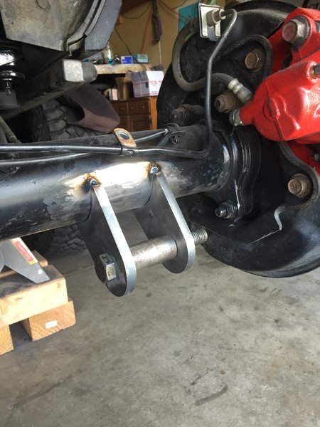

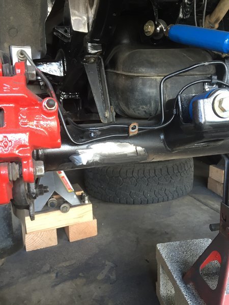

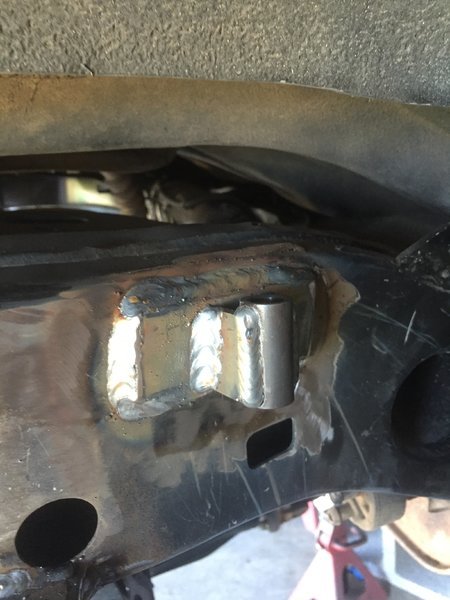

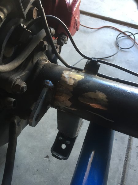

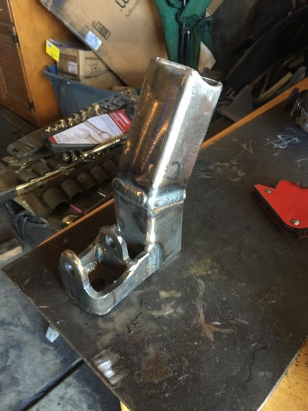

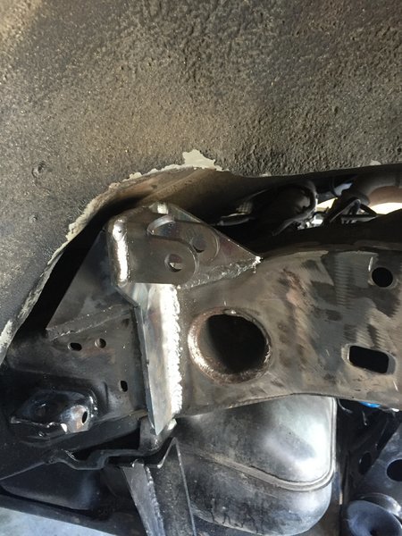

    Rear end complete. Shit ton of work, but I am pretty happy with the outcome, hopefully it performs as expected.
    Before finishing the shock setup I cut off the lower shock/link mount, and welded in 3/8" tabs in the stock location.

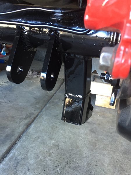

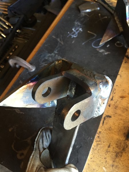

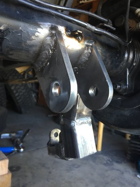

    Then came the lower shock mounts, they ended up being a bit lower than the stockers due to the mount that I used, but they are tucked very close to the tire and should remain relatively out of harms way.
    Painted up.
    While they probably aren't going anywhere, phase II will be adding some more gussets to the link and shock mounts.

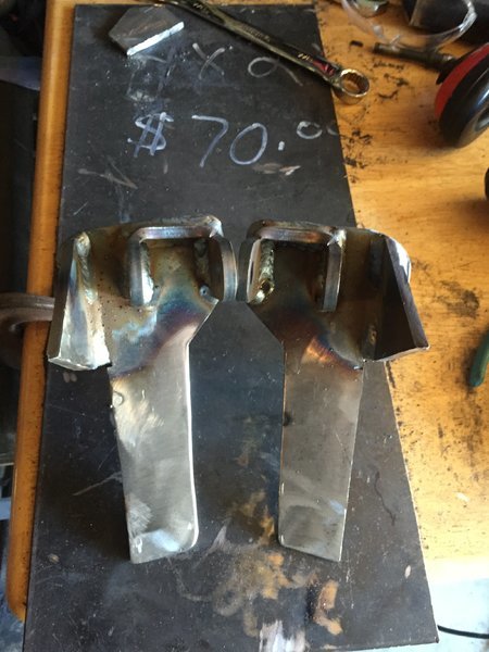

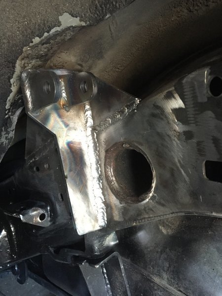

    The upper mounts came together much easier than the lowers, all 1/4"

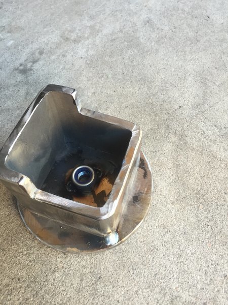

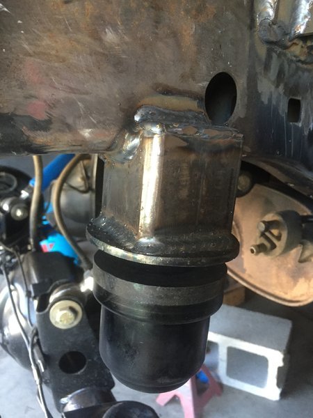

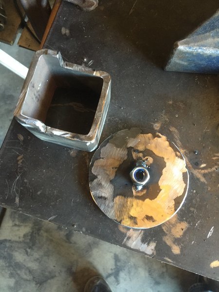

    For the bump mounts, I used 2.5" hitch tube mounted further back than where the stock mounts were, with a nut tacked in for Superbump mounting capability. I left them fairly high up so the height can be fine tuned with the spacers as needed.
    NYCO and SilverGhost like this.
