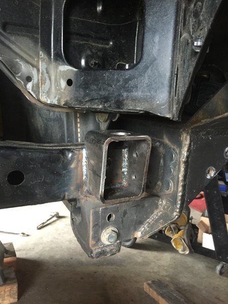

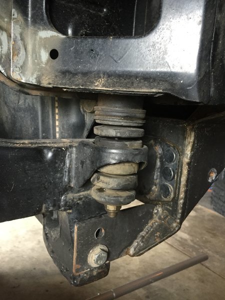

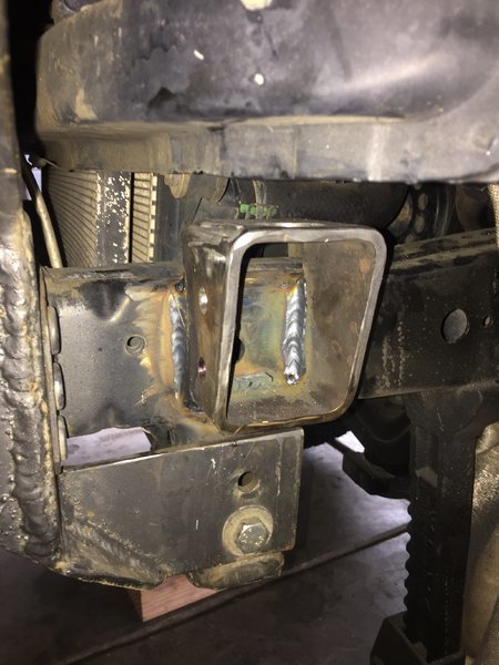

    Also finally got around to installing the Energy Suspension body mounts that I have had for a few months. The mounts on the 4R are MUCH larger than those on the taco, so it was not just a plug and play, new mounts had to be fabbed. They came out great though, and will hopefully help to tighten the feeling of the front up.

    Get some 3/4 or 7/8 heater hose split one side and slide over the resi hose and zip tie it on. Cheap and keeps them from getting rubbed through.

    Even that wouldn't fit, literally tenths of mms gap currently. I still need to do some adjusting on the ucas for the alignment and will push the upper arm out a bit to get some more room, might be able to fit some hose over it at that point.

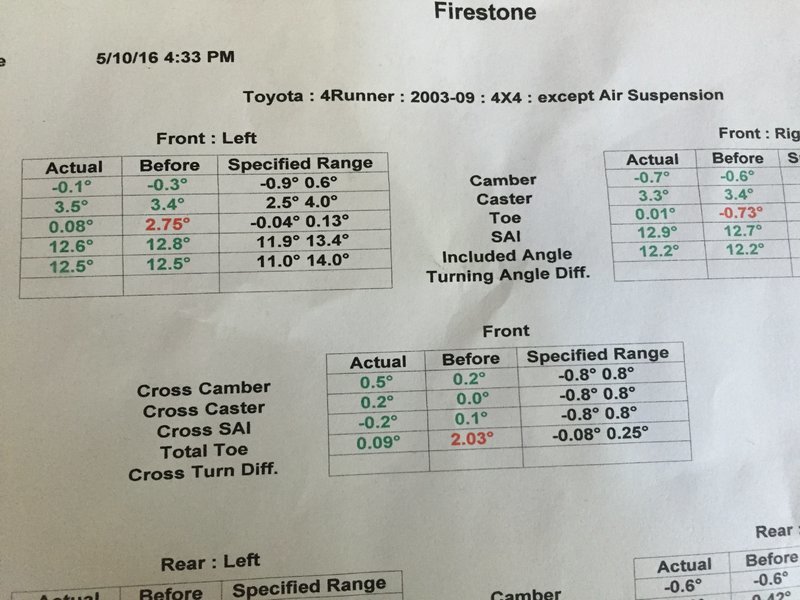

    And here are the final alignment specs, I had to flip the driver side LCA tab to the outside to decrease the caster on that side. I am done messing with it for now, my come back to it and get the camber closer to zero after Moab.

    Basically what I took from that
    Not sure why you'd mess with that alignment.

    Pretty much.
    Maybe just to pull a hair of camber out of the passenger.

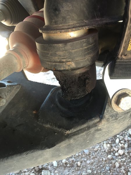

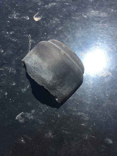

    Only carnage from Moab, a ripped limit strap and an exploded superbump.

    How da hell u explode a superbump?

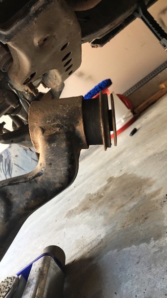

    Fixed my locker. Was a loose wire up behind the switch and my lca bushings just kinda fell out of the lca. Don't buy moog lca bushings ever

    Dunno, mobbed pretty hard all week as you know, found it when we were airing up on Sunday.
    Yeah that LCA did not sound good.

    That's how that one bushing was when I pulled it from the truck
    And both sides were really jacked up

    The vid of it is even better the bushing is wedged in and I have like .5"-1" of movement
