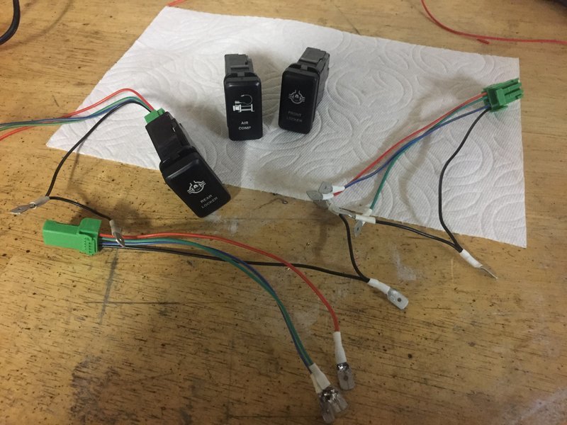

    Bought some Air On Board switches to replace the janky OTRATTW ones that I had for my lights as well as the ARB ones. I bought the compressor, and F and R locker ones first and installed those by the wheel, then ordered a set for front and rear lights. Not quite plug and play like the OTRATTW ones, I had to use the harness that comes with them and attach spades to connect to the ARB harness, but came out quite clean.

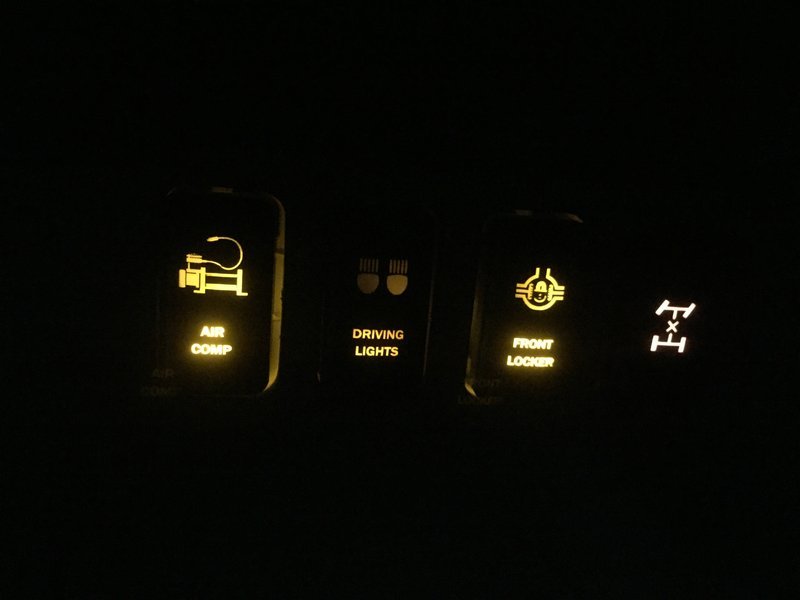

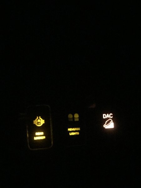

    I then put the lighting ones down by the console.
    After checking the back lighting at night I noticed that both of the lighting ones were not as bright as the comp and lockers, so I swapped the bodies to verify.
    Don't know if it is a bad batch or what, but I will be contacting AOB to see what the deal is.

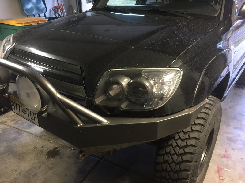

    My headlights were leaking so I ripped them apart to reseal with some Morimoto buytl that worked quite well. While they were apart removed the amber reflector and painted them the same color as the rest of my armor, came out quite well i think.

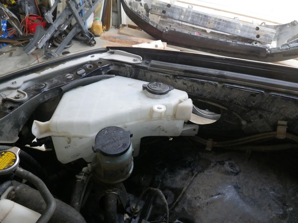

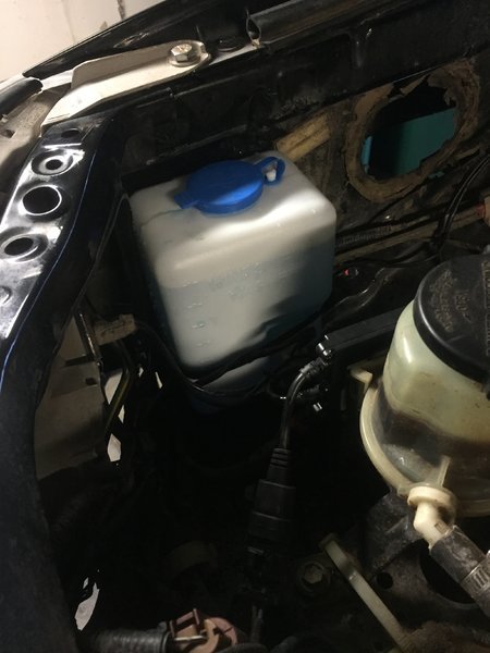

    Finally, my washer reservoir that I bastardized after moving it from the stock location started leaking, it was kind of a janky install to begin with and just wedged in between the PS reservoir and headlight, which made accessing either a PITA, so I ripped it out and installed an ebay special, using the stock pump wiring and mating it to the new one's pump, I had hoped that the stock pump would fit but the hole in the reservoir was too small. So, I now have washer fluid again, yay.
    From this:
    To this:
    Much smaller, but it fits nicely and is bolted through the fender body and secured with a big ass zip tie.
