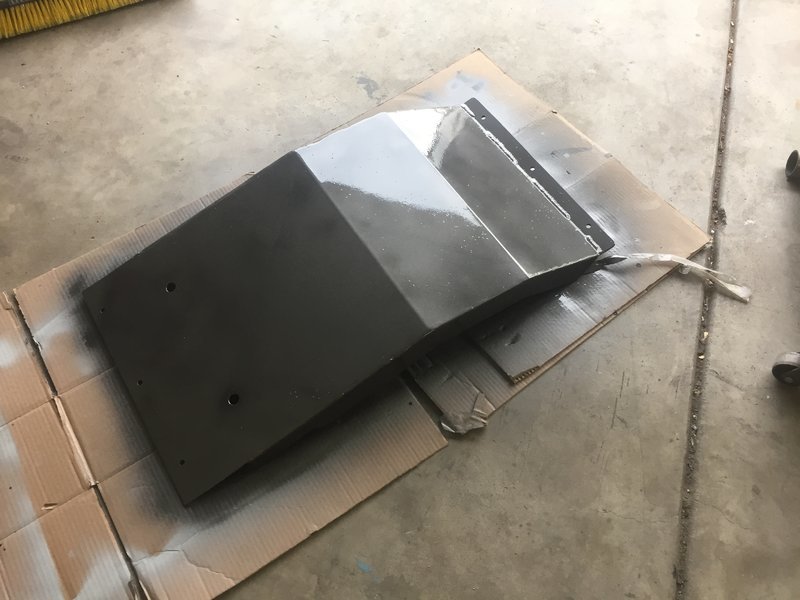

    Skid is done for now, going to add some more supports and gussets down the line. Mofo is heavy, I would guess 100 lbs.

    Enough to make it a lot of fun!
    What you didn't think your pig weighted enough to start with?

    pardon my ignorance on this but wtf for

    Nope.

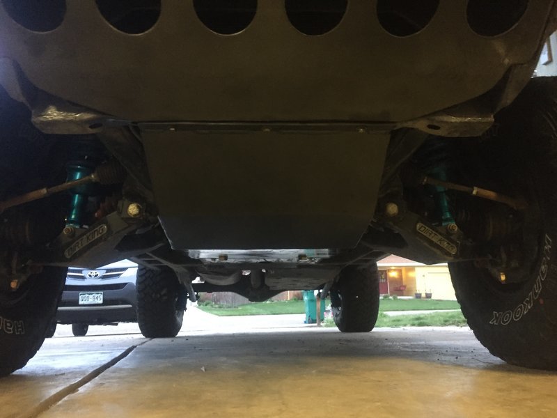

    Installed and ready for destruction.
    @NYCO I was able to rotate the lower collars with a pry bar, couldn't get them all the way around due to the spindle, but I could get them facing out towards the tire a bit so the gap is not facing forward.

    Why so heavy? b/c it is 1/4", my last one was 3/16 and bent and defromed like a little bitch.

    Just seems oddly heavy but that makes sense.
    was more along the questioning of the weight. seemed excessive.

    It is excessive, might not be quite that heavy, 1/4" is ~10 lbs/sqf, I started with a 2' x 4' and trimmed 6" off one end, so more like 75 lbs.

    it looks awesome BTW

    I had a trans skid already, just found a new way to mount it, ended up cutting 6" off it and then bolted it to the new IFS one instead of being sandwiched between the IFS skid and crossmember.
    I also used a drastically different way to mount the IFS skid at the rear, I was tired of small, shitty hardware that was getting torn up, so used (2) 3/4" holes that were already in the crossmember and bolted it through that. They do sit down a bit more than the previous hardware, but robustness will not be a concern.
