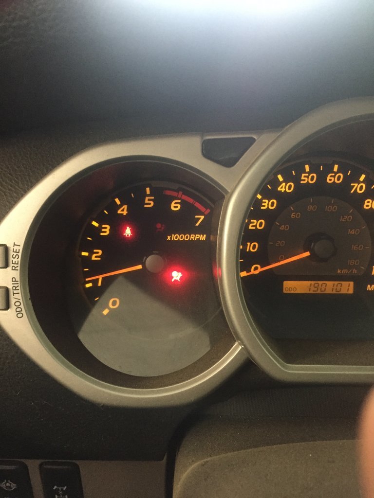

    So, while doing this:
    I did this:
    Which lead to this:
    Need to find a place with a SRS code reader and see wtf is going on.

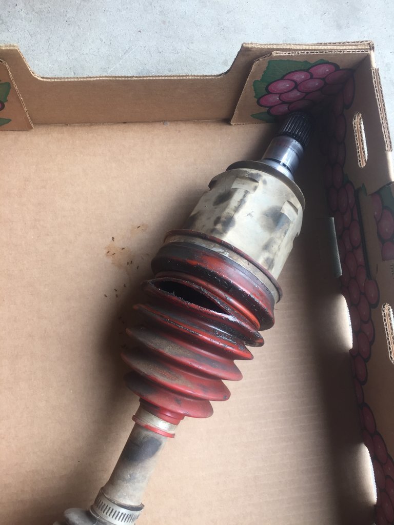

    Unrelated, tore another CVJ boot, no tears marks or hitting anything, seems to have just given up the ghost. This is just 2 weeks after replacing the other side. I eleceted to jsut get a whole new CV since this one has 4 or 5 years on it. The other side I had CVJ just replace the boots, kinda wish I had gone for the full CV on that side too, oh well.

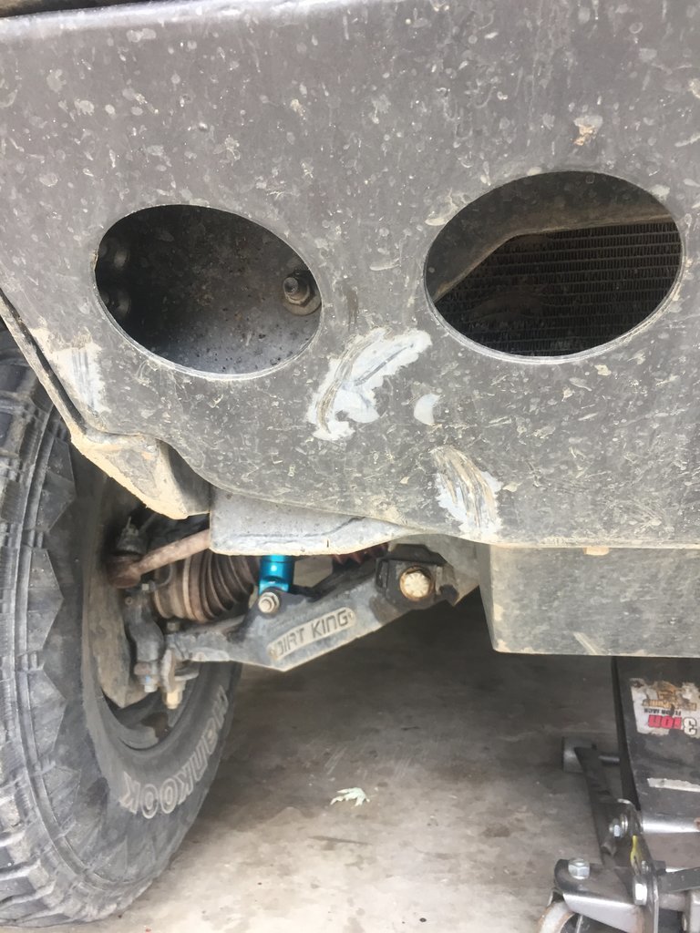

    Yeah, not sure what is going on, looked at both the sensors on the radiator core and they look to be fine based on looks, not sure if they have a shock sensor or some intermediate fault before deploying the bags. I did smack the rock pretty hard, but no more so than other times without any airbag issues.

    i think they're impact sensors so if you hit it hard enough it'd fault.

    Impact registered in occupant detection. It now requires a re-calibration.

    ^^^^ This, how do I fix this Brian?

    I don't think there is a way do do it without a Techstream or Techstream Lite. I have not purchased a techstream light so for me it is dealer only work. I have not seen a way to calibrate it without yet.
