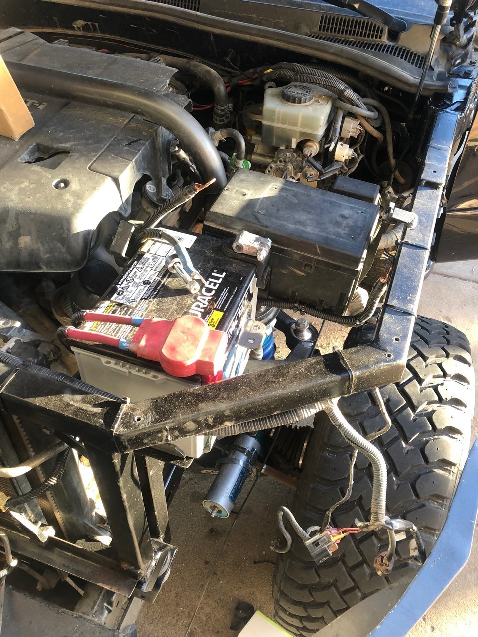

    Yeah, I took that into account for sure, the power switch in series, as well as the power switch keyed. Dogs aren’t in the front while driving (or course I’ve sent them flying), I feel pretty confident it’ll be ok.

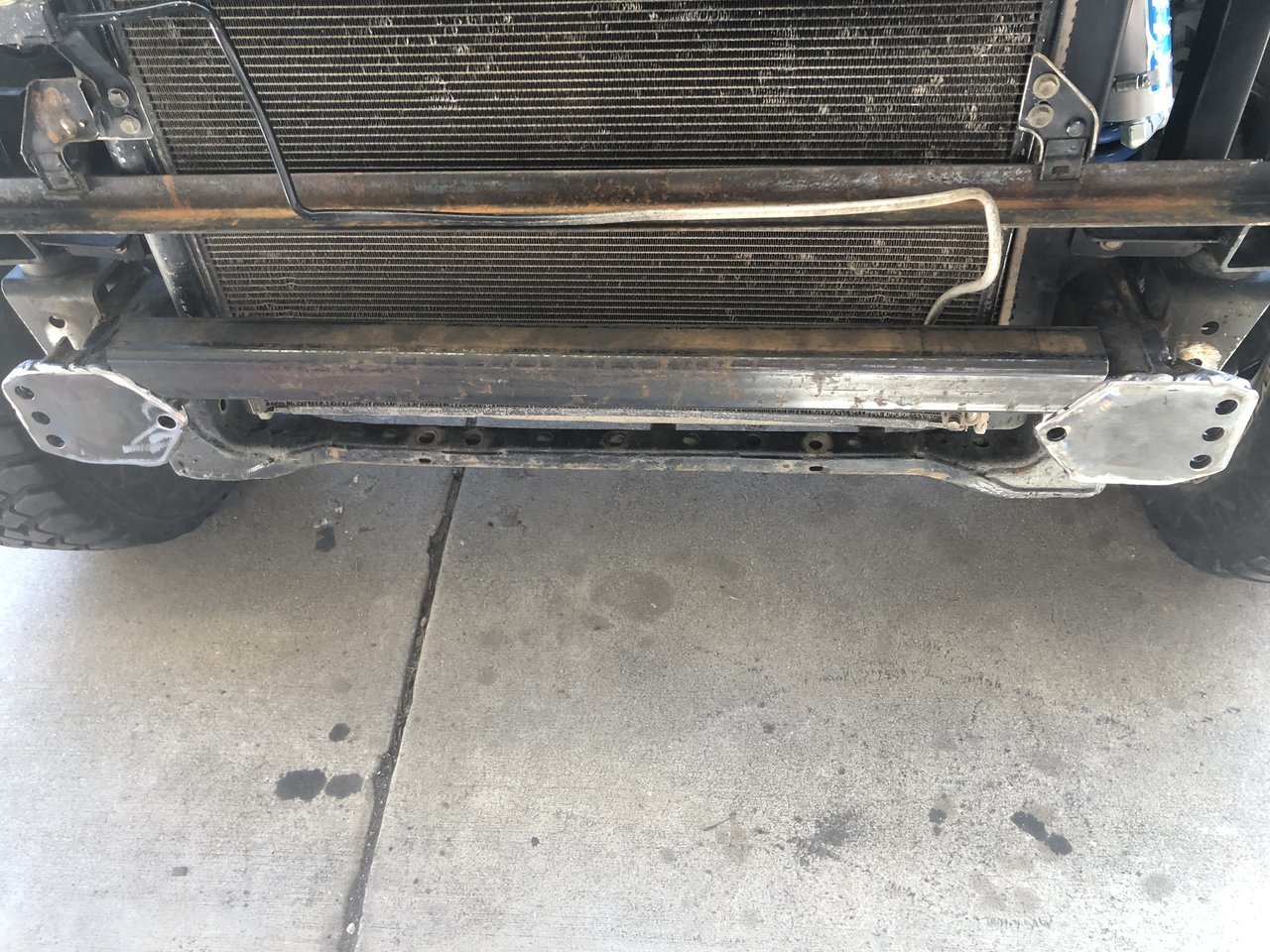

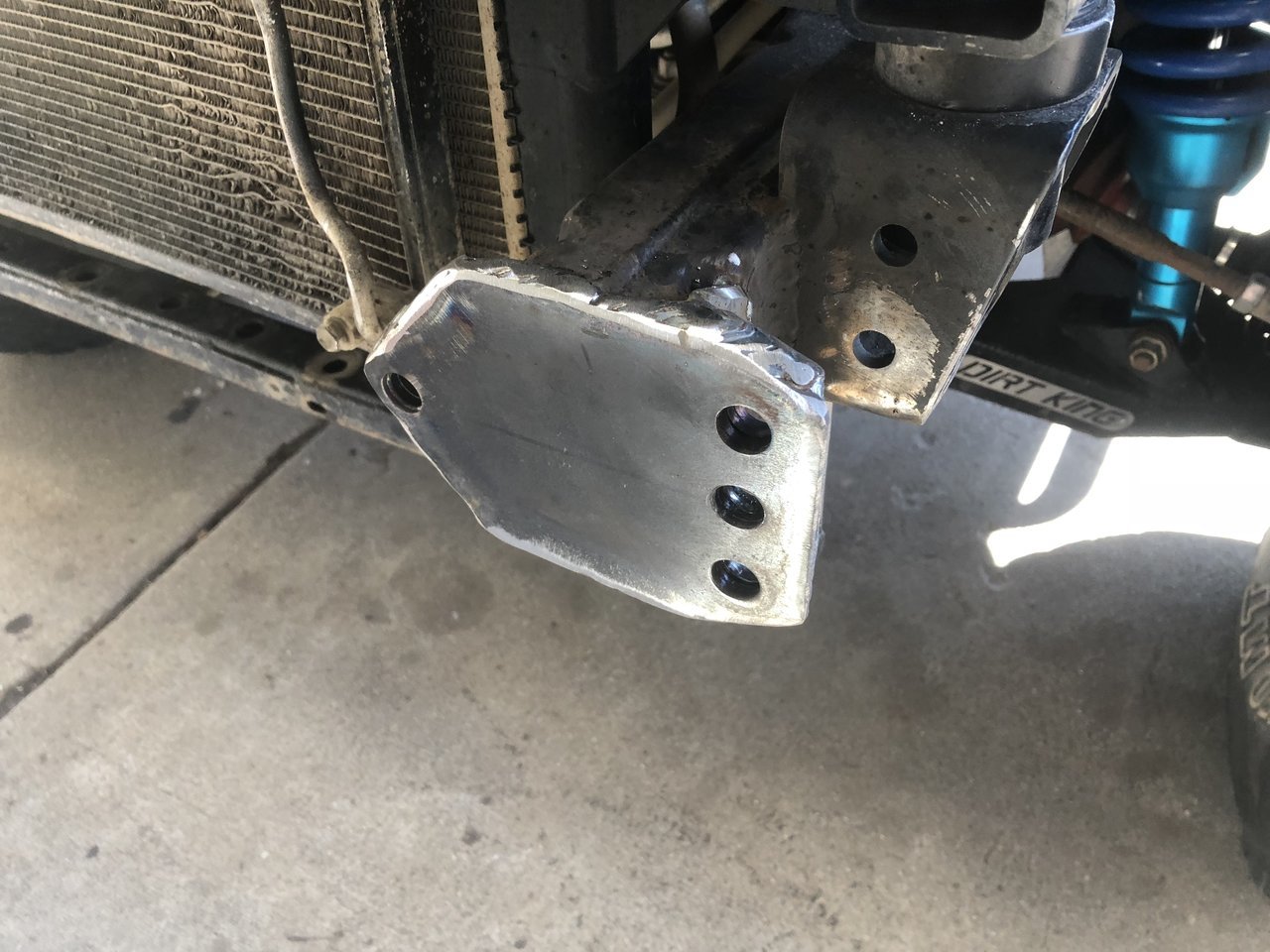

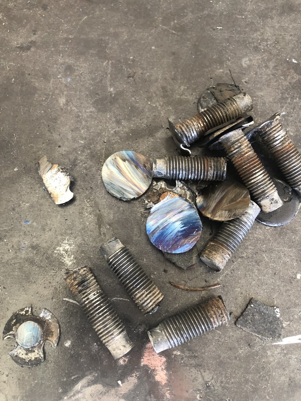

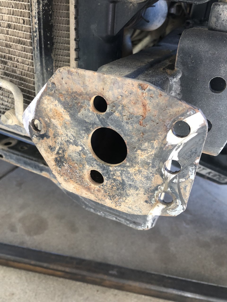

    Got the winch mounted this weekend, finally, and did some significant reinforcements in the process. First step was to cutoff the old studs and drill them out to 1/2”.

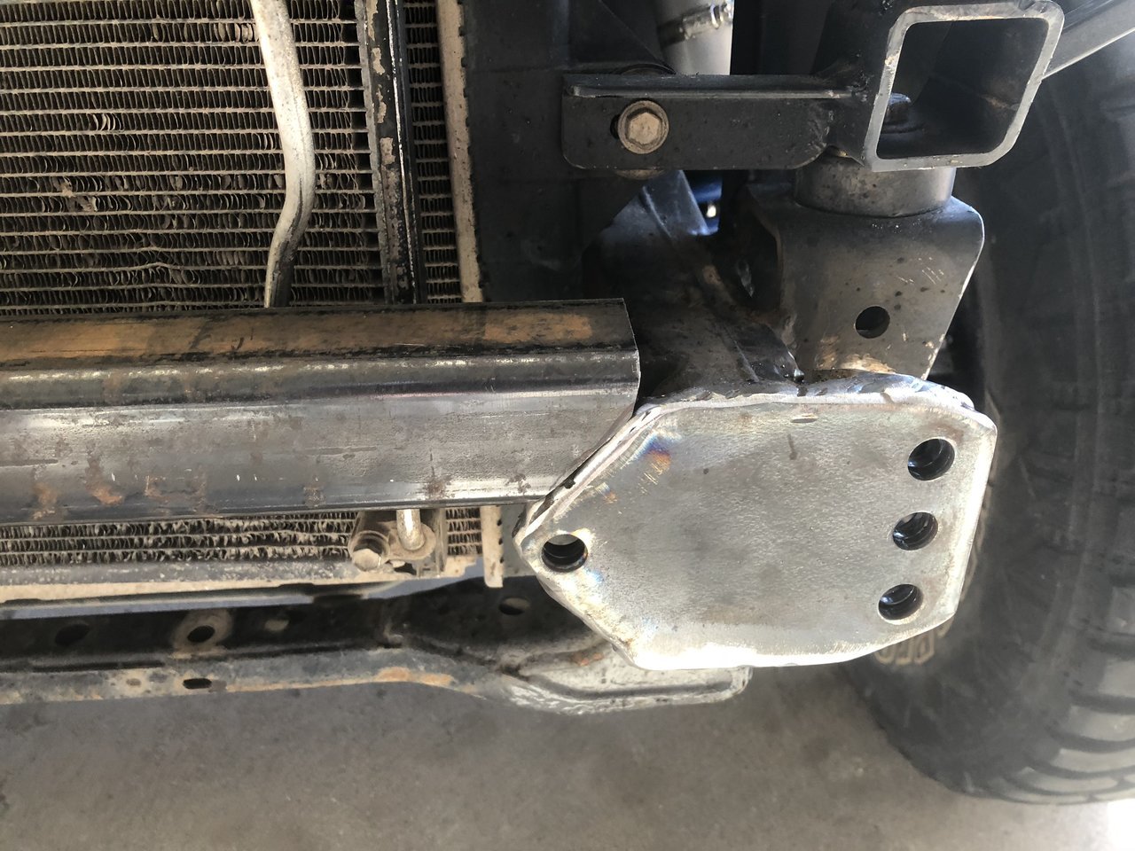

    Next, I cut a plate of 1/4” to go over the front, and 2” x 3/16” angle to go on the back.
    Then melted the sandwich together, now over a half inch of beef added to the ~1/8” stock plate.

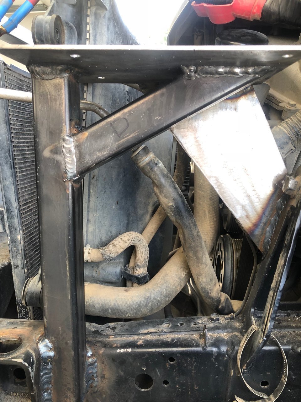

    Next was a 2” x 1/4” square tube between the frame.
    Burned in and painted.

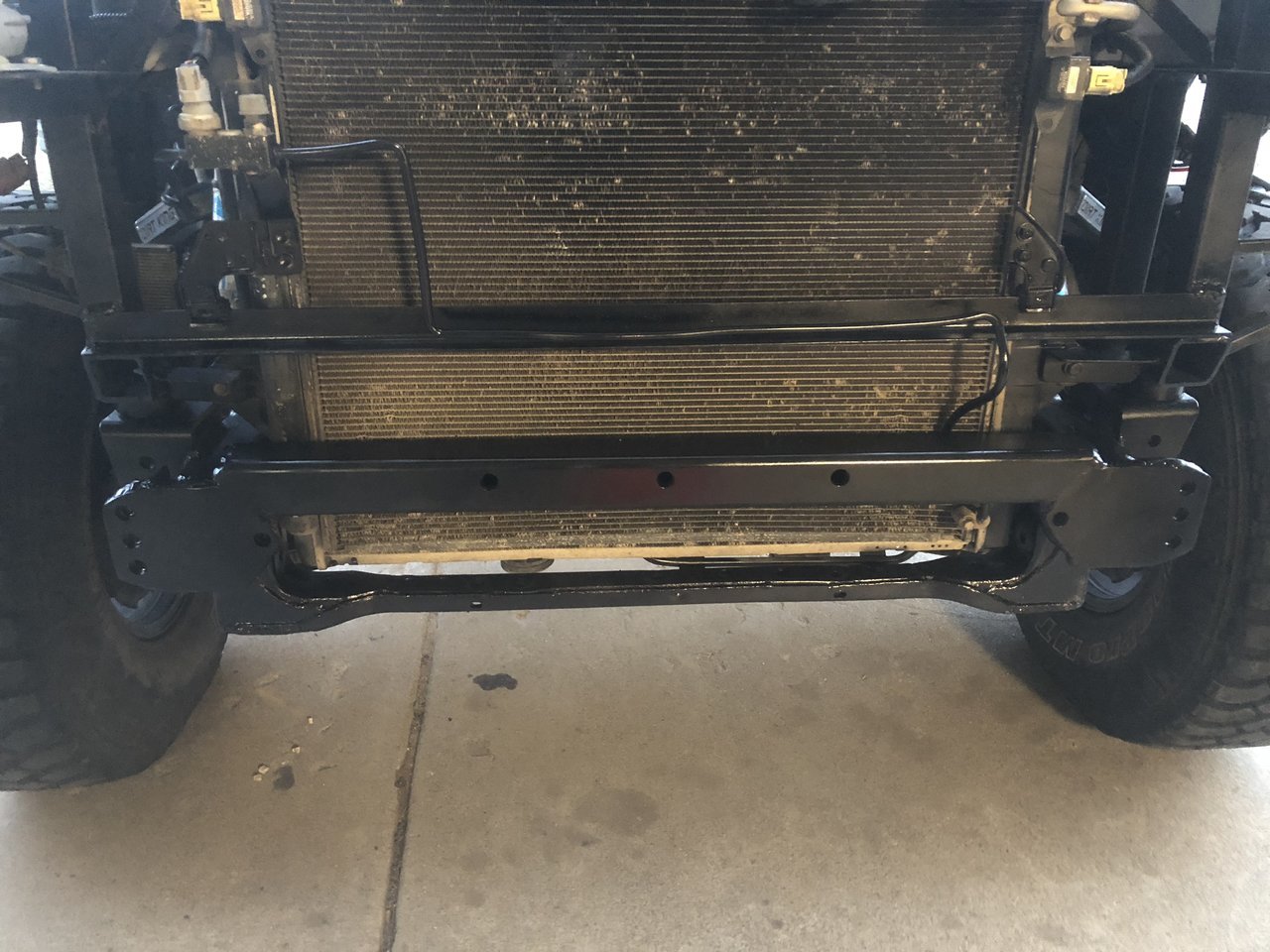

    All together, now 11 bolts from the front, and the two on the side, may add some brackets that tie into body mounts at some point. Not all the bolts are in on the below pic, need some that are 1/2” shorter

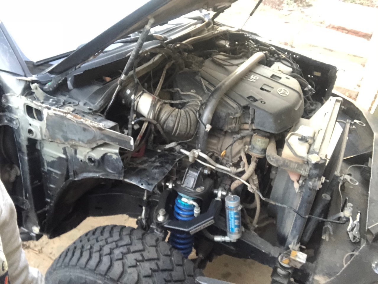

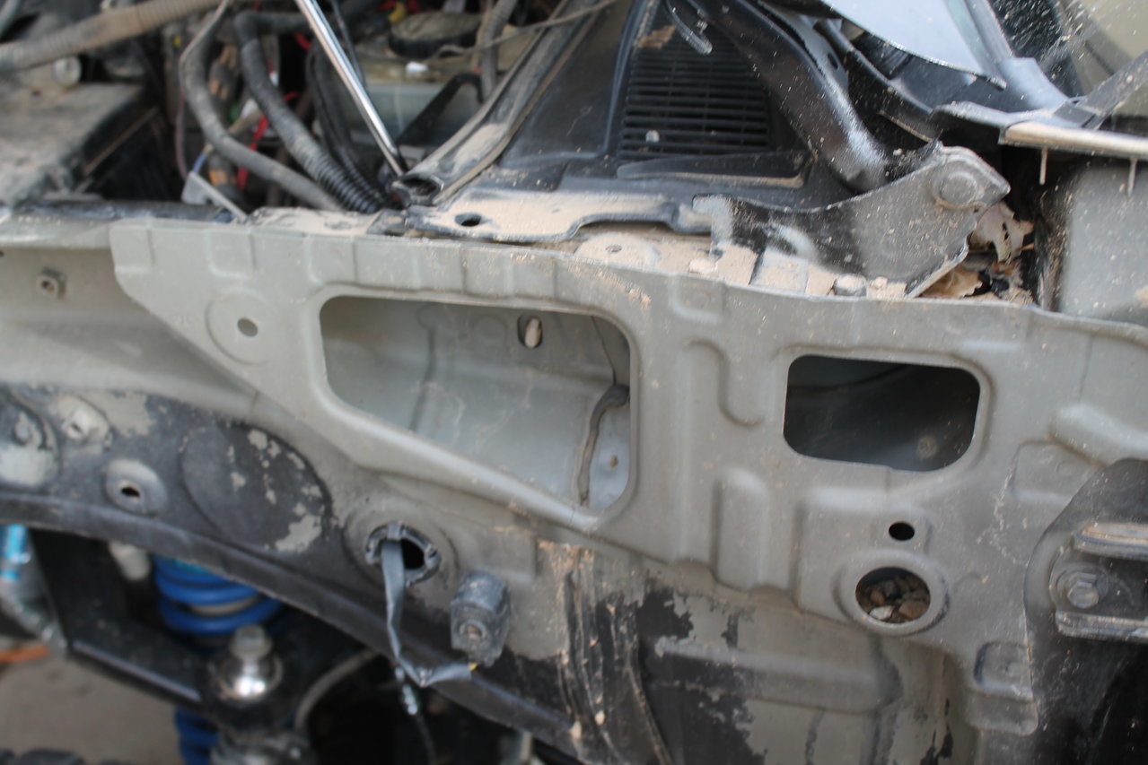

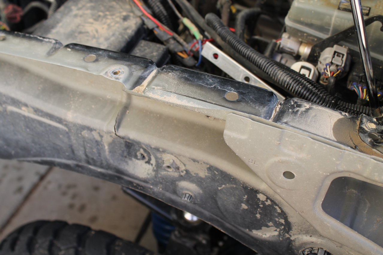

    04 SR5 4Runner
    King/Dirt King

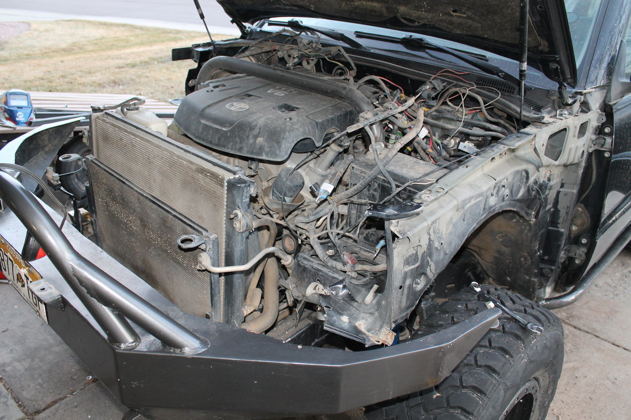

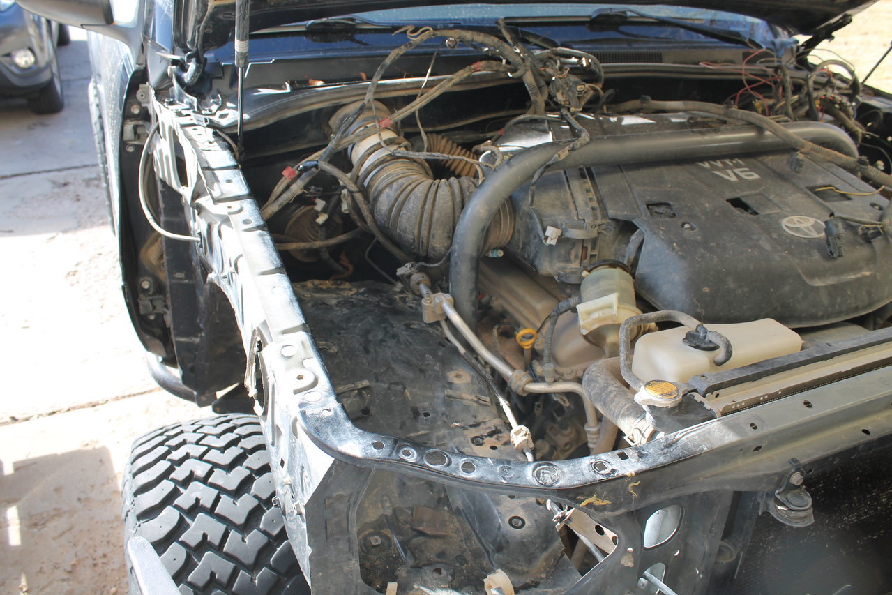

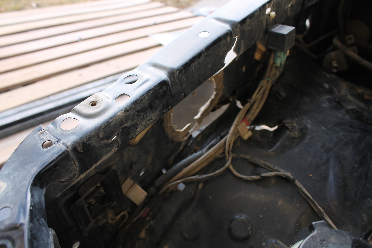

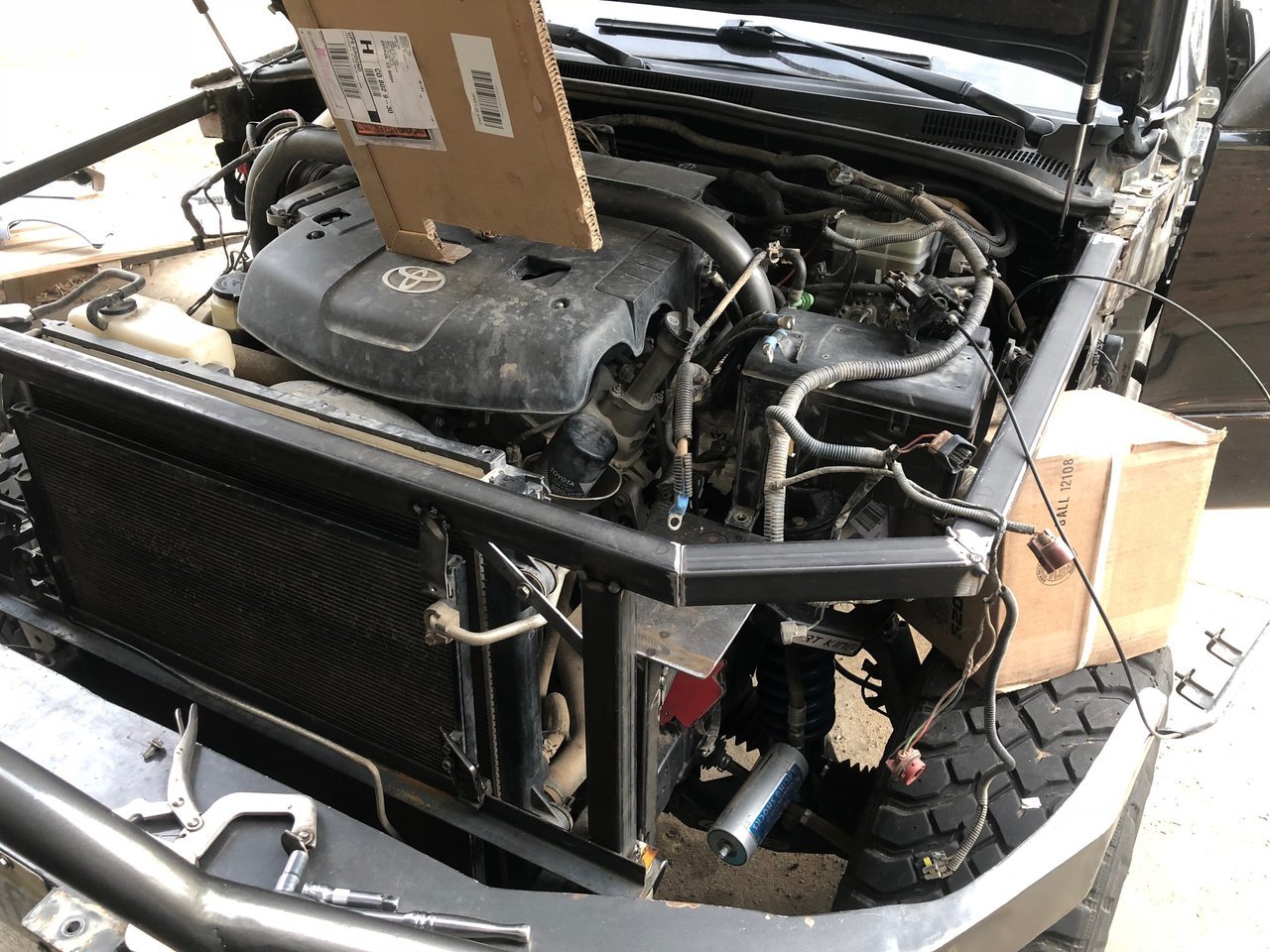

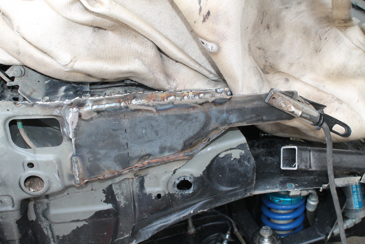

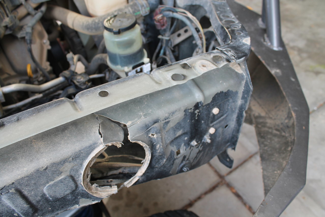

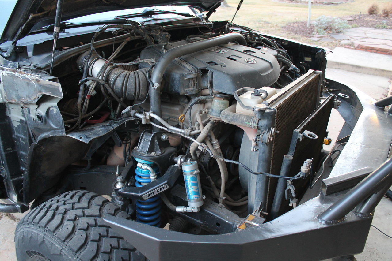

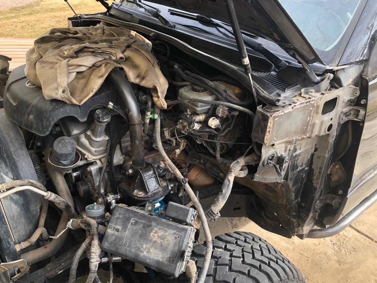

    Look at the pics of the before, cracks everywhere, the whole thing was blowing up. I think eventually, if totally ignored, the battery would fall out as well as the headlights, the driver side was only connected to the body with one mount as the rest were basically free floating.
    I am also going to put in new inner fender liner which would have been a waste if shit just kept deteriooating. I had also already cut a good portion of the sheet metal out for tire clearance, the crossover, and shit that was cracked and ready to fall off.
    Only the once, I’ll leave that for you :burnrubber:
    Really it’s more just lots of high speed miles off-road vibrating and cracking everything apart.

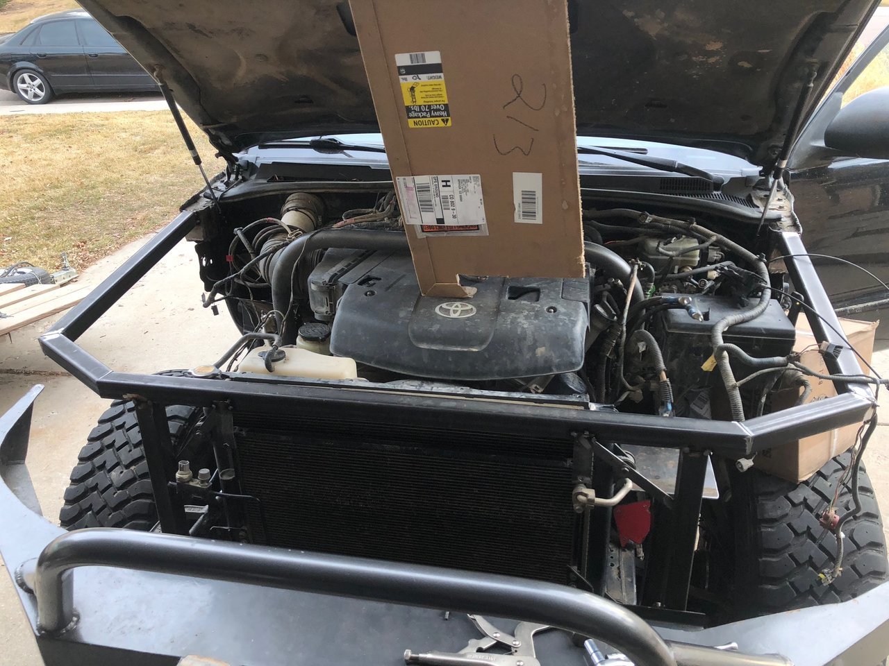

    I’ve got a 4’x8’ sheet of 1/8” black ABS plastic, I wanted to do UHMW but a sheet was close to $200, the ABS was $50. If the ABS doesn’t work out I’ll pony up, but I think it will be fine.

    You got to realize there is absolutely nothing between the tire and the battery, ABS, fuse box etc., on mine now, even chopped inner fenders have a shit ton of coverage relatively. I fucked my ABS up for a week getting water into something from just one drive up to the mountains, lit up all the lights and disabled everything, not going to drive it in the snow again til I get these in. Dust is definitely easier to deal with, but I think I would still want something in between the elements and the electronics.
