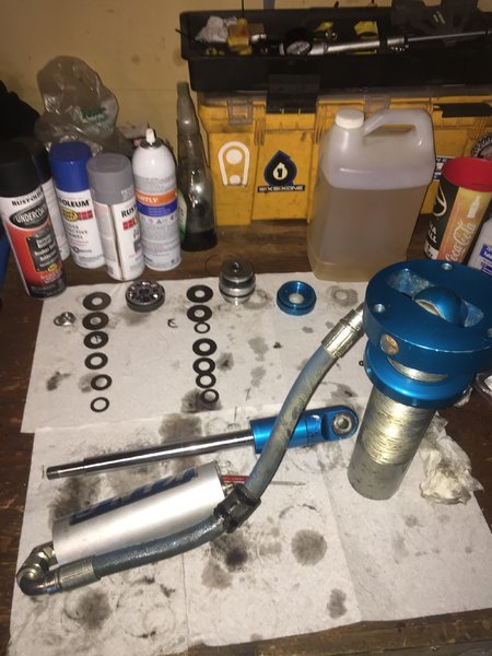

    So, this bullshit happened again, the bumper is grenaded and there are flecks of metal everywhere, and some nice gouging in the shaft, FML.

    IDK, that’s the top out spacer, and as seen in the post I quoted they are different on each side. Going to see if I can get one of the other ones.

    I also shouldn’t be hitting these with straps, which also can’t seem to stop breaking, so again, IDK.

    Have you checked with the LT guys to see if they ever had something like that happen. 99 percent of them run kings. Or maybe call downshouth and see what they have to say.

    Yeah, I got the last replacement from DSM, they basically said strap it to keep it from topping out.

    :boom:Why that's happening. Sorry, I can't be any more helpful.

    Yeah, you can certainly break anything. You also won’t notice or find this until you rip the shocks apart.
    Also, even the other side’s oil was trashed, rebuilt almost exactly a year ago, so they have taken a beating over the past year. Maybe I need to stop playing prerunner so hard:burnrubber:

    Want the oil to last longer? Spend triple per qt for high VI shock oil, text for recommendations.

    Damn man. Going to have to tighten the straps at droop. They're obviously stretching and allowing it to top out.
