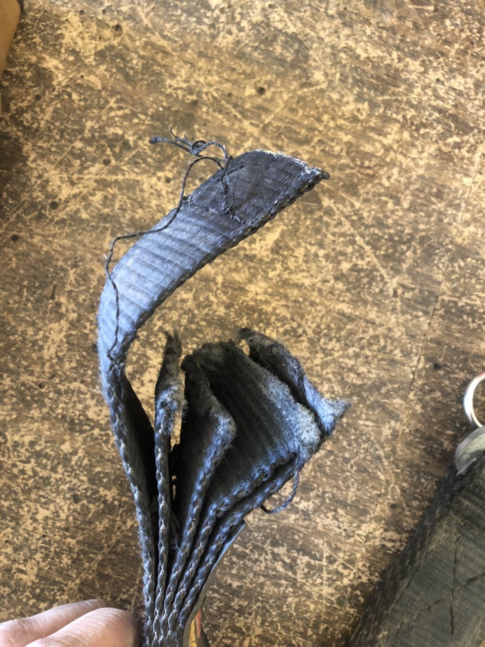

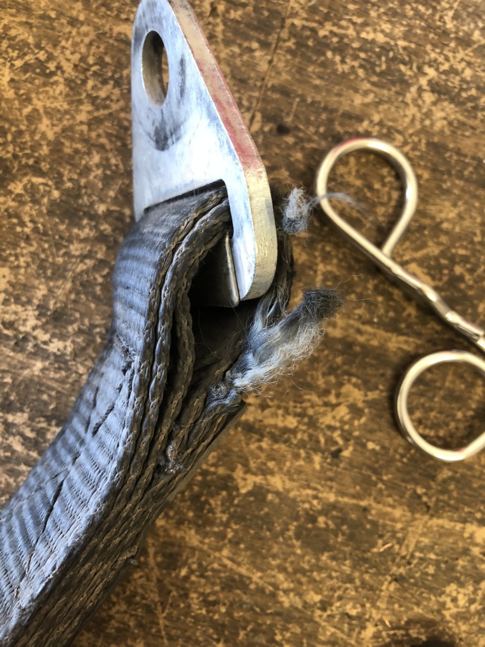

    Yeah, I’ve gone through like 6 pairs, we put ours on about the same time too lol. 650’s and yeah just measured, 1/2”.
    Five days of use, in the last pic you can see the edge of the load distributor folding up.

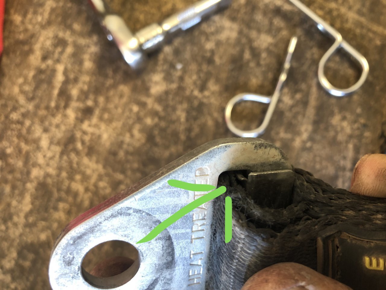

    What if it's your buckles that are cutting it. Look at how sharp that piece is sticking up.

    That might be another symptom of hammering on them a lot, though the sharp edge isn't helping anything and might accelerate the damage

    Exactly. That didn't happen to this set, was probably starting to, but the other sets that has definitely been the problem.

    Pretty much. Looking side by side at the TG and Kartek shows the Karteks are sewn much tighter to the buckle, which should reduce the amount the strap can move around on the buckle. The load distributor on the Karteks look to be a better metal that is less likely to shear like that. At least I hope :fingerscrossed:
