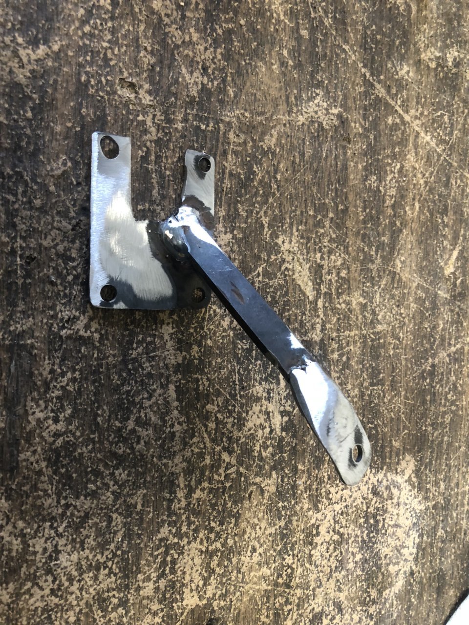

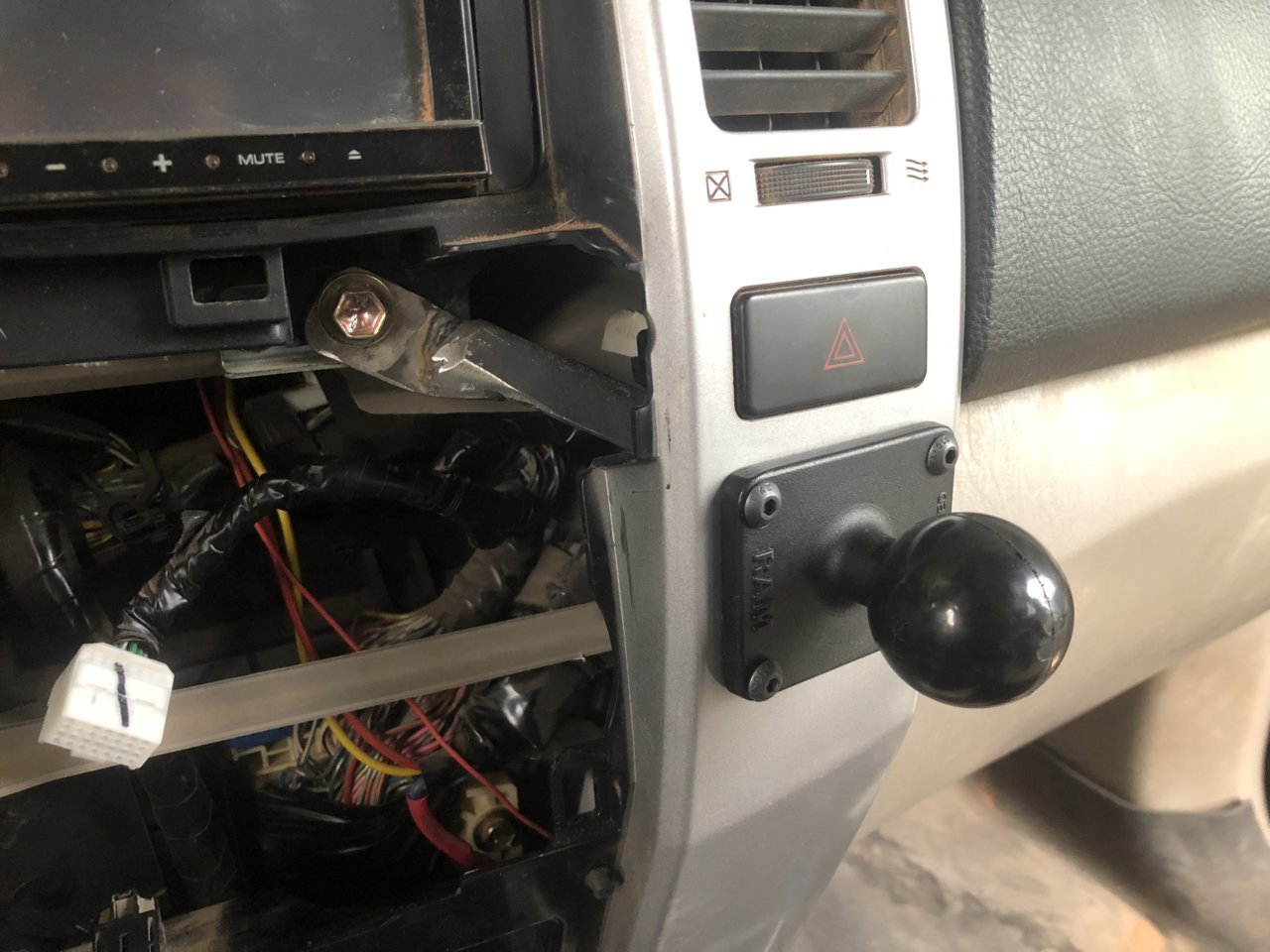

    Few updates I have been working on for the past few months.
    Finished the core support replacement and redid my wiring situation by adding a Bussmann RTMR to a panel I whipped up.
    Trimmed the fenders then made some fender liners out of 1/8" ABS, it was a bit too thick and required heat in a few places to make it stay, but came out well and is bombproof. I have some fender trim that I still need to apply. I attached it on the outer edge to the inner metal fender tabs that were bent over, then ran a piece of round 1/4" stock on the inside bolted to the last bits of body fender, and welded to the front radiator support, then ziptied the liner to it.

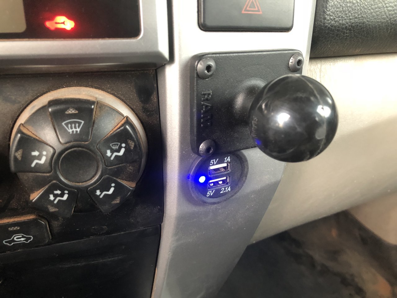

    I have been using Gaia for the past few months on the phone and have been loving it so added a tablet mount and an extra outlet to charge, Samsung Tab E 9.6 should be here tomorrow. I made a bracket that bolts to the radio support and added some much needed rigidity to this piece of trim.

    Bracket pics are there :confused:

    Correct. It is very rigid up/down and to the right (passenger). Left is a bit less rigid due to where the bracket is. Going to test it out next week and see if it needs any more help, I have a few ideas for further securing that piece of trim if needed.

    It seems to be a great spot, but definitely needs some reinforcement for a heavier device, I went with the C ball.
