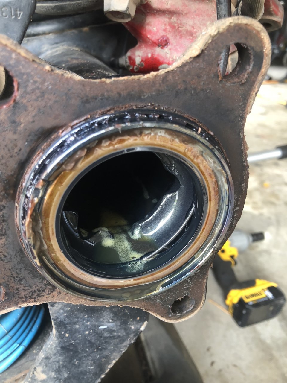

    Just finished a 3000 mile and probably around 7-800 miles of dirt extravaganza around the Grand Canyon and into the Flagstaff/Sedona area.
    But before that, I was all packed up and ready to roll out in a few hours, and I when I was topping off the tires I see a puddle of gear oil in the wheel :annoyed:. I assumed the worst, figuring the seal was shot and had destroyed the bearing and I might not be making the trip, fuck. Headed to the dealer right away and grabbed the seal and was going to get the bearing too just in case (a $600 part at the dealer btw), but ran into my favorite Toyota whisperer @lotsoftoys and he convinced me to just do the seal for now and make the trip. Got home and ripped the thing apart to find this, the seal had shredded and the spring popping out.
    Did some measuring to find the seal depth and found that the seal was in crooked and the side that ripped was further in, impressed that it made it that long. Per Jace's instructions I put the new one in not quite as far so the seal would sit on a different section on the axle that wasn't worn, and didn't loose another drop for the rest of the trip, success. I will probably leave it as is until it starts leaking again or making noise instead of swapping the bearing as I had originally intended, the bearing felt quite smooth and only a tiny amount of play. I dp plan to have a seal on hand in the truck though in case this one goes out or the other side does. Once I had the parts the job only took an hour or so, most of that was messing with the parking brake assembly and putting new pads in as they were doused in oil.

    Do you have 200k miles on the factory wheel bearing?

    We're talking about rear wheel bearings.
    My stock ones made it about 260k IIRC.

    Ahh, makes more since now. I see it in the picture now

    What do you typically see for life span on 4th gen 4R/2nd gen tacos?

    Usually life ends around the same time seal failure occurs. Depends on how much grease was washed out by the gear oil.
    I'm going to likely do the fronts soon, just because.

    Right on James! Good work too doing it right so it lasted the trip!
