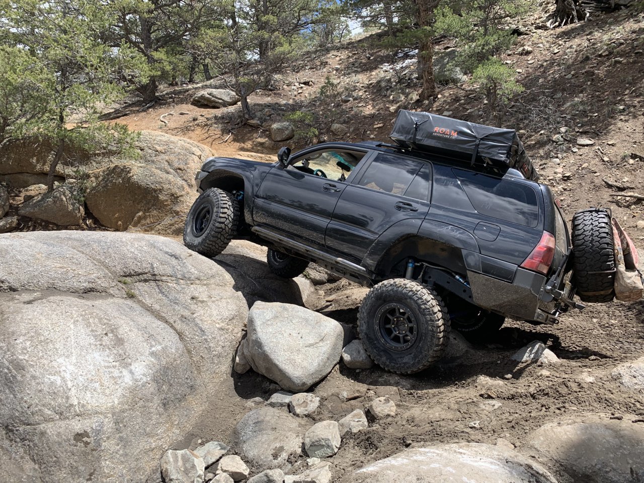

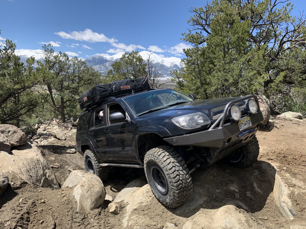

    315 STT Pros are on, pretty stoked on them.
    Pros:
    • Much better traction off-road than any tire I’ve been on so far
    • Additional clearance also quite noticeable over the 295 Hankooks I’ve been running for the past 5 years.
    • Look badass
    Cons:
    • More rubbing. I preemptively sledged the firewall and chopped the body mount back, still need to do a bit more but all in all not bad. Rub the frame, UCA and limit strap clevis at lock, going to swap my .75” spacers for 1.25 and throw the .75s on the rear. Rear only barely rubbed the body at full stuff, spacers should remedy this.
    • Biggest negative, truck is slow as fuck again, even with 4.88 gears. Can’t hammer through washes in 2nd like I used to, maintaining speed on slight hills, head wind etc. has constant down shifting. Sucks. 5.29s are not going to happen (soon), maybe with a new axle build down the road.
    • Sling mud all over, blasted myself several times with the window down.
    Broke them in on Chinaman this weekend, love that trail. Ran it solo, pretty quick without a group, got stuck behind some Jeeps for a bit but other than that not too busy. Got the rear diff stuck on a rock the waterfall and had to winch, other than that had a blast.
    Then camped up at a spot @Squeaky Penguin and I had 4 years earlier, first time camping with the little guy and he did great.
    Sunday morning cruised around the 4 Mile area in the mud to see if I could get the tires to rub at speed, no such luck, which I was stoked on. Took a pic in almost the same spot 5 years earlier.
