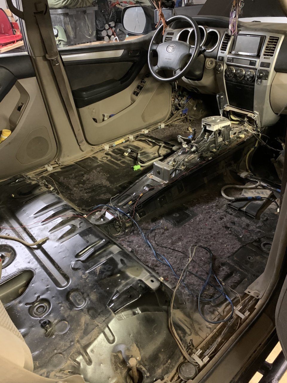

    Operation turtle race has commenced, Atlas build starts this week and should be here by middle of Jan. Got the interior ripped out and ready to cut some holes in it.

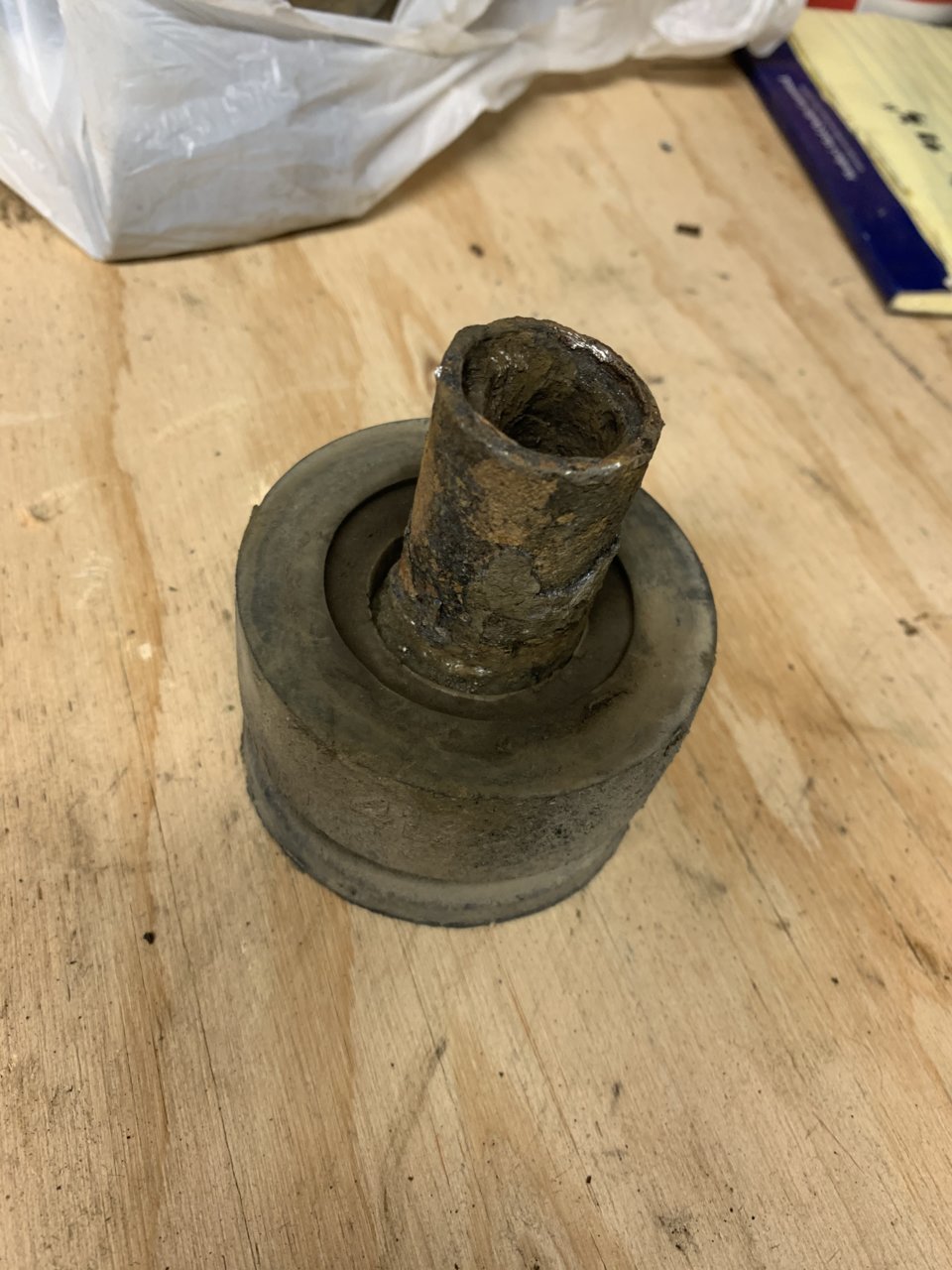

    On top of the Atlas, banging out a bunch of other crap that kind of ties in to it, other stuff that just needs to get done. First on the list is body mounts so I know exactly how much room I have to clock the Atlas. Started looking for poly mounts that would fit the body mounts, but the holes are too big for any existing poly bushings. I also found this nice hole in the front cab mount.
    So, I’ll be chopping all the mounts off and using square tube like I did on the radiator, along with Energy Suspension poly bushings.

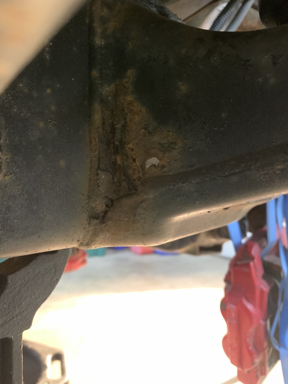

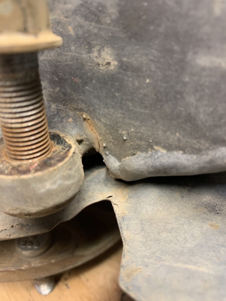

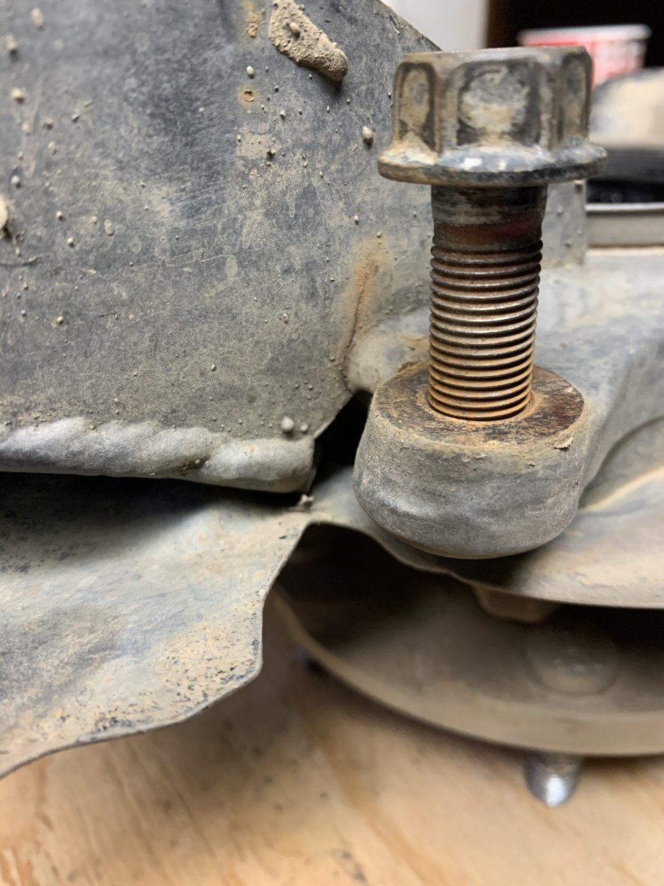

    Also on the table is a front end rebuild, going to melt in the Lca mount gussets I’ve had forever, and replace the lca bushings. During tear down found cracks in both spindle gussets, going to grind em down and patch them up.
