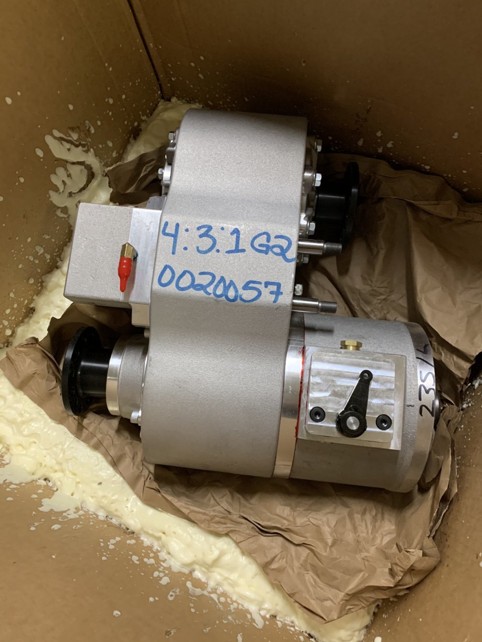

    Also the Atlas shipped on Friday so will be getting into that next weekend.

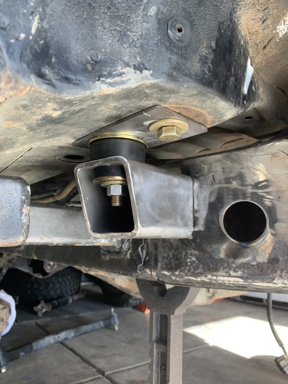

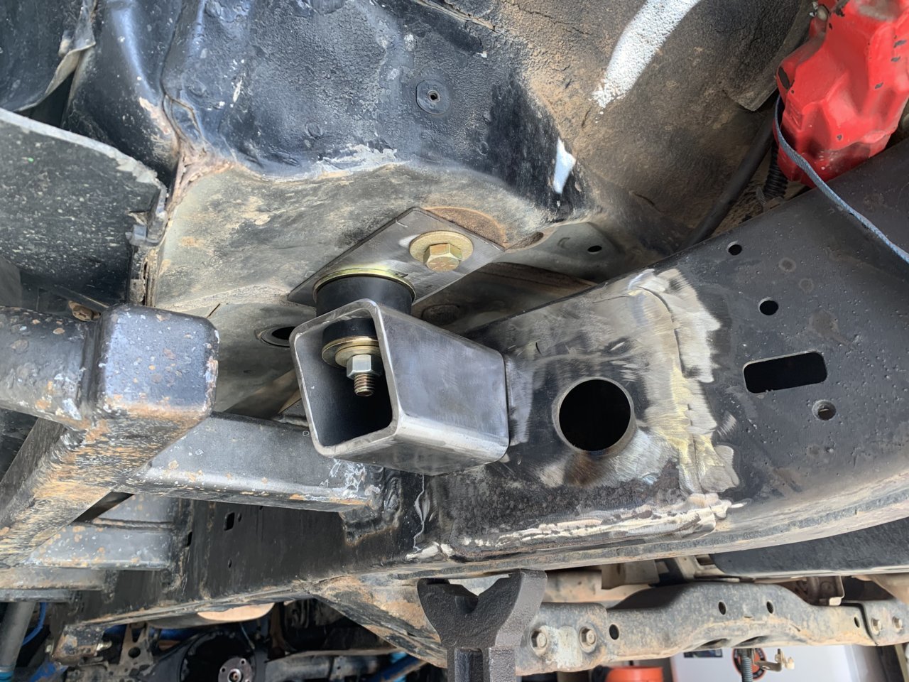

    Were the old mounts where the new bolt head is?
    I know you said you were finished.... but you might give some thought to welding those on.
    And nice red caliper, ricer :D

    Yep, moved them back ~3" for future bigger tire ambition.
    I knew I missed something! Don't worry, there are wood blocks holding things up as backup, they shouldn't go anywhere. The rest is just for show.
    Vroom!
    tetten and teamhypoxia[QUOTED] like this.

    2nd time in less than a week I've seen someone do the exact thing I was thinking about doing but hadn't seen anyone do before.
    Looking at the body mount relocations available I've been wondering why you can just weld some rectangular tubing to the frame and make a mount off that.
    Anything on your design you didn't like or would change?

    A U shaped piece would be easier to weld, on my truck with the sliders welded on, the middle body mount was hard to get the nozzle to the inside of the tube. I think it will be structurally fine with just the outside welded though. Could also cut the angle greater between the upper and lower, I used 3" x 1/4" wall square tube and cut the lower part 1" difference from the upper. I used this same approach on the radiator support 2 years ago and it has been working out great since then.

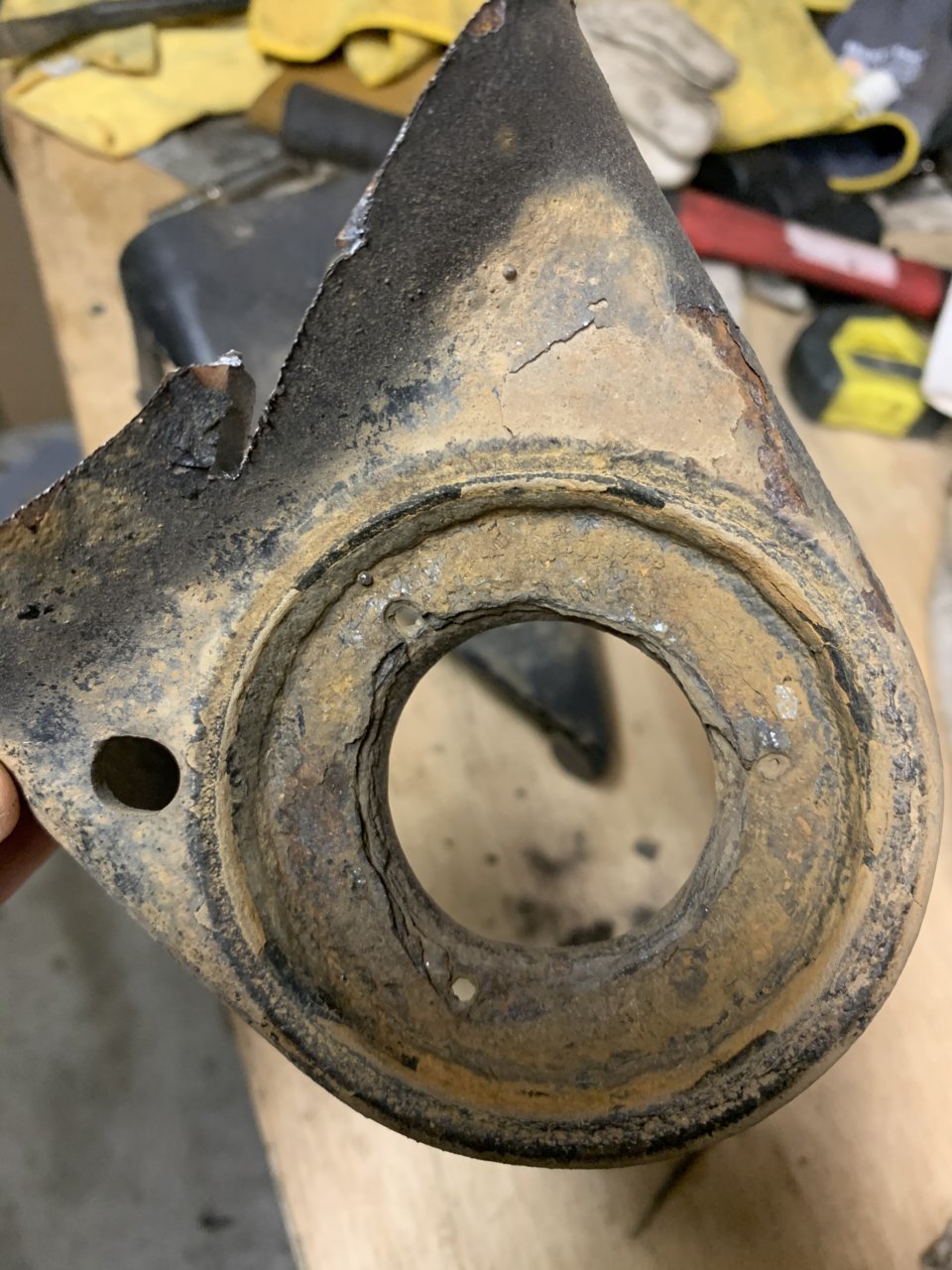

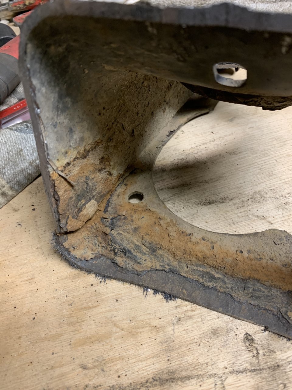

    it’s not just the front cab one, all of them where the bushing sits were corroded as hell, no way to ensure they are getting cleaned in between where the bushing and frame mount meet. I’ll take a pic of the ones I cut off tonight.

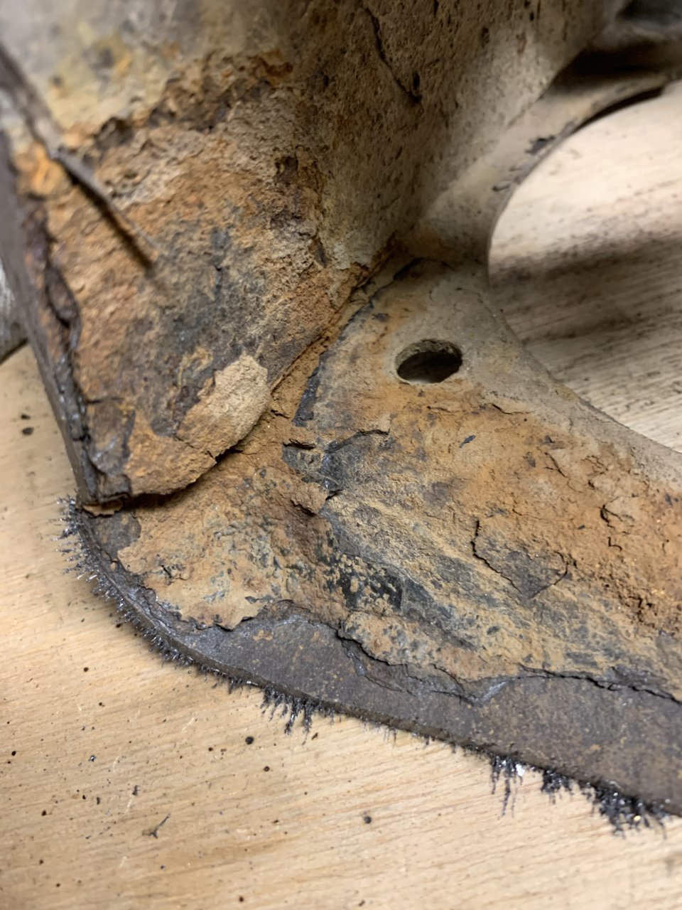

    Shitty. First pic is what the top of every single one looked like. Second is the front cab mount, where it met the frame looked like this too and was flaking chunks.
    w.adventures[QUOTED] likes this.

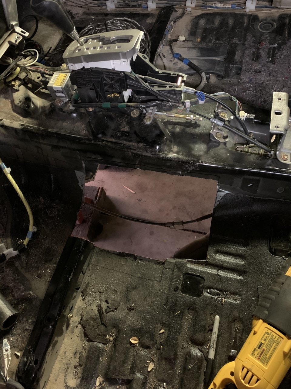

  19. Jan 26, 2020 at 7:45 PM
    #1279
    Wishbone Runner
    Wishbone Runner [OP] Because 4R
    Sep 9, 2012
    #86546
    6,345
    James
    CO
    04 SR5 4Runner
    King/Dirt King
    Going to need to trim some more off the front for the driveshaft and shift rail, but broke my saw all blade.
    Driver seat will fit back in just fine, just need a front passenger mount.
