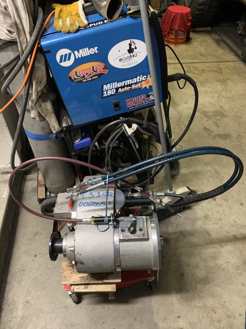

    Shout out to @Littles for loaning me the trans jack, this would have been impossible otherwise. Also wanted to mention that front driveshaft will bolt right up, no change in length from stock case. Rear will need to be ~3” shortened.

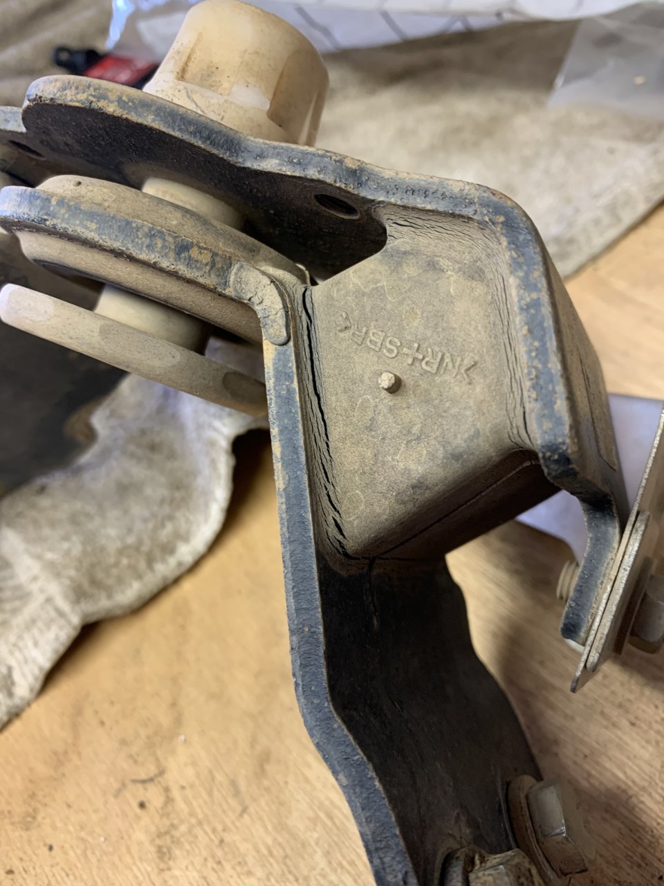

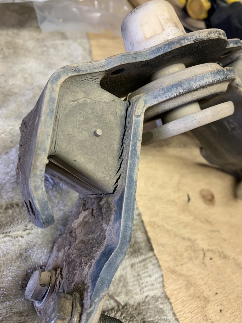

    Yeah, rubber mounts.
    Have you driven around with the poly mounts yet to see how much vibration they transfer to the chassis?

    No, truck hasn’t moved. I started it though and it felt fine at idle, we’ll see. Here’s what my tranny mount looks like, it’s basically separated, might be worth taking a look at yours.

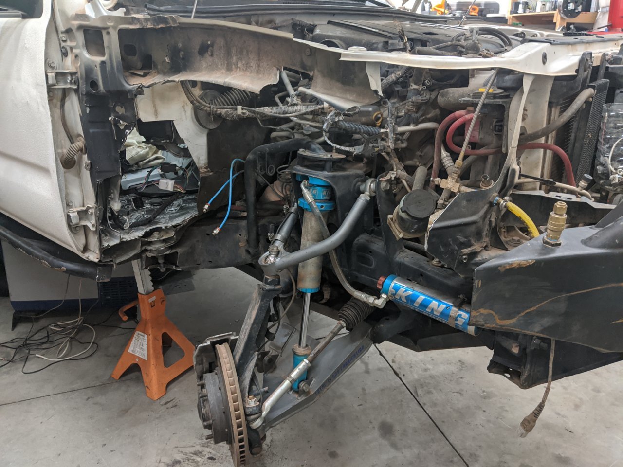

    If I had a crap load of time I would probably rip everything out and replace everything with an engine cage and the radiator support, but I'm hoping to get everything done in a month. Also in a couple years when I SAS it I don't want a elaborate cage in there getting in the way of the SAS so whatever I'm going to mount the engine bay extras on is gonna be cheap and easy to chop out, probably going to make some tube coming off the frame to hold everything, it'll probably end up looking like a shitty half assed and undersized engine cage in there.
    Didn't take many photos, just videos for IG. I've got everything but the fender support area removed and clearanced

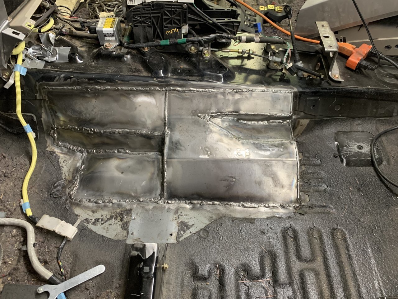

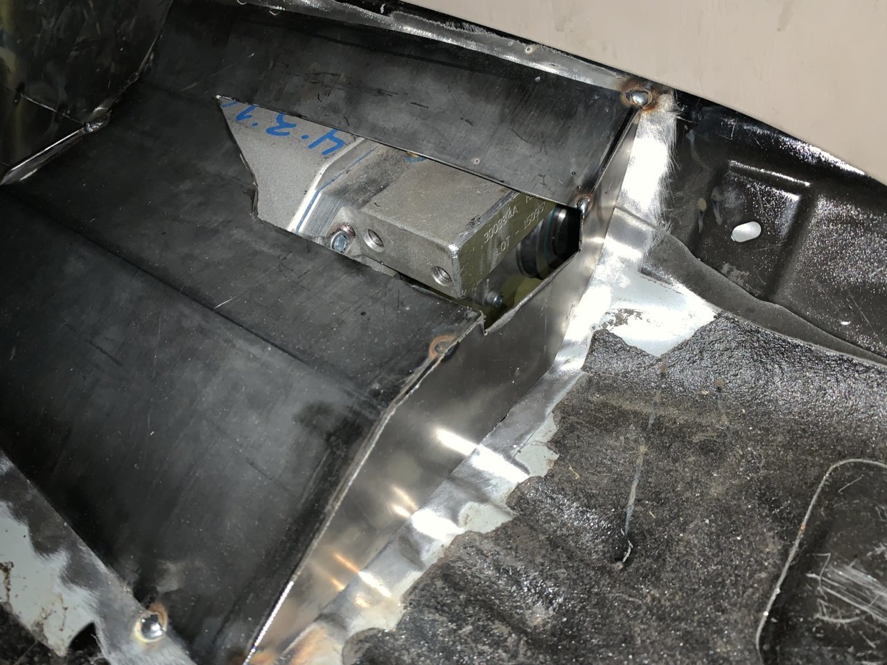

    Been working away at getting this case setup, very slow process with lots of staring and contemplating mounting options. This weekend I got the interior body work almost all tacked up, working around the seat rail was a pain and required me to drop the clocking of the case one notch, but it still sits above the frame rails. the last pieces will be filled from the bottom to make sure it clears the rails. In retrospect, I cut way too big of a hole with the case now clocked down a bit, but it went back together well.

    Inside is melted together, I will be sealing it from the bottom using a seam sealer. Damn I hate welding sheet metal, used 023 wire which helped but still plenty of blow throughs. Not the prettiest but it is solid.

    Yeah bud, it's difficult to weld that thin shit. For my floor plates around my cage. I welded the cage to the plate and stitch welded it to the floor and used black silicone on top and bottom to seal it. I didn't try welding it all the way around. I get why you welded your floors all the way, Good job.

    I still saw a few pin holes as I was putting the seam sealer on from the bottom, stitching probably would have been fine in combo with the sealer but I just went for it. Glad it’s done though :welder:

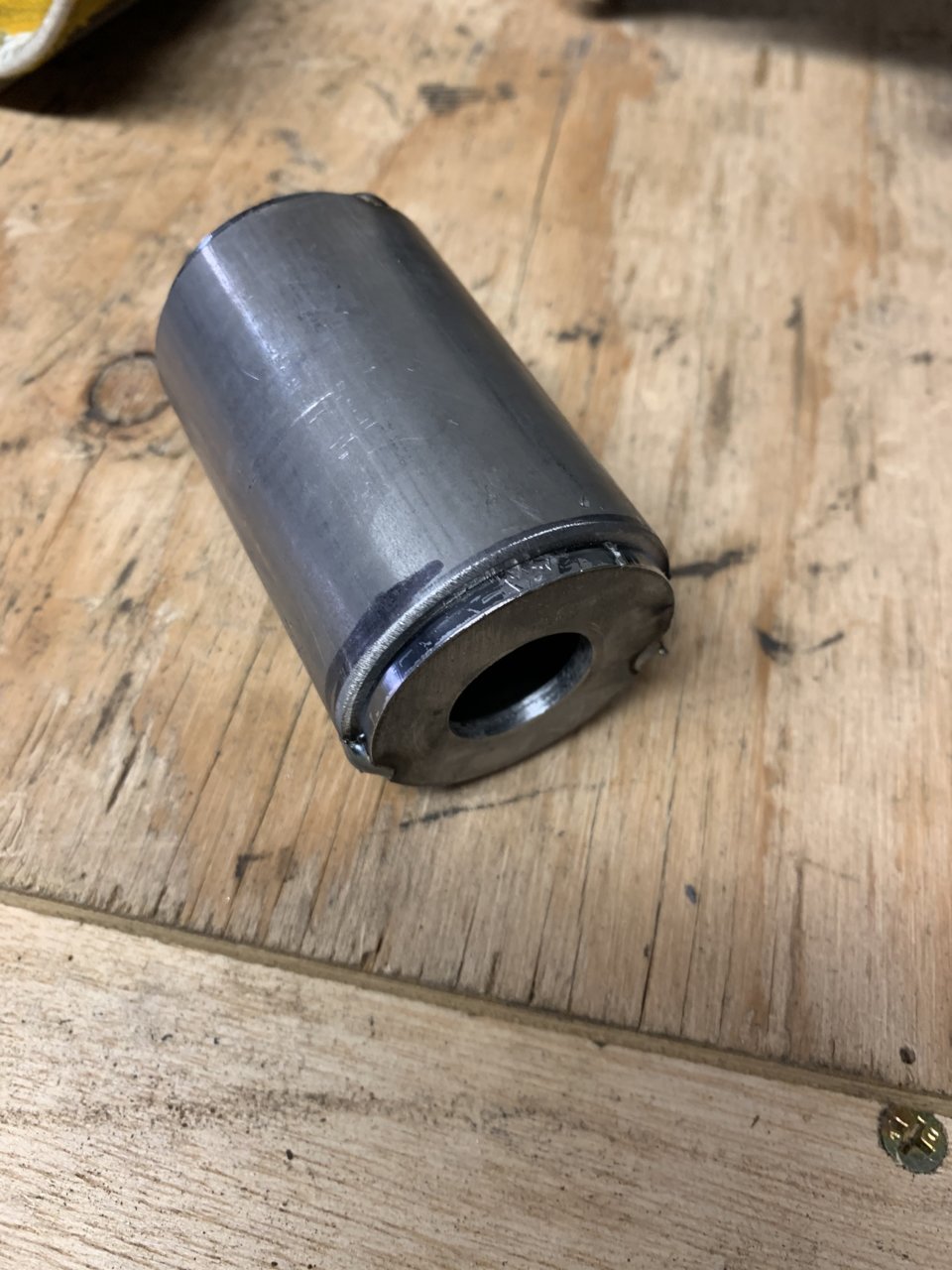

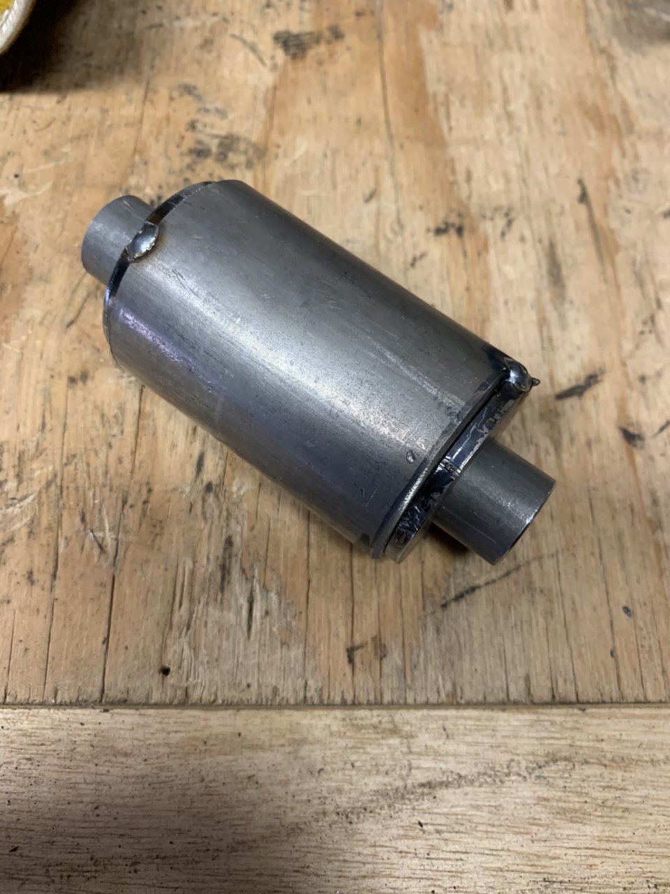

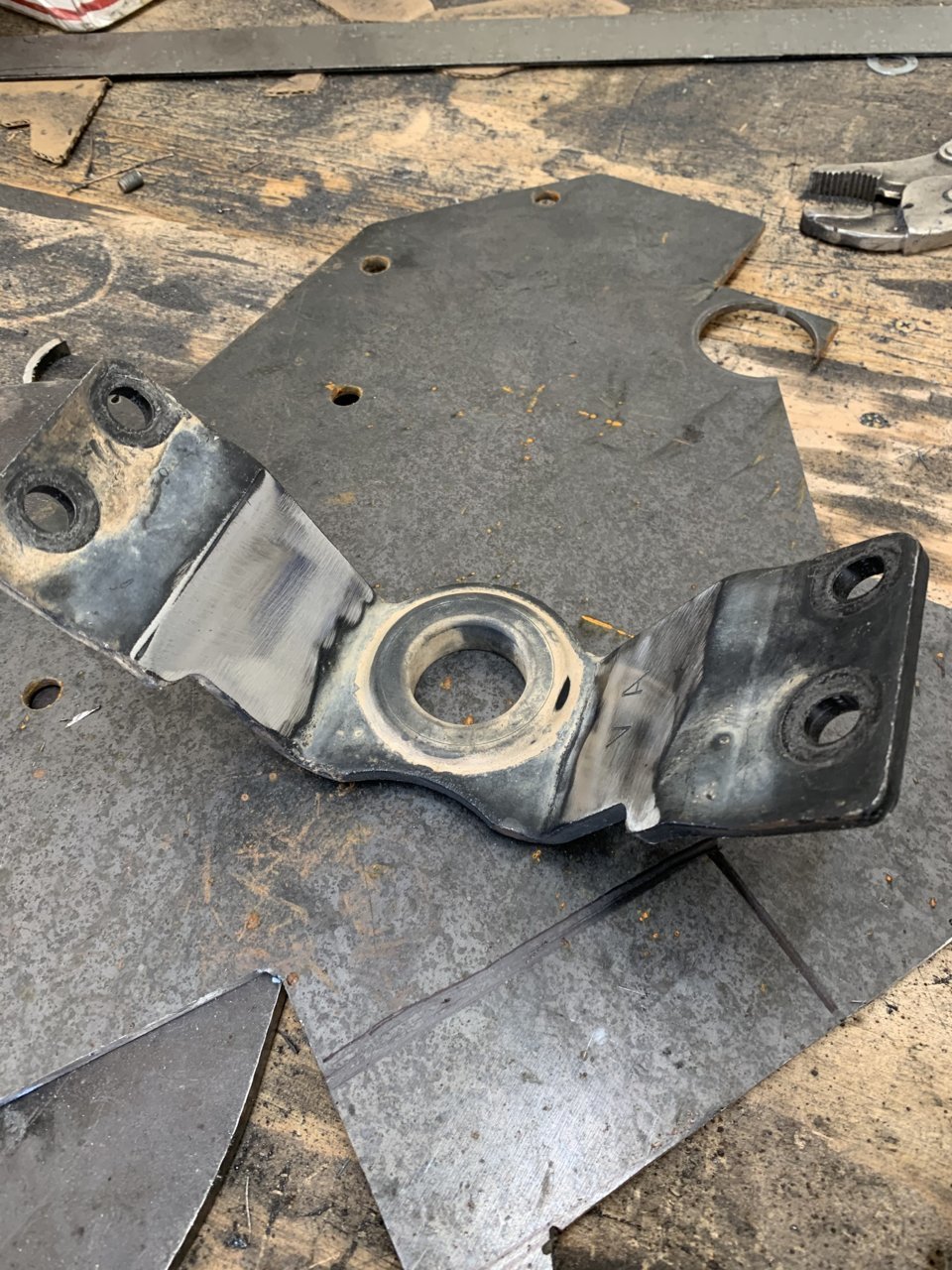

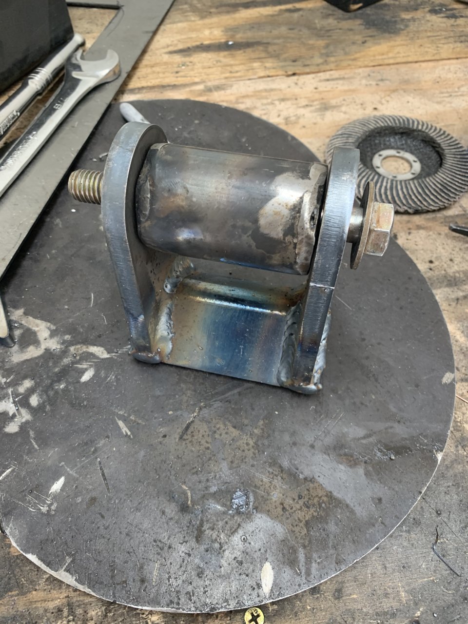

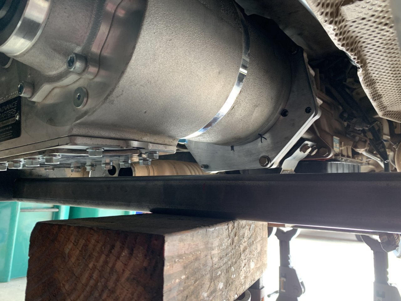

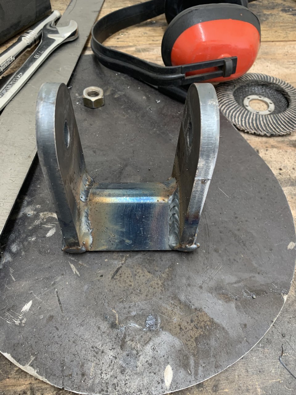

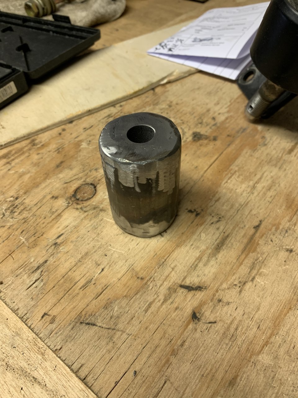

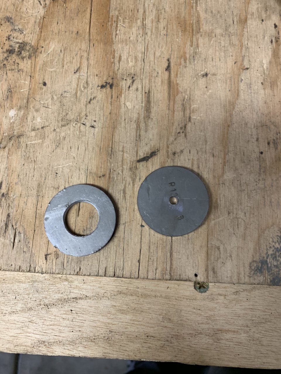

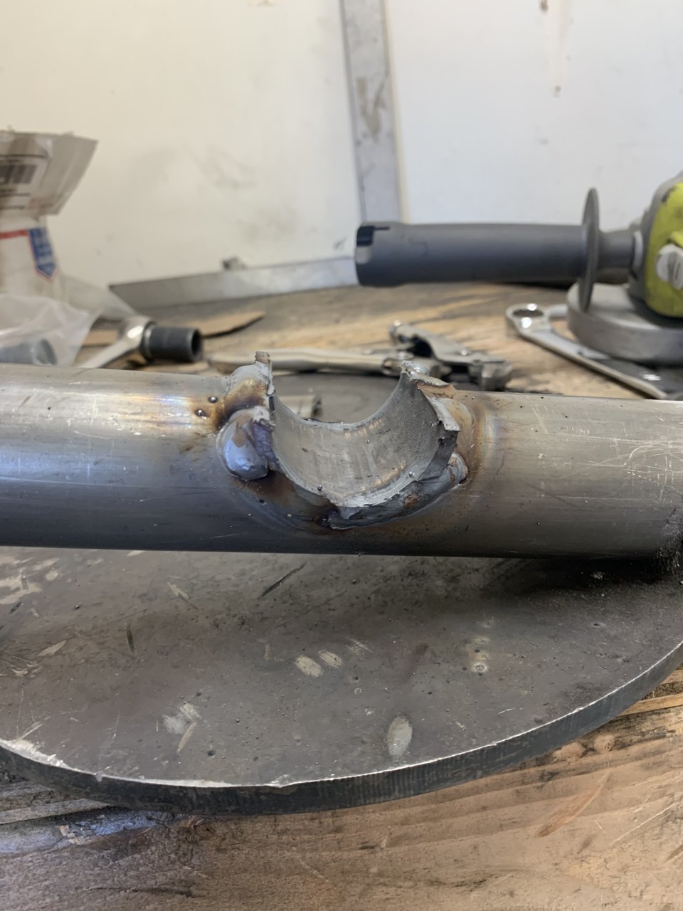

    Still making progress. I have the crossmember complete, as well as the tranny sub-frame, which took quite awhile to figure out exactly what I was going to do with. I ended up using 1.75" .120 DOM ran from the new crossmember kinked down to the front crossmember, having to work around the tranny dip stick and the front driveshaft at the diff. Ended up notching the tube around the dipstick and snugging the mount tight near the diff. The tranny is mounted on a pair of bushing that are suspended between the two tubes, the tubes will be plated for skids. Everything is pretty tight, but still above the frame rails, the skid will have ~1/2" clearance on the tranny pan. Mounts on the front and the crossmember are sleeved.
