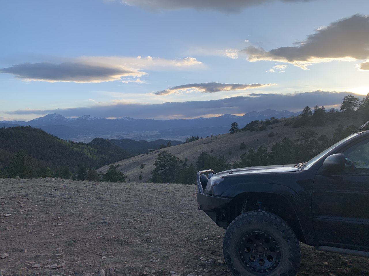

    So with everything appearing to be in order, I packed up the truck to head out camping with the little man and the pooch, the plan was to run a track I found in Gaia that goes from Jefferson to Salida through South Park all on dirt, and hit up China Wall on the way to try out the new gears on something a bit harder. Everything went well until I got to China Wall and found a locked gate, found out once I got back that the trail is seasonal and doesn't open for another few weeks, oh well. Made it all the way to the hills above Salida where the pic above is from, truck worked awesome other than a pop in the steering that I couldn't figure out solo on the side of the trail.
