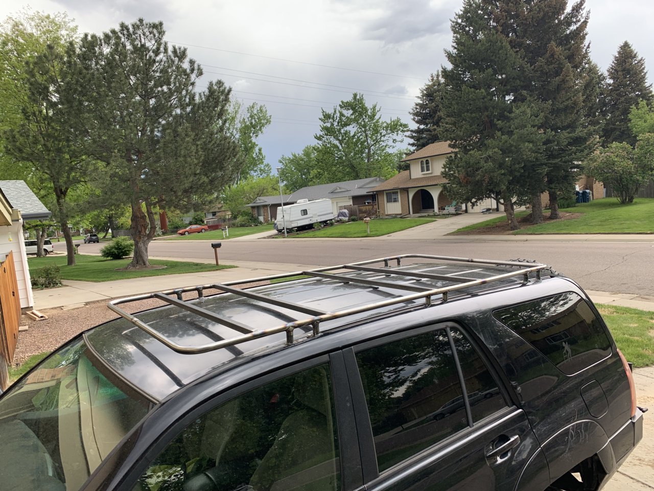

    Is that all 1" tubing? The center support on each side just sitting in the roof channel there and bolted at the factory locations?
    Think I'm going to fab one like yours instead of shelling out for a Sherpa.
  10. Jul 14, 2020 at 12:45 PM
    #1370
    Wishbone Runner
    Wishbone Runner [OP] Because 4R
    Sep 9, 2012
    #86546
    6,353
    James
    CO
    04 SR5 4Runner
    King/Dirt King
    Correct, 1". Yep, that is how every other production one is made and has been holding up great. I used .065", I think, I would go a just bit thicker if I were to do it over.
    xtremewlr[QUOTED] likes this.

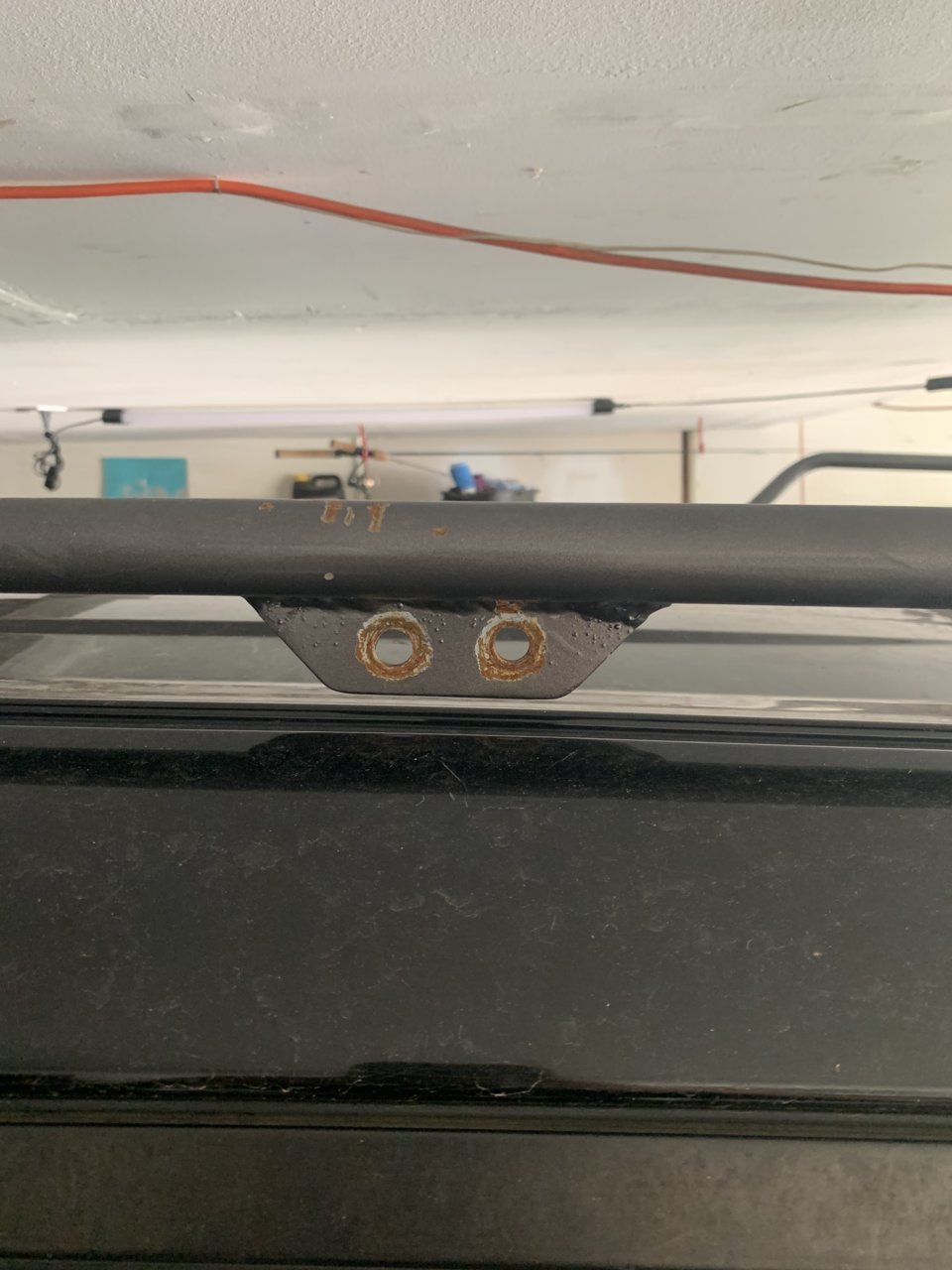

    How are you bolting the tent to it? That's the main reason I want a heavier duty and lower profile rack the the stock one. My other concern is going to be getting the 4runner in and out of the garage with the tent in place. Might not be able to do it, especially with a lift and some real tires like you have. I only have a 7 foot opening.
  12. Jul 14, 2020 at 2:31 PM
    #1372
    Wishbone Runner
    Sep 9, 2012
    #86546
    6,353
    James
    CO
    04 SR5 4Runner
    King/Dirt King

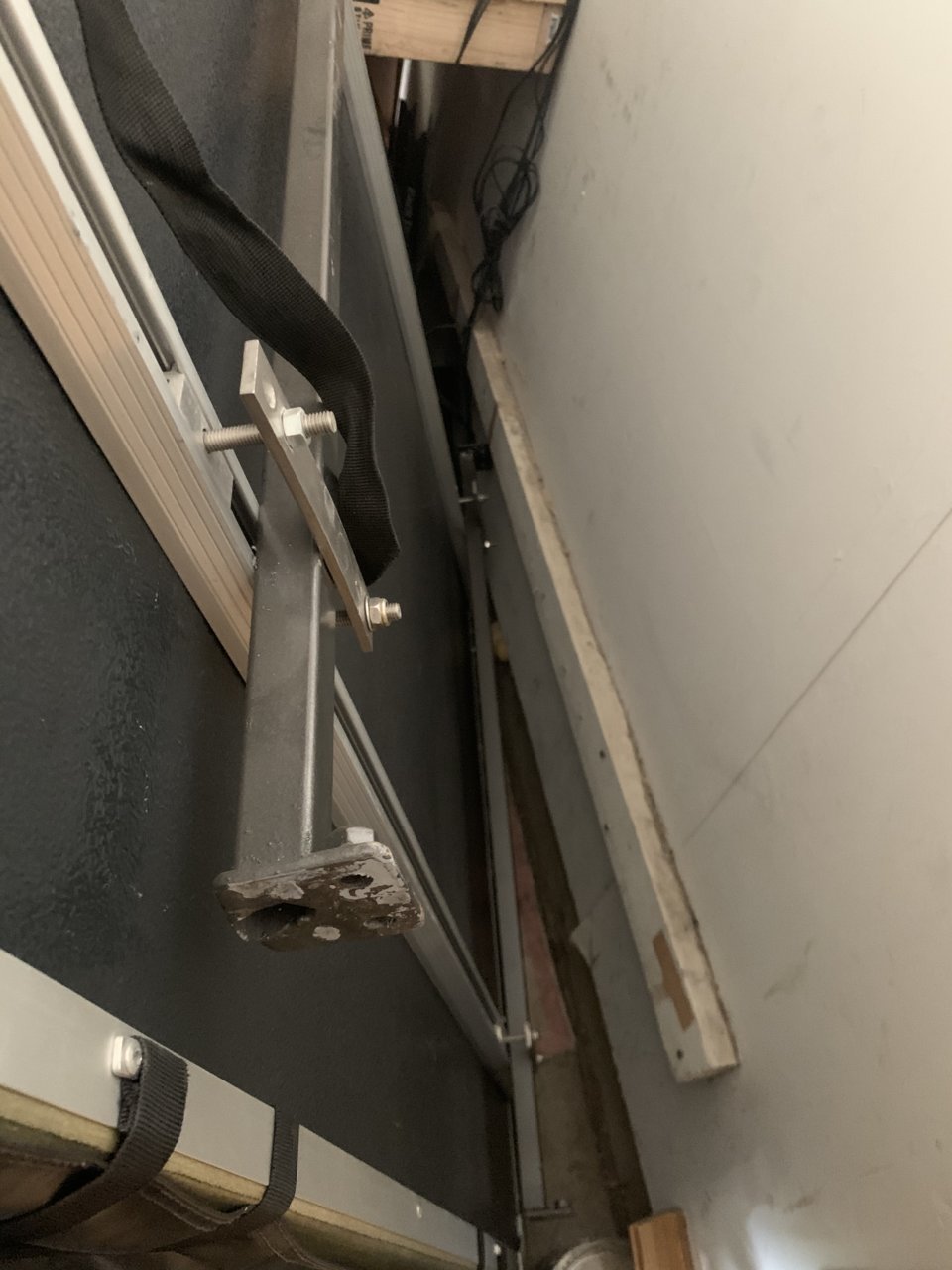

    I made the crossbar it is attached to removable, each bar has 2 bolts on each side that bolt through the rack, that way you don’t have to mess with the super hard to reach hardware from the tent. The nuts are welded to the back of the crossbar so only need to pull the 8 bolts that come out from the side and pull it off.
    EBD96C37-FC55-46FB-81AD-7EF9381270CE.jpg A918F4B3-A721-4F09-ACAB-1ACECA4952DF.jpg

    Oh nice! That's a great idea. Thanks again!

    No problem. I actually drilled holes through the tent to run 3/8" bolts through the tent and directly into the rack crossbars, getting rid of the aluminum tent crossbars, U bolt plates and skinny hardware that come with the tent, but the holes didn't quite line up and I haven't revisited making it work yet, but will be a much sturdier solution over what comes with the tent.

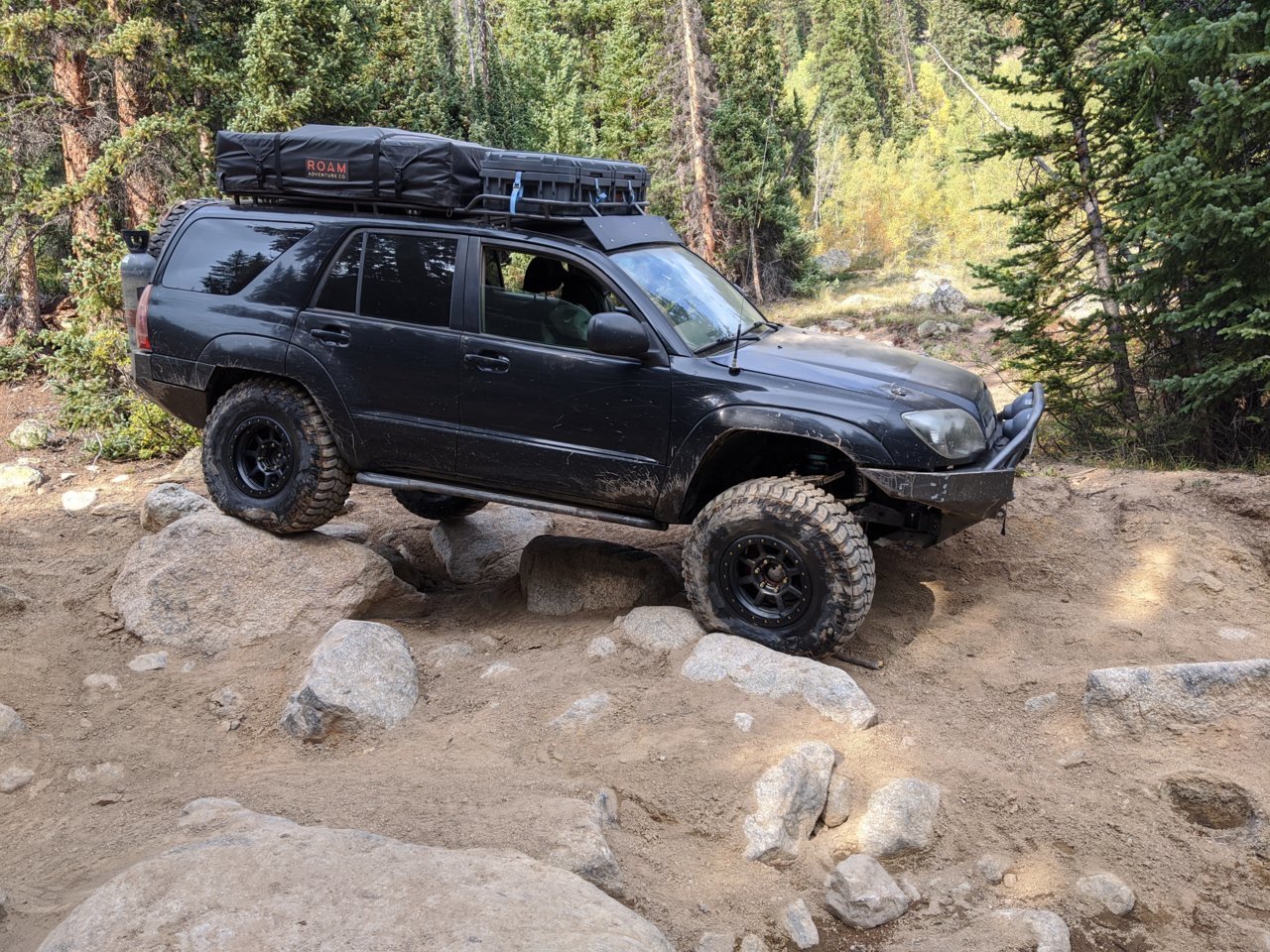

    Ha, just saw this, the line was fine until that rock under the diff didn't want to stay in the earth.

    It was really the only way to go and stay on top of the big one passenger side. I got hung up on it, rocked a few times, and then it rolled right with me down the trail a bit. Worked out fine.
