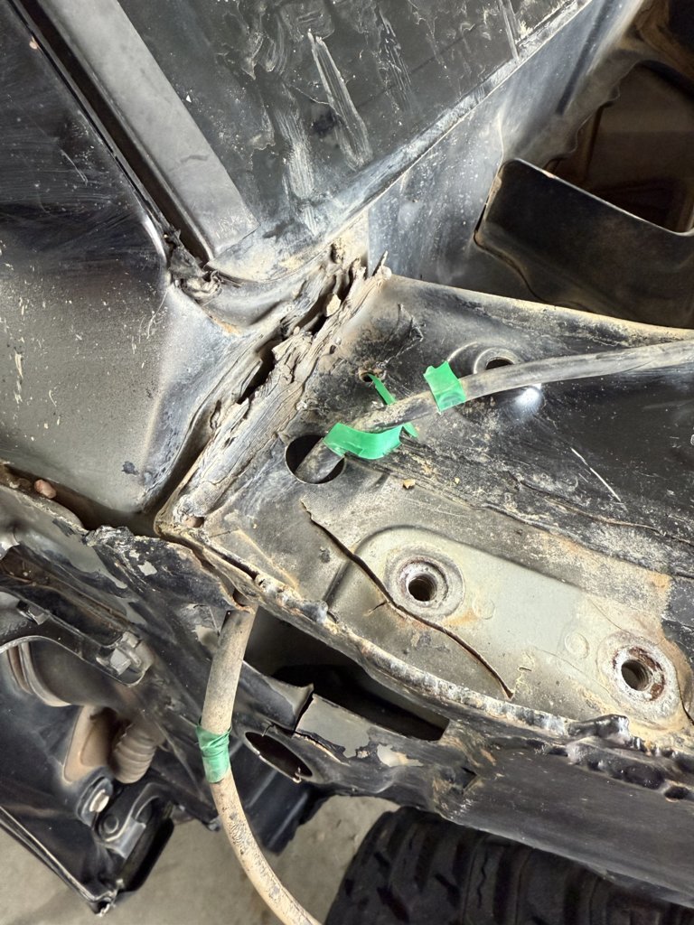

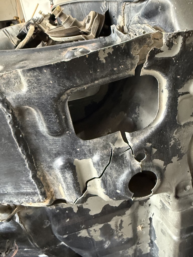

    Annual update time, TLDR; more shit broke, I fixed it.
    After 6 years of this repair holding on, I found the next weak spot, which was where the new support attached to the cab.
    Torn and frayed.

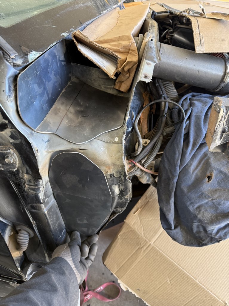

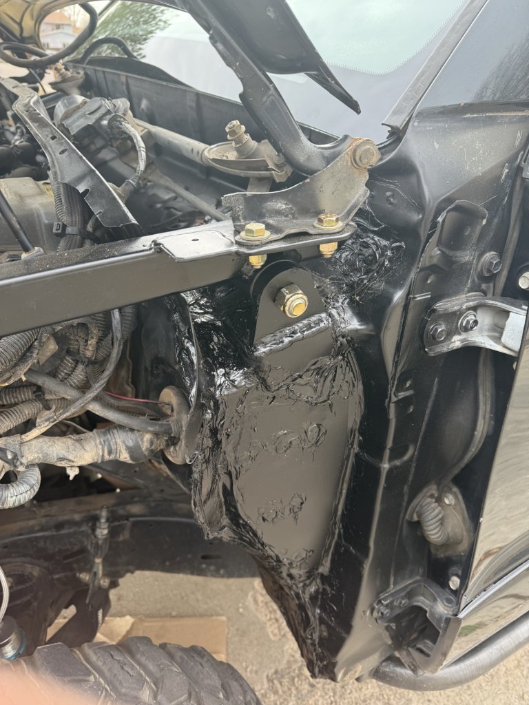

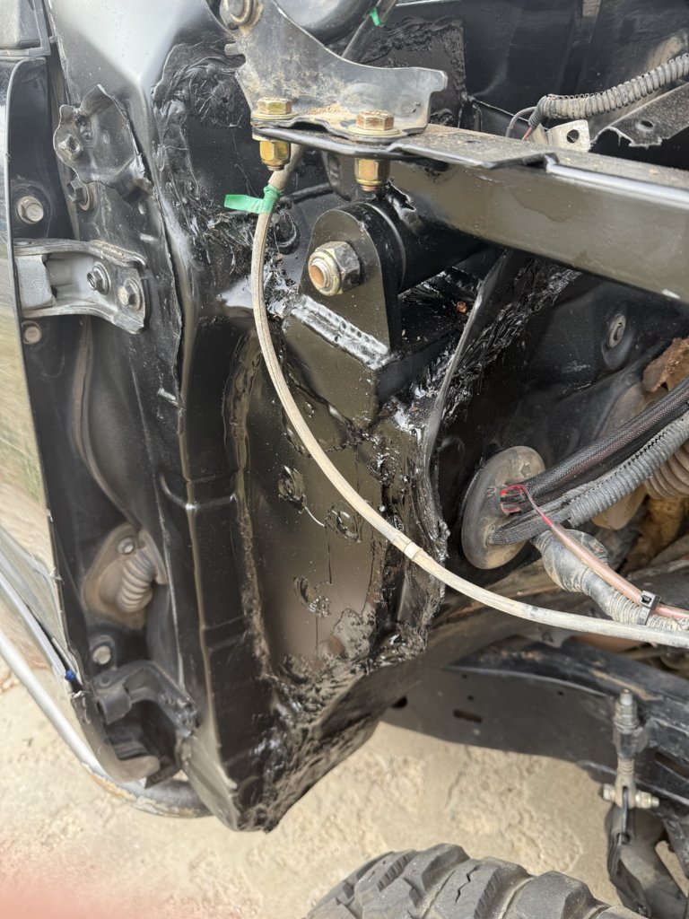

    So, cut all the cancer off and reattached to the body with a bushing. I plated the body, then welded and riveted the plated in, only caught the truck on fire once. Seamsealed everything and put it back together. I cut more of the original inner fender off so I need to make some new fender liners, but shes back together. Working on reattaching all of the body cladding and fender flares that are falling off next.
