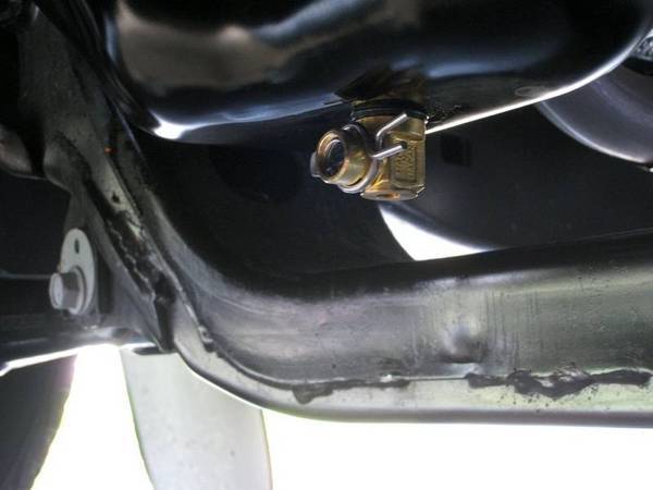

    Thanks Turboniun for sending the clamp out to me, it arrived this am.
    I mod'd the valve with 2 cross slots to allow better drainage, if you make this mod, your slots only need to be 3/16 deep (.1875"), I cut mine deeper than I should have ( .210" ) .
    The oil pan and valve are way above the cross member, no worries breaking that thing off...
