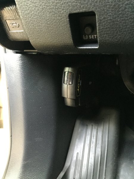

    Few dys later I installed my brake control and did a write up on here on the install.
    https://www.tacomaworld.com/threads/brake-control-install-write-up.428999/

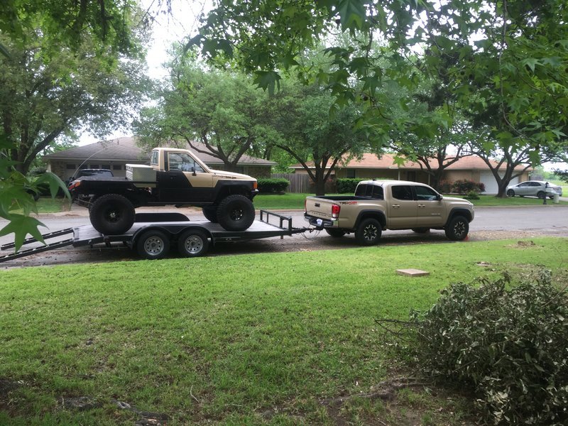

    Picked up my new car hauler and gave it a test tow to make for sure I hadn't made a huge mistake in getting rid of my trusty old Cummins. Turns out that the Tacoma is a bad ass!

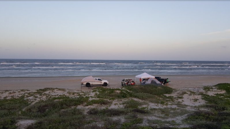

    Memorial Day weekend my little island girl needed some toes in the water ass in the sand time so we took off on a flying trip to the Third Coast's greatest beach IMHO. Padre Island National Seashore. I'd live here if they allowed it just miles and miles of wild.

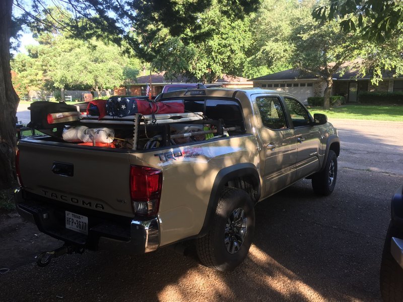

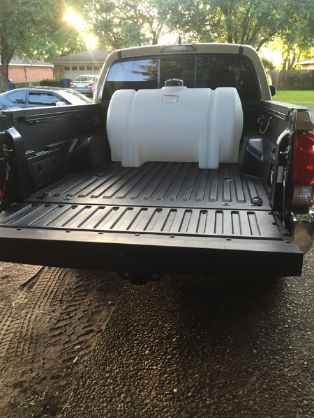

    image.jpg image.jpgUprights for the cross bars 2" channel iron. The actual cross bars are 1 5/8" unistrut. image.jpg

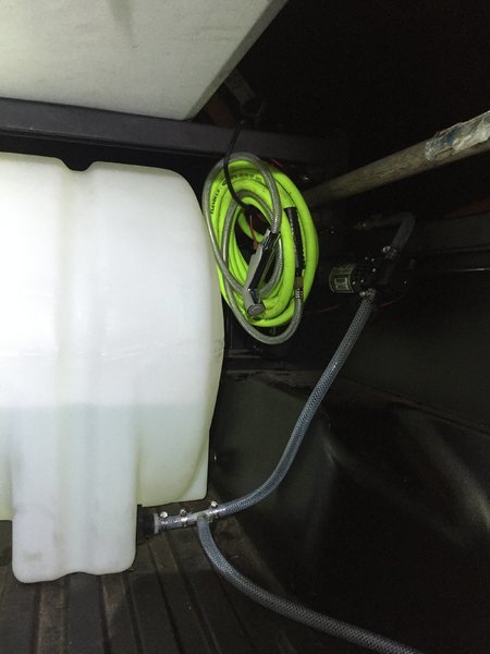

    4th of July weekend!!! Loaded up and ready to roll out. This is what all the prep work on the shower and cross bars was about. Multi day trip to the Third Coast for some camping.

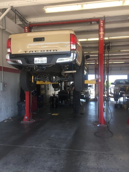

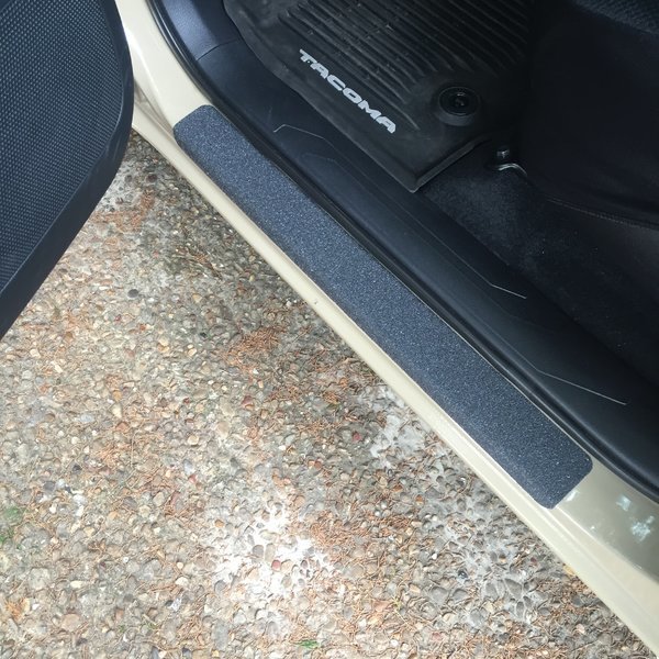

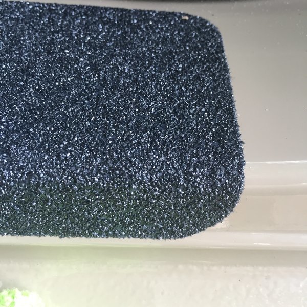

    Added some grip tape to the door sills today and took it in for the 10k service even though I only had 8500 miles on it. I have put the truck through its paces so I wanted it done early. I also changed the oil my self at 1k just to give me some peace of mind. The grip tape I got from the local skate board shop and had a friend cut to fit on their vinyl cutter. Works great for washing the roof sense I don't have steps or sliders yet... Yet! Note to self watch out for the grip tape while wearing shorts. Ouch!

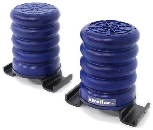

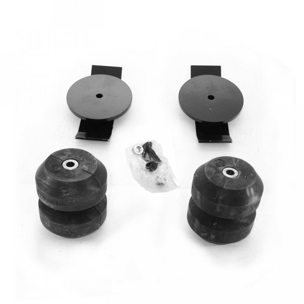

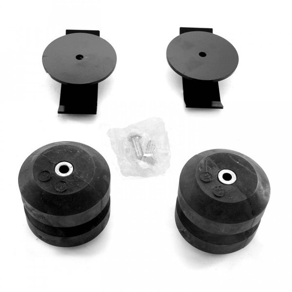

    Rear suspension extended bump stops. research for my thoughts and yours.
    SumoSprings SSR-610-40 constant contact with frame progressive rate advertised 1k capacity. I like the u bolt captive mount.image.jpg
    Timbren TORTUN4 these have 0 to 1/2" unloaded air gap to the frame advertised 6k capacity.image.jpg
    Timbren TORTUN4L these have a 1"- 1 1/2" air gap to the frame. Advertised 3k capacity.image.jpg
    Both of the Timbren use the same bump stop the only difference is the height of the steel base one is 5/8" thick the other is 1 1/8" thick. Timbren springs are great used them on my Dodge after getting sick of blown air bags but they ride like crap unloaded.

    Red Beard, have you thought about a standard tow bag set up? the money isn't all that much greater and id think you may benefit from it in the future?
    you mentioned blowing airbags, how did that happen? Ive had air suspension on my trucks for the last 20 years without that issue.
    RedBeard1[OP] likes this.

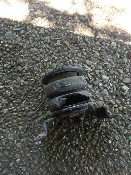

    Yeah I thought about it but after my past experience with them, pretty sure it is 8 that I have blown over the last 15-20 years I'm going to go with what I found to for sure work and not let me down.
    One of the last ones that blew on me. This one took a tire with it with 25k on the trailer.image.jpg

    I believe @smugly has the SumoSprings on his truck, he might be able to give you some more information on how they handle.

    Yeah we run them on some of our trucks at work that carry constant loads. That's why they are on my insane rambling list of rear suspension upgrades.
  13. Jul 7, 2016 at 3:11 PM

    Love my Super Springs !Constant load and progressive Load when load is applied.and install was stupid easy!

    Yeah these are what I am leaning toward even after I swap to the Dakar rears I will keep them on there just to soak up some of the bumps.
    Did your's settle out after a while or are they still giving you about 1/2" lift in the rear?

    The rear suspension does great on this truck when trailering but when loaded on the chassis/bed only it doesn't work the way I would like it to.
    I also drove a 1 ton for the last 15 years so I am a little used to its load capacity still. I have had 8500 lbs on the flat bed of that thing and not a whimper out of it.

    They ended up about a quarter inch higher, but more leveling the truck out

    Like you, I weeded through the options of what to do with the ever failing Tacoma rear leaf springs, and came across the sumo springs. After looking at all of them? I chose the sumo's because of course of, the ease of install and the fact that they were progressive and all the experiences I had with airbags , I knew the truck would ride stiff because of how lite it was compared to a full size truck .

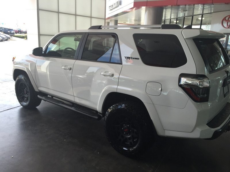

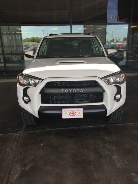

    Picked up my little wife a TRD PRO 4Runner today. She was extatic! She had no idea what we were going into town for. She was looking hard at the runners when I got my truck so I decided to suprize her with one. Was going to get a quick sand one but she wanted another white vehicle so Super White it is.image.jpgimage.jpgimage.jpg image.jpg

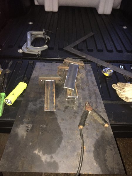

    Little update... rock slider frame plates are being cut and I ordered my Prinsu cab rack.
