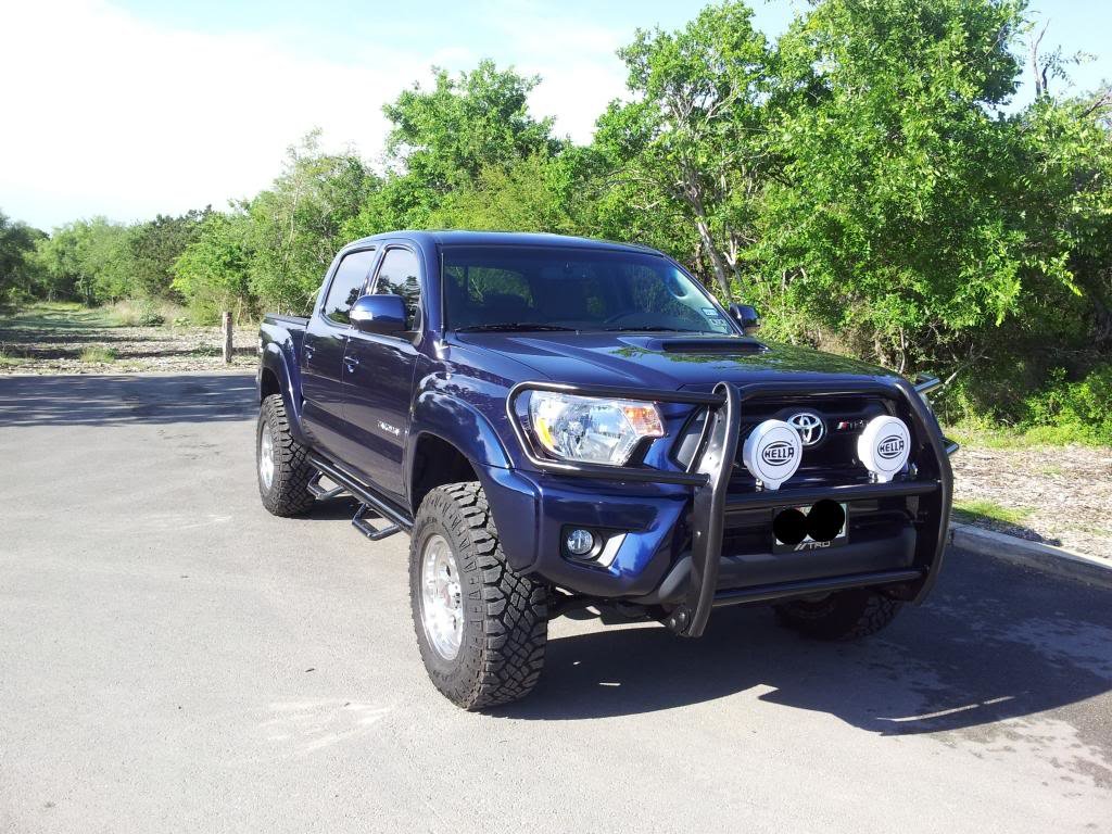

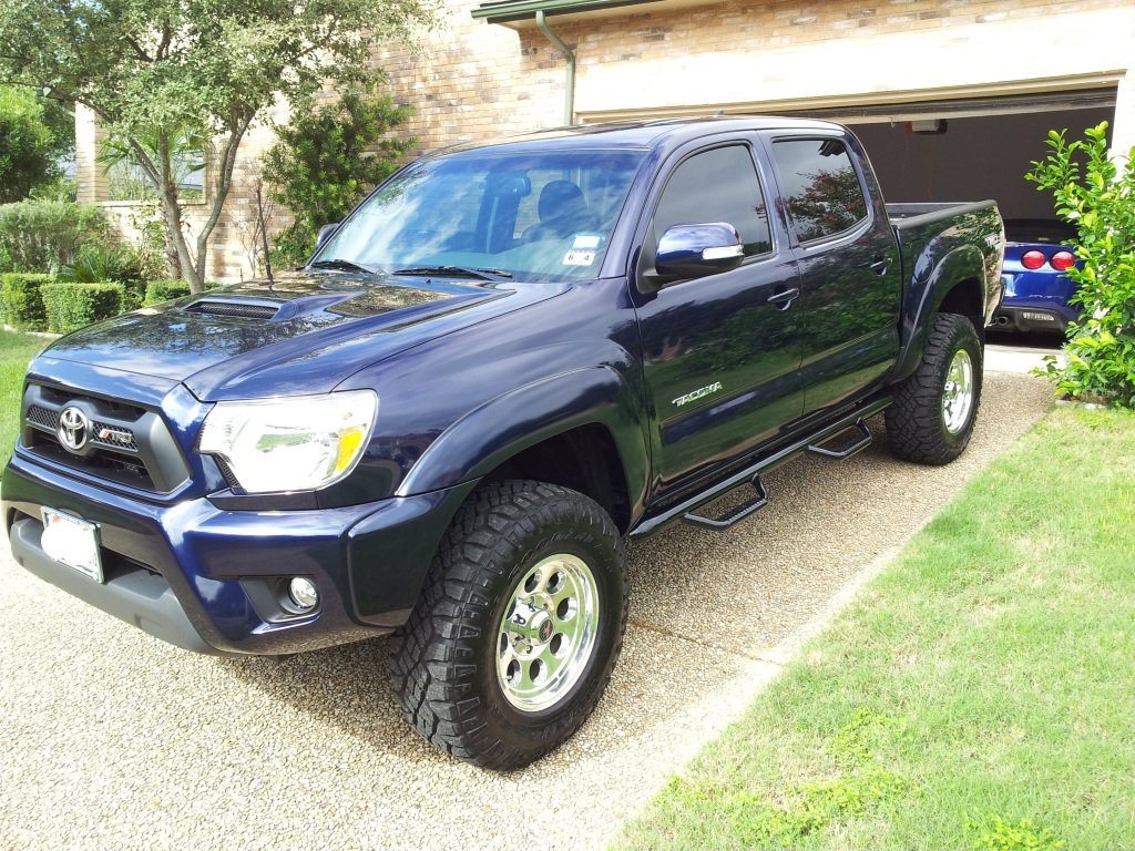

    ^^^^ What he said. 2.25" is going to be way too high in the front. 5100 set at 1.75" in the front will make it perfectly level and have a better ride...that is my set up
    Just about any aftermarket wheels will look better than stock. even only 1 tire size up will make a big difference.
    265/75/16 - 5100s set at 1.75" in the front. 4 Factory leafs in the rear. No Rubbing. Much better ride & handling than stock.
    See my write ups on this topic
    http://www.tacomaworld.com/forum/wheels-tires/260429-2013-dcab-small-lift.html#post6375347
