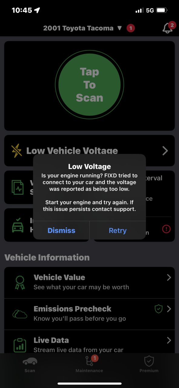

    Went out this morning. Cranks and cranks but no start. Put in a new battery. Still no start and no change. Trying to pull any codes and it won’t let me. Just shows this.

    I’m getting fuel. Fuses are all good. All electrical is good as far as wiring plugs coils. My buddy’s dad came over from his shop and brought his fancy code reader and even he couldn’t pull anything. It’s not even recognizing that the truck is on and it’s not communicating with the computer at all. He’s been a mechanic/tire tech forever now and owns his own shop and even he’s perplexed.

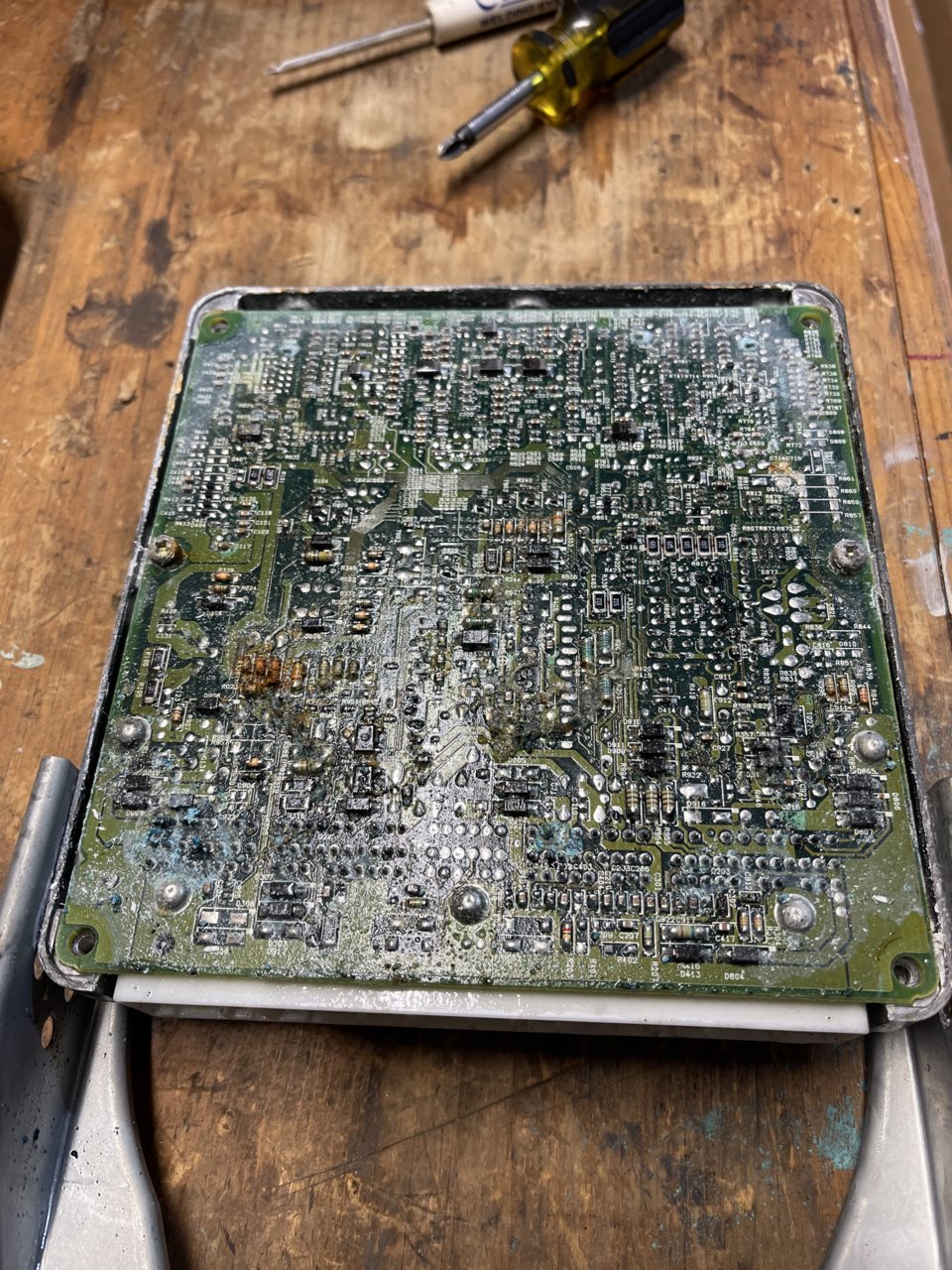

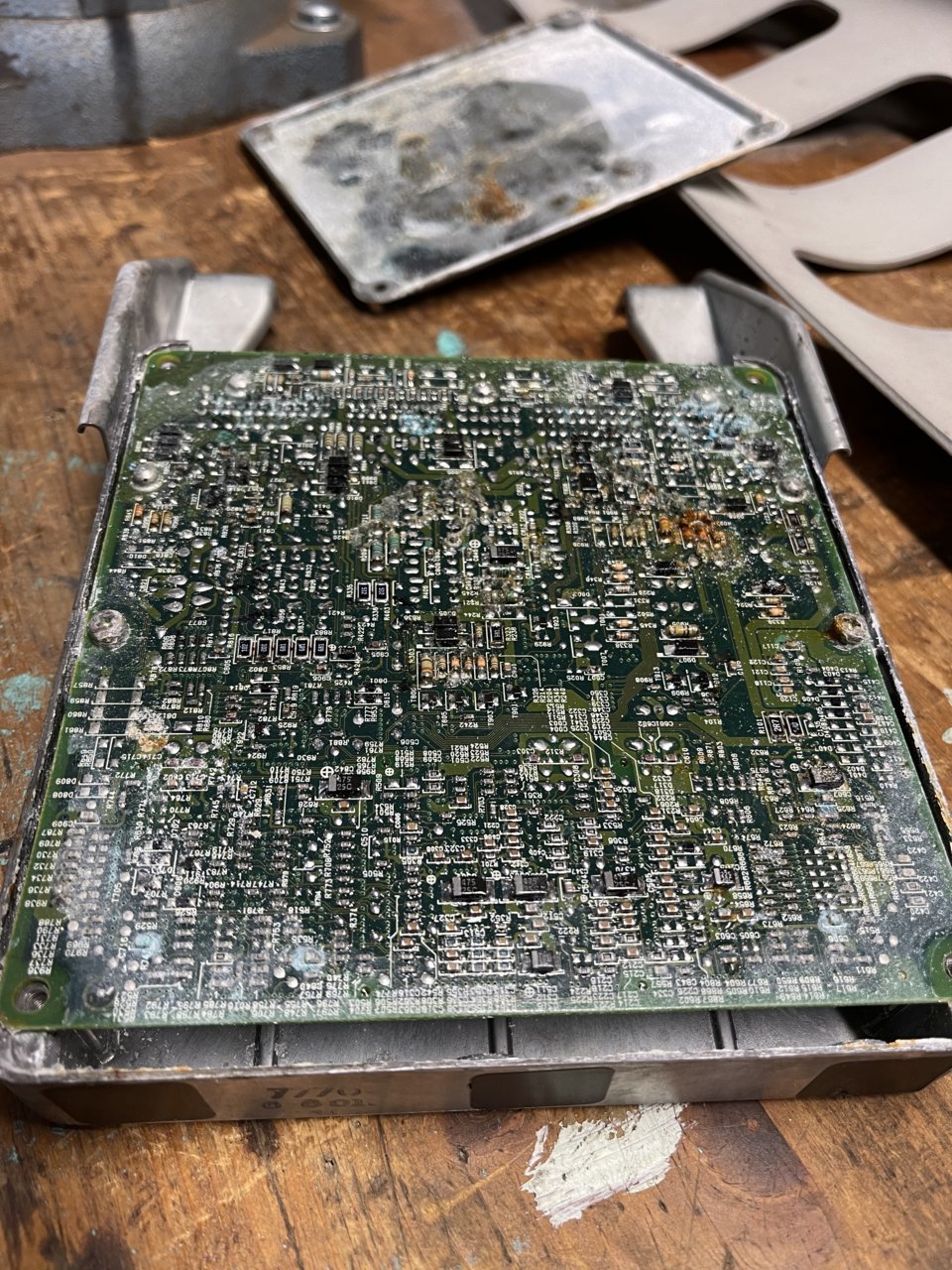

    We found our culprit. Followed Timmy’s video. Luckily it was very easy. As soon as I took it out water came pouring out of it.
    Now I’m planning on letting it sit inside somewhere near a heater and hopefully it dries out and works again by the 30th. What do y’all think the odds of that are?

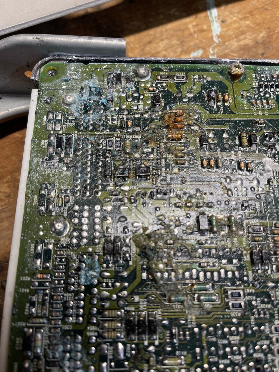

    Few areas in question? Or does this look normal?

    I'd start with some electric contact cleaner and a soft brush.
    I'd also start looking into some of the ECU refurb companies in the likely event that it's toast.

    That looks like that’s been getting wet for quit some time…need to find out where the leaks coming from before replacing it

    If you’re able to get it going, I would definitely be on the hunt for a replacement. I imagine electrical gremlins will be showing up at some point from the looks of that PCB.

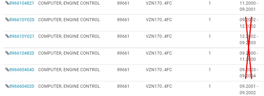

    This is what was available -
    If we rule out by year, that leaves 2 possible PN's. His label shows a PN ending in 821. That leaves one -
    8966104821
    https://www.toyotapartsdeal.com/oem/toyota~computer~engine~control~89661-04821.html
    This listing talks about programming the ECU with a VIN#. Since I know nothing about swapping ECUs, I'd definitely check with someone in the know (@Speedytech7 maybe).
    https://www.ebay.com/itm/385304095780
    Hopefully he can track one down and replace it after he gets that leak resolved. CA is in for another week of rain. Oh and I would still confirm with a decent parts department using VIN just as a sanity check lol.
