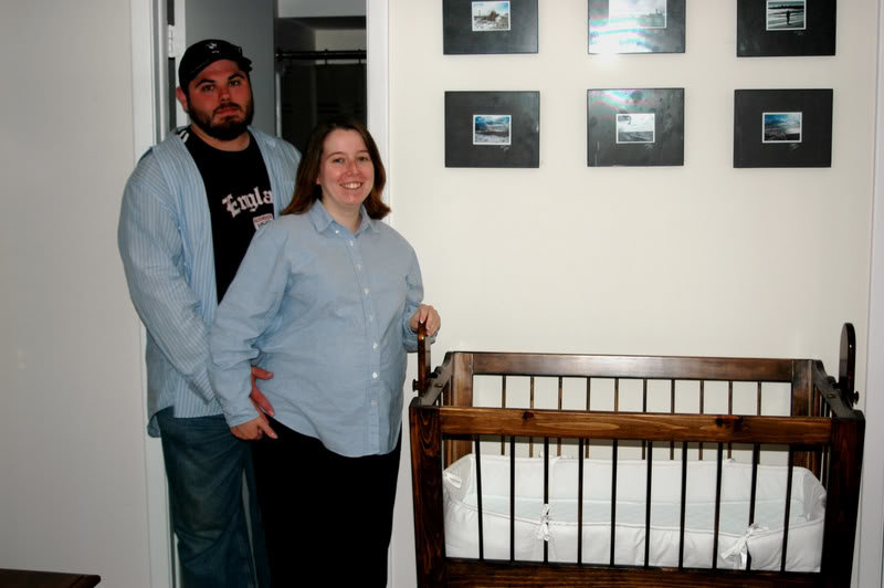

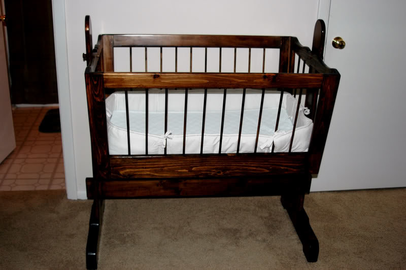

    Here are a couple of pics of my latest creation.
    A cradle or basinette if you prefer, built for my closest friend and his wife before the birth of their son.
    Here they are on the day I delivered it to them, about 2 weeks before my godson was born.
    After I built that, I ofcourse opened a can of worms and my better half now wants her own handbuilt piece of furniture, so I am in the planning stages of building her a rocking chair, and by planning I mean I think about it while I drink, but I am mentaly at a loss for how to curve the very top of the chair where the spindles will attach, the head-rest if you will. Any ideas?

    Looks really good you might have found a hobby that will pay off.

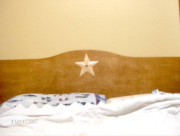

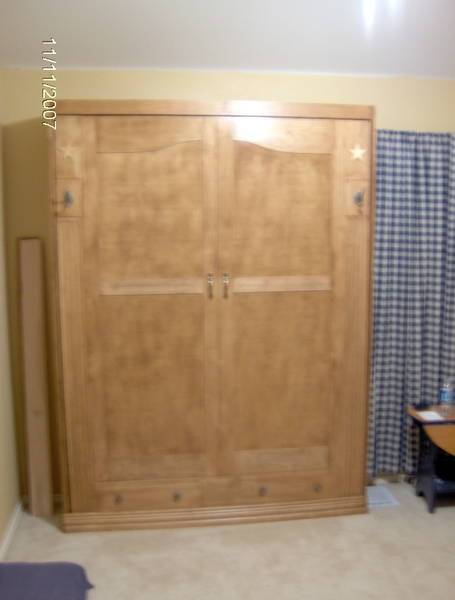

    Damn, I got called out to defend my use of my nick. What's a guy to do? I hunted down the digital camera, replaced batteries, tried to get it to work, replaced batteries, took some pictures, replaced batteries, hunted down the cable that connects to the computer, replaced batteries, downloaded pics to my computer, figured out how to upload pics here, and then found the thread to post. maverick, I hope you appreciate all the work I put in just for you.
    First of all, sorry for the quality of the pictures. My wife is usually the photographer in my family. I think you can get the idea.
    OK. Here's the front view. I wanted it to look like a wardrobe. It's solid maple and maple ply. Finished with a colonial maple stain. The crown moulding I mentioned before is standing to the left.

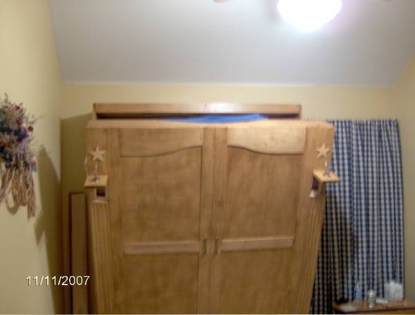

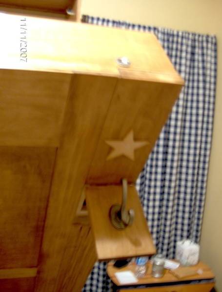

    Those hat hooks on the top corners act as handles to pull out the legs, these in turn pull a cord attached to a latch that holds it closed.
    Here's a closeup of the hat hook, leg, and latch. It's hard to tell in these pictures, but in this one you can kinda tell that there's fluted columns on the outside edges

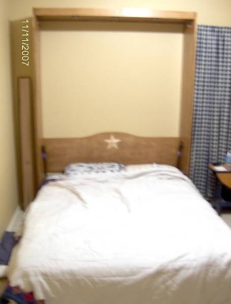

    The opened bed. Ignore how poorly it's made. Those fuzzy black cylinders are air pistons that counterbalance the bed so you can open and close it one handed.
    continued...

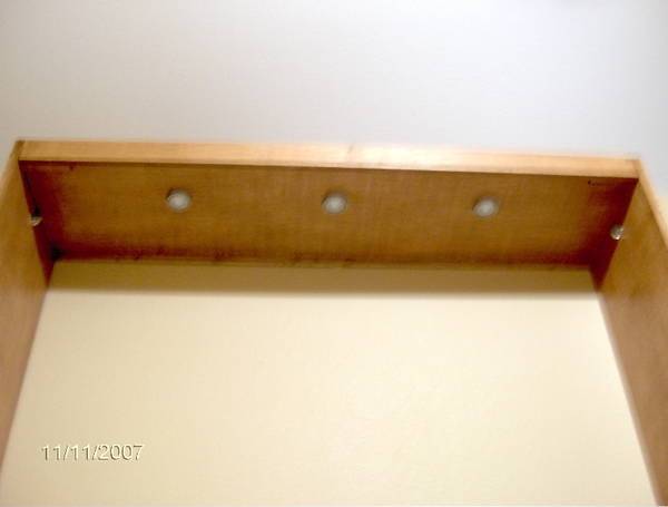

    Under the top I have 3 low voltage puck lights. On the sides of the cabinet are the stops.
    Wiring for those lights go through a channel at the back wall, pass behind the headboard and the pushbutton switch is in the center of the star, then up a channel at the wall on the other side. I carved the 3 dimensional star myself. A nod to being a Texan (deal with it maverick).

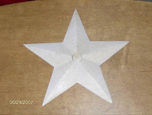

    I actually dug up one of the few pictures I took during construction (ok, it was still in the camera). A closeup of the star before it was finished with tung oil. This shows the wooden button that will cover the pushbutton switch. I've still got to figure out the best way to attach that to the metal switch.
    This was a huge project to tackle for being my first project that deserved more than a coat of whatever paint we had leftover from something else. It was huge in all the procedures I'd never done before, as well as huge in scale (about 7 X 5 X 1.5 foot). I'll be looking for something smaller for my next project.
