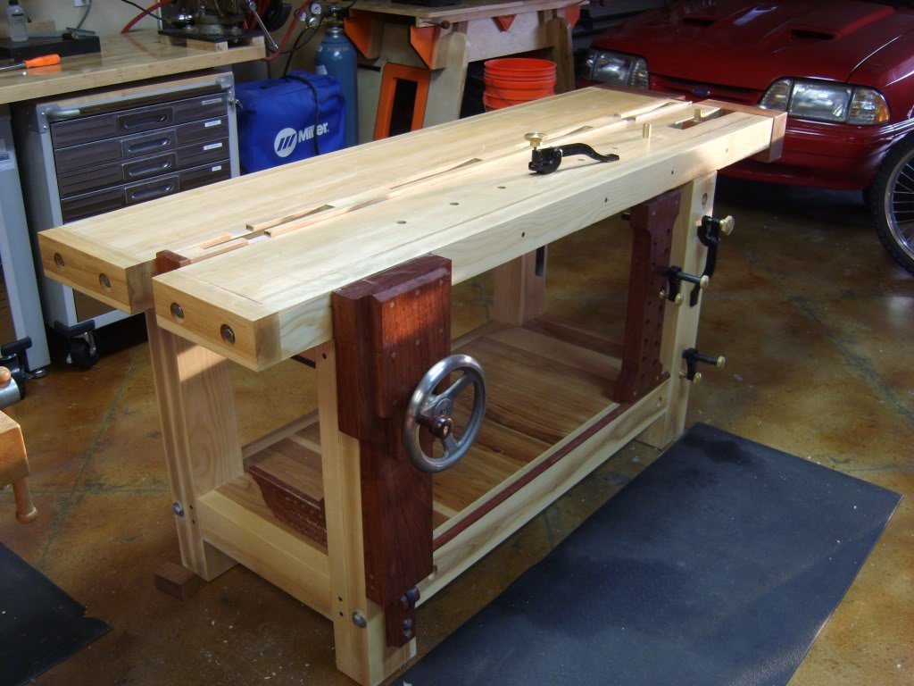

    Made it myself out of Solid Ash with Bubingua Accents. Shelf is solid Pecan.
    It is basically a custom Split Top Roubo Bench.
    Used Benchcraft Vise Hardware for the Leg Vise and Wagon Vise.
    Have some Veritas Clamps.

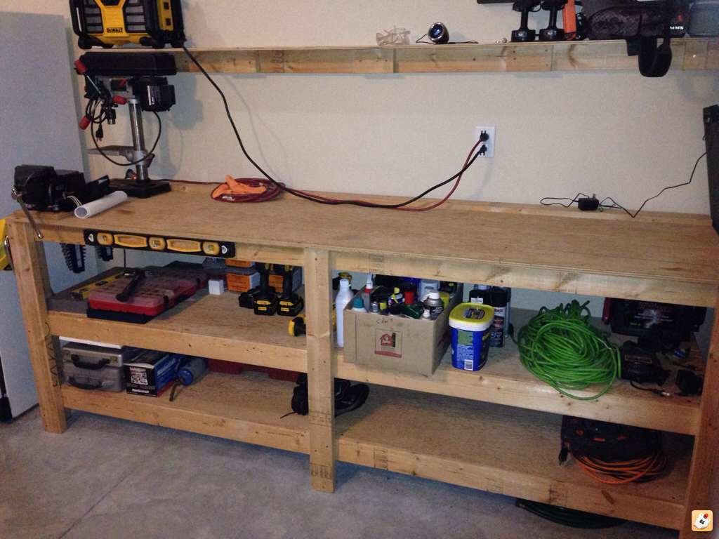

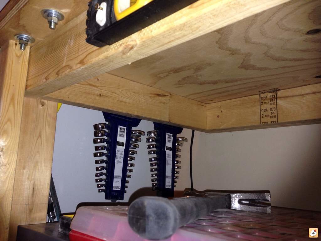

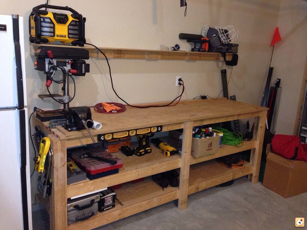

    Here's mine, in case it can help anyone:
    tuparaga_339a806136ff9cbe76183bb253d2762b28f38bef.jpgy8ureser_bc1050583e97a7ed340d6c1092bc52c0b0e11673.jpga5ujy4yr_8d484e6c5184940590f764c912a8c6fa4f08a368.jpg
    I used 2x4's, 7/16" plywood for shelves and a 3/4" plywood top. Shelves and top are made with 8'x2' "frames", screwed onto 8'-long 2x4 rails which I mounted screwed to the studs in the garage wall. Legs "wrap" around the front corners. Seems very solid. First one I've ever built and I'm very pleased with it. When I add more receptacles to the garage, the mess of extension cords will be removed. I have my tool chest full of all the tools and use the bench for hardware/spray storage. Also have a 9'-high x 4'-wide x 16"-deep shelving stack constructed using a similar method.
