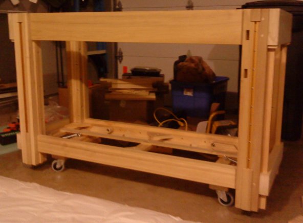

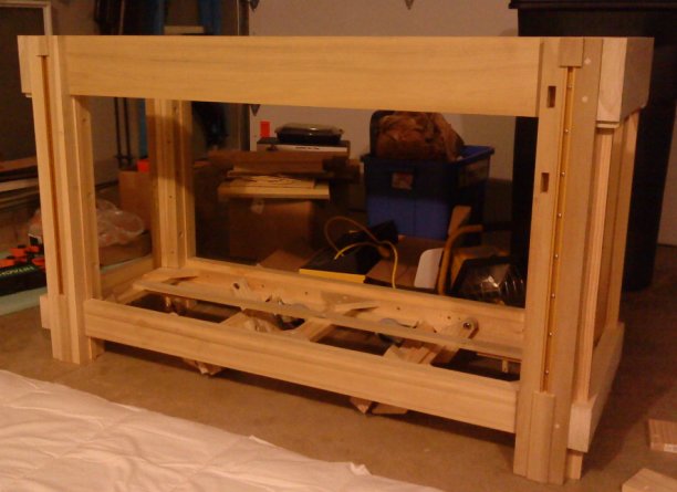

    ...here is my progress on my workbench frame... i fabricated retractable wheel system to make it easily mobile... the wheel mechanism retracts and deploys automatically (w/ a caveat for the deploy step) by lifting up on each end of the frame... i put more picks in the "home improvement today" thread...
    i also have recessed t-track on both front legs, ...and two rectangular mortices on one leg that will be for mounting accessories, like a small sharpening "station"/table, and the like... maybe this will help w/ ideas... :)
    wheels up (resting on ground, "working position"):
    wheels down (mobile position):

    That will be a very nice WorkBench Wiley. My compliments.
    Mobility is an important feature.

    WileyC - I like the wheels - I think the springs pop them down, am I right? And a dedicated sharpening station is one of the best things you can have in your shop if you mess with planes and chisels. With one of those gooseneck lamps with a magnifying glass. Kerosene is great to sharpen with, BTW.

    ...yep, there is an extension spring on each side (one per mechanism)... the mechanism swings in a semi-circular arc, ...in going from deployed to retracted, ...gravity does the work due to the center of mass of the mechanism and casters location offset from the center of rotation. there is a small "idler" (a shower door roller :D) that contacts the floor and keeps the wood components off the ground when in fully retracted position... however, for the reverse (retracted to deployed), an "assist" (the spring) is needed to rotate the mechanism far enough for the caster-floor contact to complete the rotation... to put the spring under load, i simply pull a "t-handle" connected to the end of the spring and secure it in a clasp located under each end of the bench (not visible)...

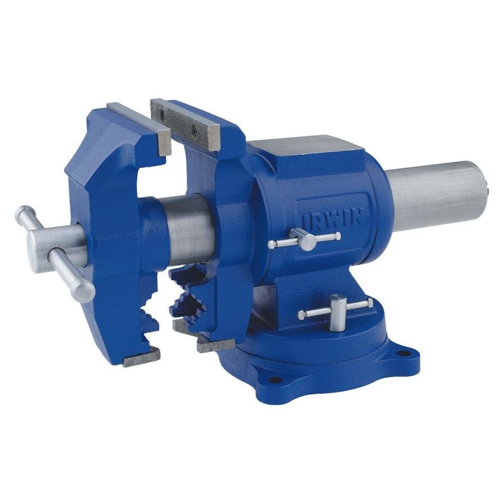

    I think I will eventually get a similar top mounted vise as below, and was thinking putting it in the front left corner (right side of bench will be against wall). I know I want the internal jaw to be just past the edge of the bench top, but not sure if there will be room to mount it to the front of the bench for this.

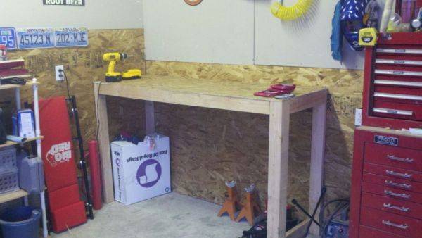

    Here is my bench. My wife built this for me one day while I was at work. lol. I need to put a shelf above it, and get a piece of sheet metal for the top. Makes clean up way easier.

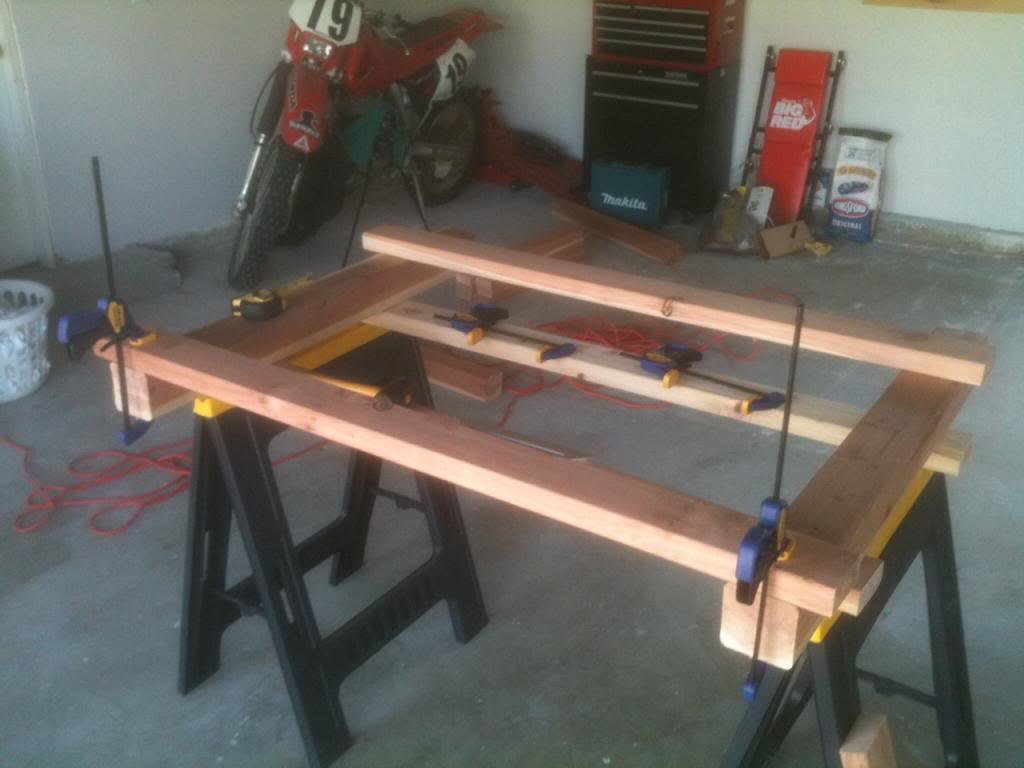

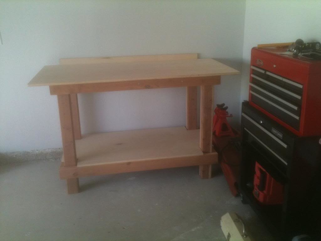

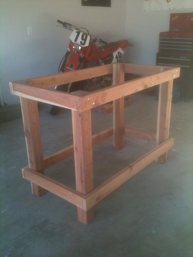

    Finished the workbench. Nice, simple design. Wanted to say 'Thank you' to all who helped to answer my questions along the way.
    Frame is redwood 2x4s and the legs are redwood 4x4. The shelf and top are maple ply.
    Still deciding if I am going to treat it with some kind of oil based protectant (such as Minwax), or leave the wood raw.
