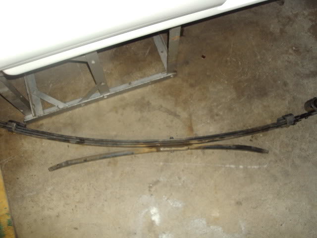

    Heres a pic of my stock springs off the truck, you look at them & think "Hmmm, they have arc they must be good." But they are sacked, put them on & they "frown" on both ends....

    & here is my fix for tired springs....

    yep Doug's fix worked for me. Until that is I removed them because I wanted better MPG that never really happened...long story. Even after removing the extra leaf my stock leafs are back into shape. I believe running the extra leaf in a way re-arched the spring and now they have a nice arch. They use to sit flat on the OL but now there is a 1/2 air gap between the 2. It's been 20K miles since I removed them and they are still nice. Also the top of the tire was even with the top of the frame rail and now I have about an 1" or so of frame rail over the top of the tires without any lift at all.

    Wow, it actually re shaped huh, go figure....
    You went with the Dodge Dakota springs if I recall Terry is this correct ?
    If anyone has noticed how low the Dakota sits in stock form & yet some have a 3/4 ton rating, those Dodge springs are noticably thicker and really stiff, wonder how long your stockers will hold up . Let me know buddy, real curious , thanks...
