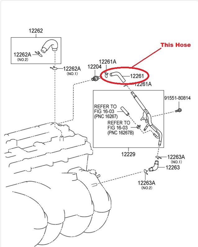

    Wow you're good. Any chance you can get me the part number for the PCV hose for the same truck?
  4. Jan 19, 2019 at 11:04 PM
    Jimmyh
    Jimmyh Well-Known Member
    May 16, 2012
    #78991
    14,270
    SC
    2012 Prerunner SR5
