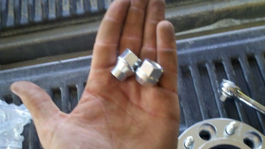

    Then only spacers that you should run with stock rims are hub centric as stock rims are hub centric rims.
    The thin wafer spacers are NOT a good idea especially on the front tires as the studs on the fronts are already very short.
    get good hub centric ones from Spidertraxx or Allpro and get Extended lugs!! These grab much more of the wheel studs and increase their safetly.
    Good spacers are not that bad to run. I wheel pretty regularly and have had no issue at all as well as lots of other members. Hell there are lots of LT guys running them and if they hold up to that kind of beating..don't see how they wont for a normal driver.
    ET vs standard lugs
    i have allpro 1.5'' spacers and 4'' BS rims. I still rub like a bitch with 33x12.5s..but thats due to the 2.5'' BS :p

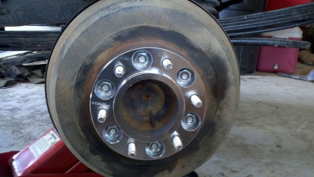

    No, i had stock toyota rims.
    Hub centric are like this
    The middle pops out so the wheel centers itself, hence hub centric.
    Lug centric center the wheel of the lugs.

    ^ welp... those look lug centric to hub centric to me...
    Don't the lugs nuts holding the spacer to the drum
    seat and center the spacer ?
    Tacoma wheels... I know for fact...
    are lug centric in their mounting.
