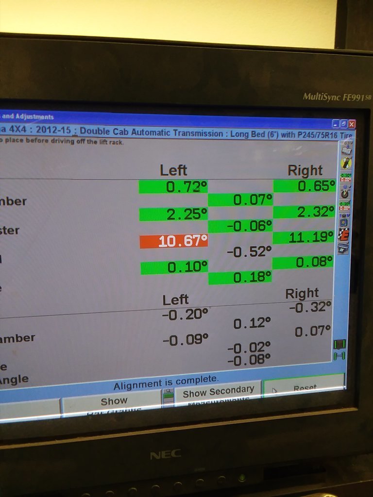

    You posted an alignment sheet showing negative caster on a Tacoma with a 3" lift and camburg upper control arms. It's safe to say either the frame is twisted into a pretzel or the alignment wasn't properly performed. Those are the only two possible options.
    Something is horribly bent or the alignment wasn't performed properly if you have negative caster with a 3" lift and camburg arms.

    You are correct on the negative. It doesn't have negative caster anymore, that was the shop that was doing it incorrectly because they kept trying to get factor castor which is not possible. That said it has very little caster which camburg did agree with the shop technician that is possible despite what you think. Camburg's control do not say you will be in the stock with 1.4 + range, they say to add as much caster without loosing camber. If I add more positive I will rub with the 33's. My alignment guy told me we cannot go negative because it would drive like crap as you well know. Like I told you wheelers mentioned the same thing. So don't come in hear coming at me.
    I am glad that you seem to have everything figured out, but I have checked everything. You tried to bring the frame into the picture, that was put back on the machine weeks ago and was well within specs like the first time it was checked. The truck drives great, no pulling and has some positive caster. But I know it will never nor can it use factor castor with the truck that high. Thanks for playing....

    Yes, it can and has been done on any other truck on this site lol. You don't have some unicorn Tacoma. You're not the first guy to lift a Tacoma 3" on camburg uppers. On SPC arms this is even more true.
    Look buddy, I'm trying to help you based on the vague information you provide. I'm glad your alignment is fixed now and does not have negative caster anymore(meaning it WAS not aligned properly).
    Good luck. :hattip:
    For comparison, here is a recently posted sheet from a 15' that has a 2.5" lift on stock uppers. Still in spec with plenty of caster and reasonable camber. You're 1/2" higher with camburg uppers.
