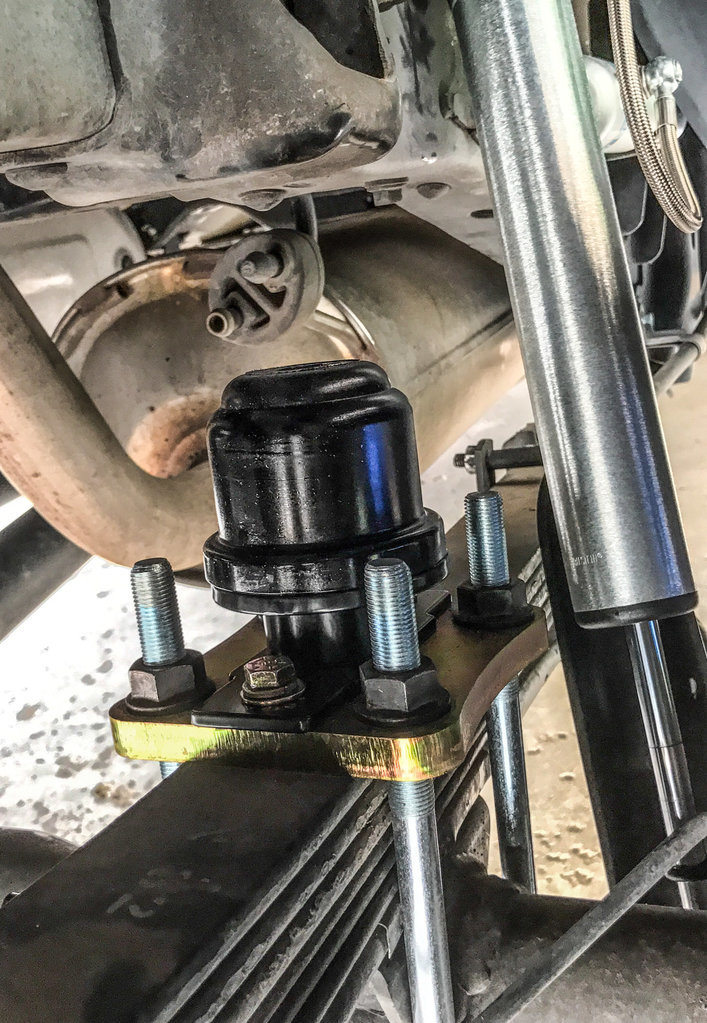

    Tibetan Nomad
    Tibetan Nomad Well-Known Member
    Dec 9, 2016
    #204436
    905
    2016TRDOR:DCLB:JBL
    NitroGear5.29,B6112,.25"spcr,SPC:UCA,Diff-drop,ECGS
    B5160,Dakar-HD-leaf-pk+OL,UBolt-Flip,33s,Superbumps
    No instructions included but pretty self-explanatory and per Wheelers "...compress the lock washers that come as part of the hardware.."
    Installed pics below:

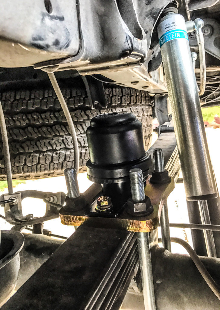

    Tibetan Nomad
    Dec 9, 2016
    #204436
    905
    2016TRDOR:DCLB:JBL
    This is about 2 weeks after the install. Will post more later.

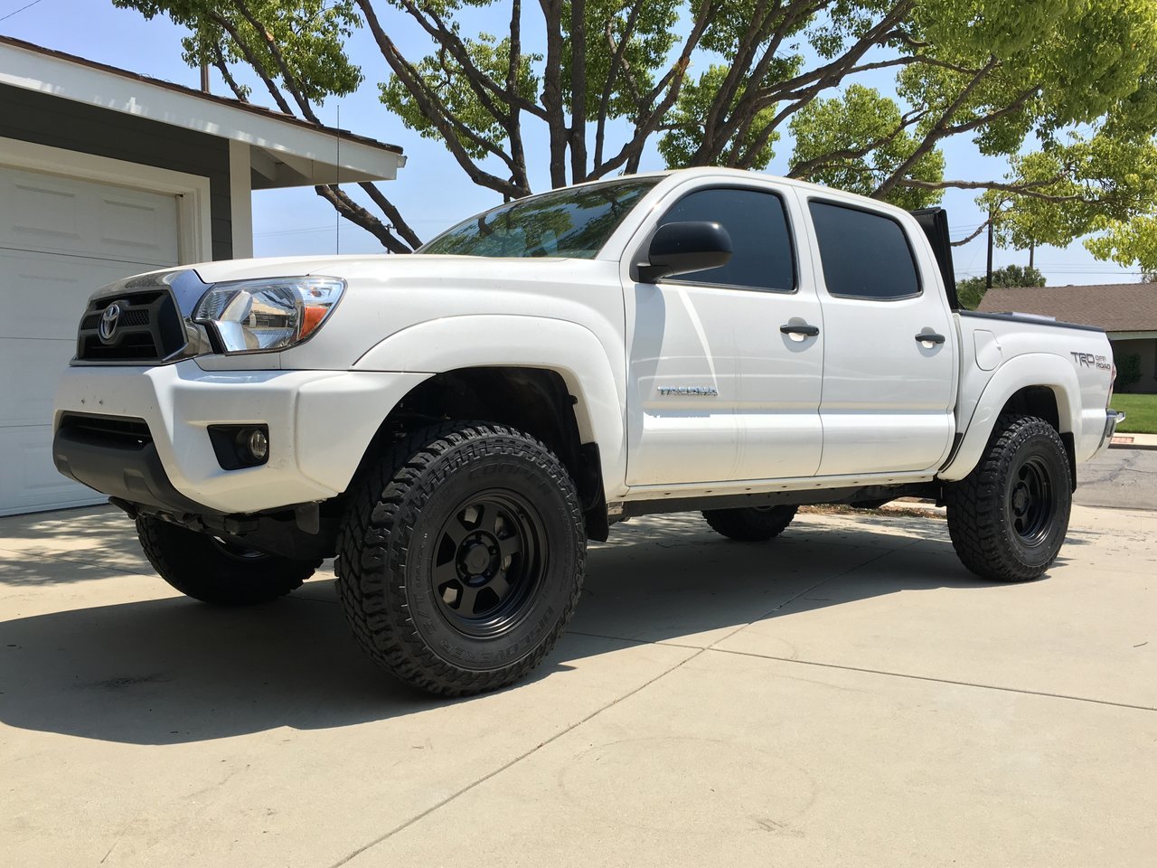

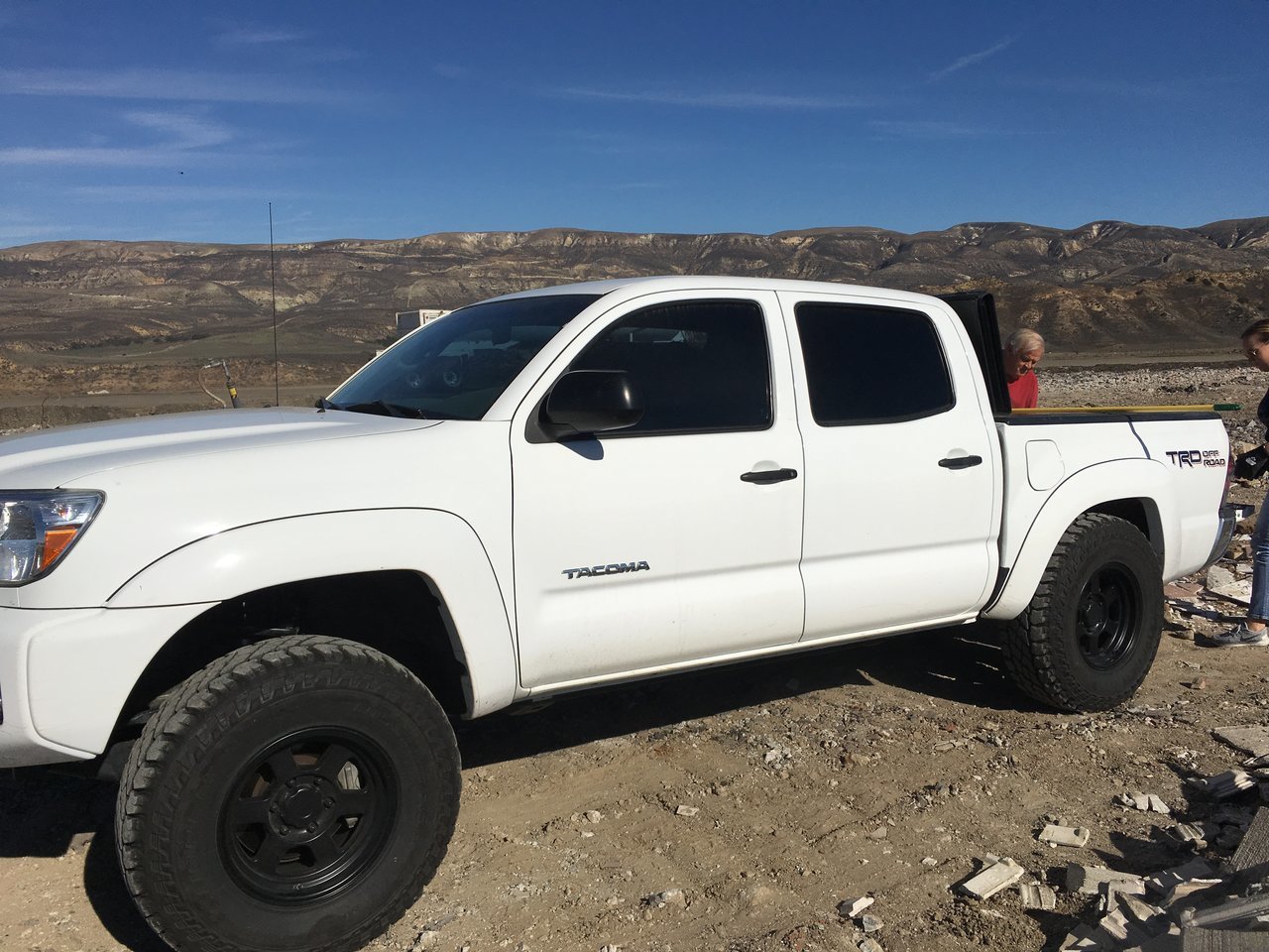

    Rebhuhntöter
    Rebhuhntöter Member
    Nov 22, 2015
    #170416
    16
    So-Cal
    2014 Super White TRD OFF ROAD 4x4 DCSB
    Bilstein 6112 & 5160 FN 16" Countersteer Type X Cooper S/T Maxx 255/85 R16
    I've got 12K miles on the same Bilstein setup and feel like I should have just bought the 5100's. The 6112's are definitely beefy and the ride is noticeably stiff. It only rode like a Cadillac on the way to the dump when I loaded the bed up with demo'd ceramic floor tiles!!
    This is my daily driver and a take my truck out to the desert to go hunting. I never go bombing through the desert at high speeds because I'm looking for the quail and chukar! IMG_4355.jpgIMG_4381.jpg IMG_2769.jpgIMG_2697.jpg IMG_3578.jpg

    It's probably those tires or did you max out the 6112s? Something does not sound right. The 5100s are stiffer than 6112s and the 6112s are better shocks. My truck does not ride harsh at all with 6112s but I'm stock tires and only 1.5" lift.

    Rebhuhntöter
    Rebhuhntöter Member
    Nov 22, 2015
    #170416
    16
    So-Cal
    It's just a stiffer suspension than the TRD Bilstein's that came on the truck. I knew this but after 12K miles, I wish the ride was a tad softer and/or I could adjust the shocks. Mine came set at #4. Gave me about 1.5" all around.

    Rebhuhntöter
    Rebhuhntöter Member
    Nov 22, 2015
    #170416
    16
    So-Cal
    Well, I'm going to have to renege on my statement that the Bilstein's 6112/5160 combo gave me 1.5" all around. This is NOT a true statement, I MADE A MISTAKE. :notsure:
    Like I said, I installed the 6112/5160 Bilstein's 12,000 miles ago with the HeadStrong progressive 3 leaf add-a-leaf. I left out the Toyota OEM overload leaf and the front shocks were set by Headstrong at setting #4. I really don't know where they're getting their springs from but I think they may be from Eibach.
    Here's the measurements I had PRIOR to the installation with the factory, OEM TRD shock/spring combo at 40,000 miles. The measurements were from the precise center of the hub to the bottom edge of the fender. I measured three times!!! These are the measurements I got from MY truck, your measurements my vary...
    FACTORY OEM TRD MEASUREMENTS AT 40,000 MILES:
    Front left: 19 3/4" Front right: 20 1/4"
    Rear left : 20 3/4" Rear right: 21 1/2"
    BILSTEIN 6112/5160 w/ 3 LEAF ADD-A-LEAF
    12,000 MILES LATER:
    Front left: 22 3/4" Front right: 22 3/4"
    Rear left: 22" Rear right: 23"
    That's a GAIN of 3" to the front left and 2.5" to the front right as well as 1 1/4" and 1 1/2" to the rears. Once again, this is setting #4 for the front shocks.
    Weird numbers, I know! Regardless of the initial measurements, the front is sitting even but the rear has the "taco lean".
    I welcome anyone to come meet me in the Ventura County/San Fernando Valley area to personally measure all they want and to test drive my truck as they see fit !!!
