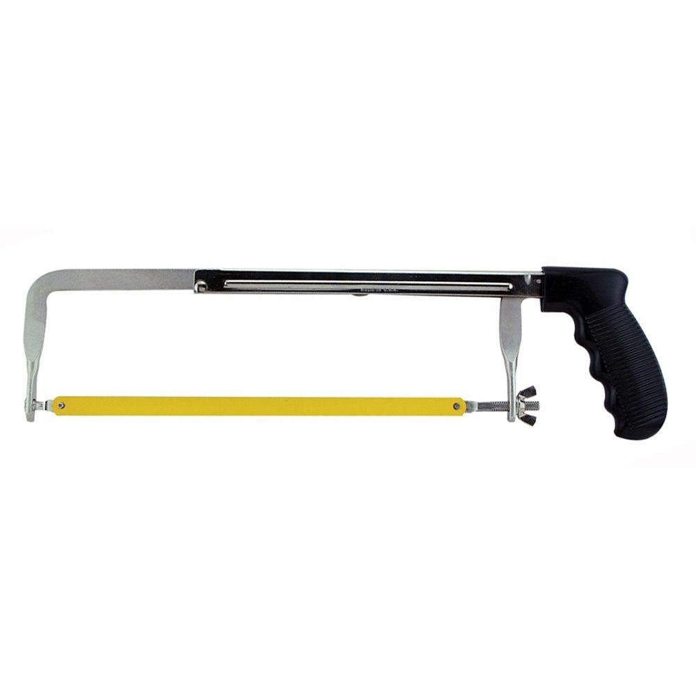

    Is it a must to cut the u bolt threads? I lack an angle grinder. :(

    I've gotten pretty far with one of these:

    So I decided it is a must. I have so much thread left over I had no chance of getting on socket on. Found an angle grinder to borrow so I'm good now.

    For those in need of an angle grinder. Harbor freight has them for about $15.
