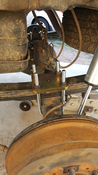

    I read one of your posts that you had add a leaf and left overload in, but the picture above, shows the overload leafs removed, could you clarify...thanks

    Thats not my pic. It’s from Smitty’s original post and he removed the factory Overload leaf. I was asking him a question regarding Superbumps plate...

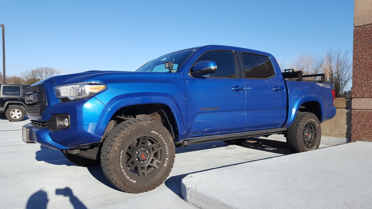

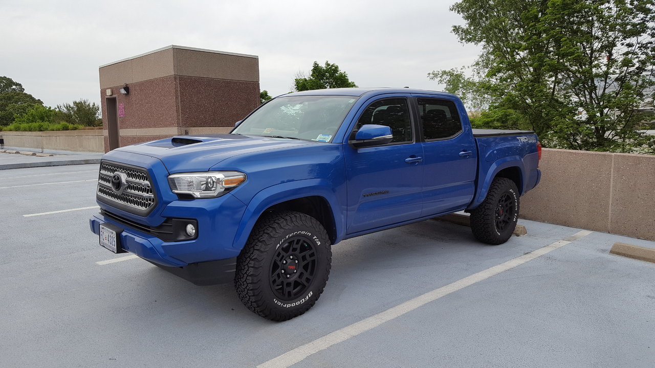

    Alright... here you go
    Before:
    After:

    what setting do you have for the fronts?

    5/4. Everything's listed a couple posts up on this page.
