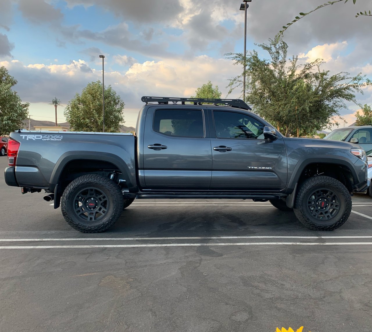

    6112/5160s w/ camburg UCAs 265/70/17 wildpeaks JP8 conversion kit
    Follow the instructions. Don’t mess up the ride. I’m on 6/5 setting and the ride is awesome. Rides better then stock OR suspension. I also did the UCAs

    Thanks for the response guys , I do appreciate it . I always planned on going with the recommended #4 and #5 settings all along but it just makes me wonder why that extra 1/4” is not recommended . Is the access cab models 1/4” away from some kind of suspension failure ? (I know it’s not, but just saying) Is it a ride quality issues ? Alignment issues ? That’s all . Just being nosy.
    Humper 13 , you Tacoma looks great . What did you do to lift the rear and how high ?

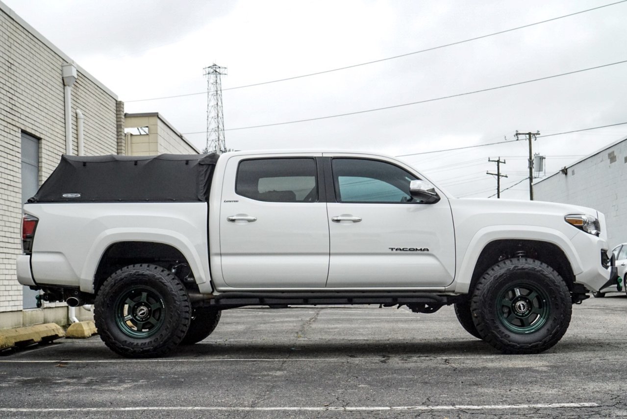

    Using 6/5 setting with 6112 with 650 coils, 5160 in rear.
    Also to give you reference for rear lift , using Icon RXT leaf pack option 3 for a 3in” lift have 1.5” of rake, if you wanted a leveled look go with option 2. Preparing my truck for a steel rear bumper and bed rack 4F5D6EEE-B5A0-47A5-9F77-99DAB5264EA2.jpgB2B28FEF-259A-4FDF-86D2-E29D338D3264.jpg

    Thank you, I have 5160s in the rear with a Headstronf 3 leaf pack. I removed the overload and glad I did.
