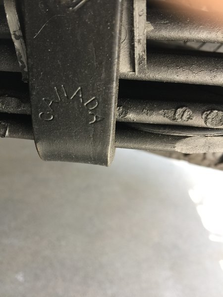

    Believe all the progressive 3 leaf AAL are made by Deaver whether it's headstrong, Icon or wheelers name on the invoice.

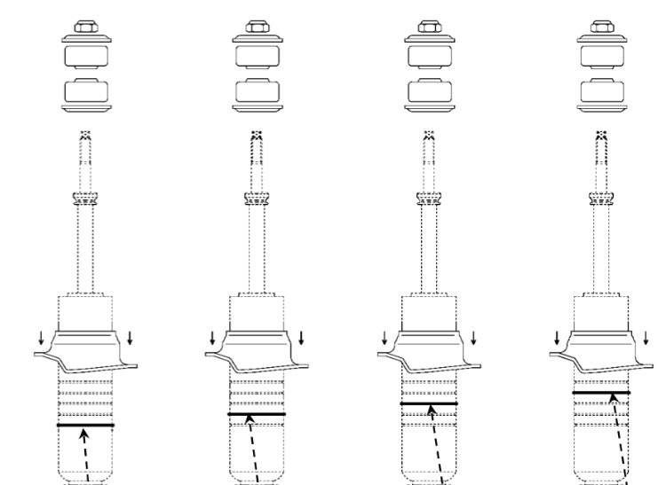

    One more thing, you didn't mention putting on the lower washer and rubber on the Shock.
    Step 12 is perfectly written for this to happen.

    Shock assembly instructions are provided with the shocks and include diagrams. Pretty straight forward. If you can't figure that out then you shouldn't be attempting this in your driveway.
