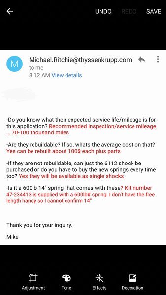

    Do you know what spring rate is on the new 6112s?

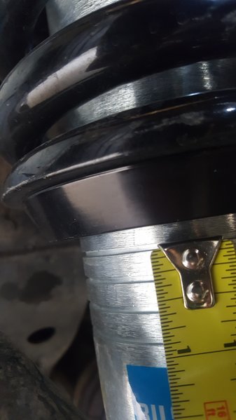

  13. Apr 17, 2017 at 8:55 AM
    #53
    splitbolt
    splitbolt Voodoo Witch Doctor
    Mar 7, 2010
    #32761
    7,858
    NW Arkansas
    2016 TRD OFFROAD DCSB MGM
  14. Apr 17, 2017 at 9:01 AM
    #54
    smitty99
    smitty99 [OP] I also bought a 4Runner
    Sep 10, 2015
    #163923
    12,938
    Scottsdale
    16 TRDORDCSB 4x4 A/T (loaded w/ JBL)
    6112s/5160s & 3-leaf AAL;ubolt flip kit;Superbumps
    Does this photo allow you to do the math?

    Tech info direct from bilstein on these 6112 specific questions
