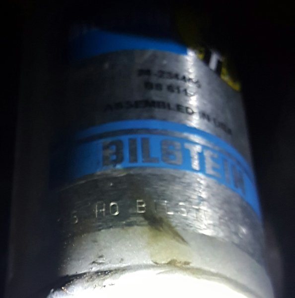

    Hey @smitty99, I got my 6112s today from Race Consulting and the part number on shock boxes is 24-234405. I ordered 47-234413, and that's what my sales receipt says... Did your boxes have the correct part number on them, or could this be an international number?
  8. Apr 20, 2017 at 7:33 PM
    #68
    smitty99
    smitty99 [OP] I also bought a 4Runner
    Sep 10, 2015
    #163923
    12,938
    Scottsdale
    16 TRDORDCSB 4x4 A/T (loaded w/ JBL)
    6112s/5160s & 3-leaf AAL;ubolt flip kit;Superbumps
    Check the part number on the shock itself yes I remember thinking the same thing when I saw mine come in
  9. Apr 20, 2017 at 7:43 PM
    #69
    CenCal805
    CenCal805 Well-Known Member
    Dec 29, 2015
    #173422
    543
    California
    2016 Tacoma TRD OR AC
    Yeah, the shocks themselves have the 23-234405 part number too. It makes me wonder if I got the wrong shocks. I guess I'll shoot them an email to make sure.

  11. Apr 20, 2017 at 8:16 PM
    #71
    smitty99
    Sep 10, 2015
    #163923
    12,938
    Scottsdale
    You have the right ones. Just snapped this photo outside really tough to get in there for a clear photo and it's dark but your shock body part number is the same as mine.
