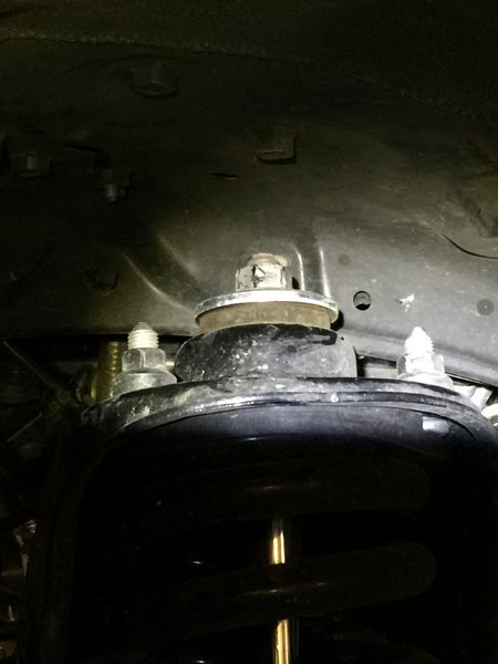

  15. May 26, 2017 at 11:57 AM
    #95
    avitaco
    avitaco Well-Known Member
    Sep 9, 2016
    #196822
    1,011
    A
    2017 DCSB 4x4
    DUDE........
    My 6112 broke... : (
    The hex bolt on the top assembly snapped off. It sheared right in half. Now I cant remove the top nut to adjust the clip anymore. When I called Bilstein they blew me off and said it was my fault. But I spoke with a regional manager at an expo and he is sending me out a new one... thank goodness.
    I need to run at 6/5 to clear my 285/75's

  16. May 26, 2017 at 11:58 AM
    #96
    smitty99
    smitty99 [OP] I also bought a 4Runner
    Sep 10, 2015
    #163923
    12,938
    Scottsdale
    16 TRDORDCSB 4x4 A/T (loaded w/ JBL)
    6112s/5160s & 3-leaf AAL;ubolt flip kit;Superbumps
    Any pics? I'm curious to see what the failure looks like.
  17. May 26, 2017 at 12:02 PM
    #97
    avitaco
    Sep 9, 2016
    #196822
    1,011
    A
    2017 DCSB 4x4
    yeah.. it was clean and snapped right off

  19. May 26, 2017 at 12:05 PM
    #99
    GPsevinSixx
    GPsevinSixx Well-Known Member
    Aug 15, 2016
    #194631
    3,022
    Ros Angerus
    2015twoAX2.4techPAWS
    6112/5160AALfnCNTSTRyokG015
    Looking at the tool marks on the top nut and the shaft, curious if it was overtightened or someone used an impact gun on it. It doesn't require much torque to get tight. I think it was something ~13-15 ft lb.? That's a clean break though.
    Who did the install?
