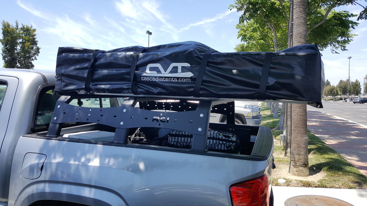

    awesome thanks again. look forward to buying my bilstiens, but I plan to add a deaver expedition pack instead, (I have a cvt rtt (big one) and rci rack, so I have over 300lbs with just that)

    Probably a good idea to go with that leaf pack!
