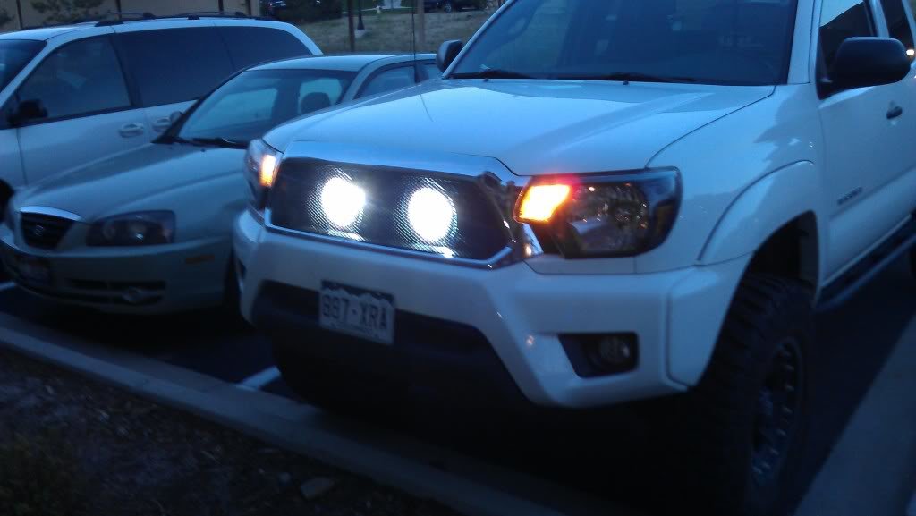

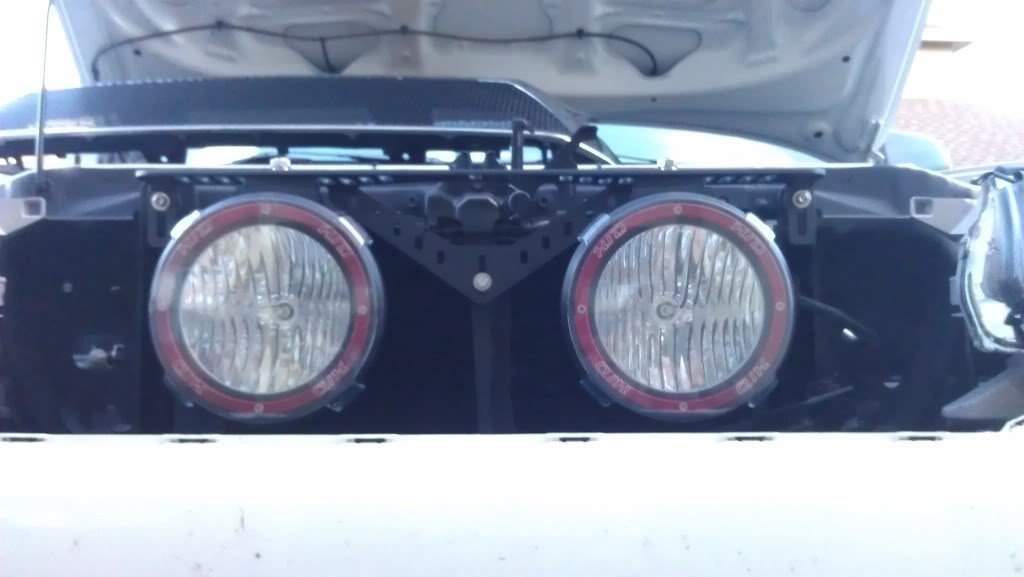

    First off I had originally ordered a powder coated light bar from Bay Area Metal Fab and was blown away with the quality of everything, just like my sliders (different topic). I had a Grillcraft insert for my truck on order but as soon as the light bar hit my front door it was on and I was wiring up the lights. First issue was the location of the transmission cooler. I had to move that, no big deal. Next was after the lights were on the bar, they sat way too low for the opening of the grill. I have 7 inch lights and about 2ish inches of them was below the highest part of the grill opening. No bueno. I decided to wait for the GC grill to show up and see how it ended up. Still a no go for my preference and for premium light output.

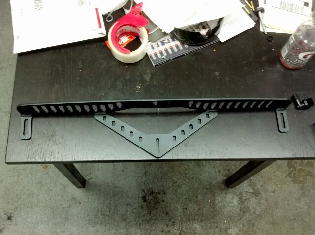

    At this point I was thinking about chopping up the light bar that I had and welding the outer mounting tabs to the bottom. I ended up talking to Jerry and after some convincing he built me a bar that would lift the lights higher in the grill opening.

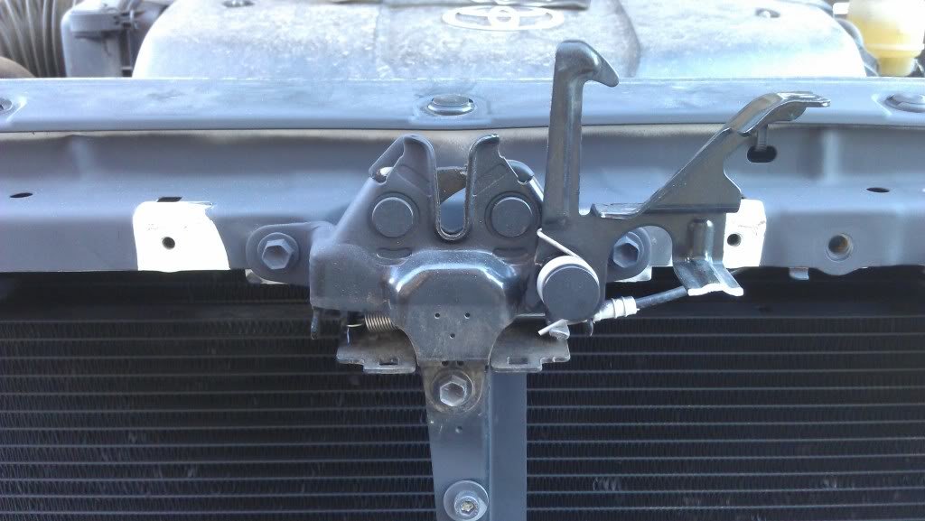

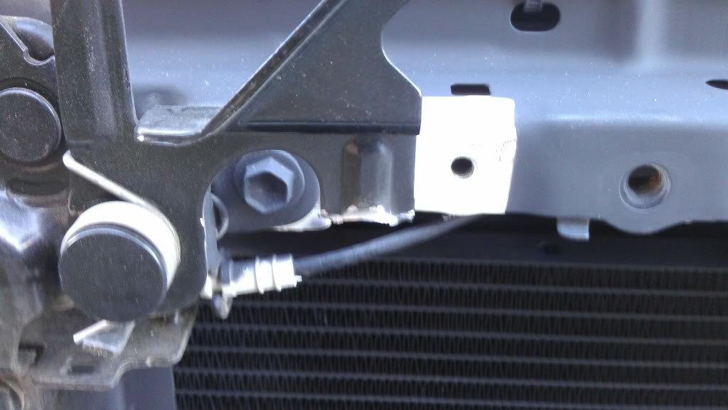

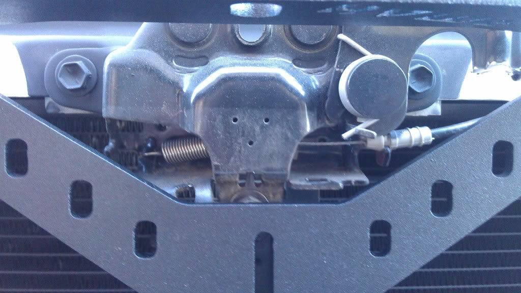

    I got it in today finally and he treated me to this new powder coat blend that he’s been bragging about… and yes it is AWESOME! After ripping the box open I started the install. I found that the hood release latch needed to be cut down, and the cover for the latch assembly also needed to be removed.

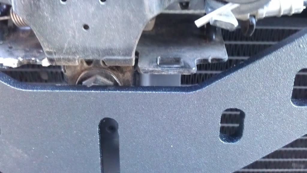

    After doing this I ran into some issues with the bottom tabs of the latch assembly that need to be cut a little bit…

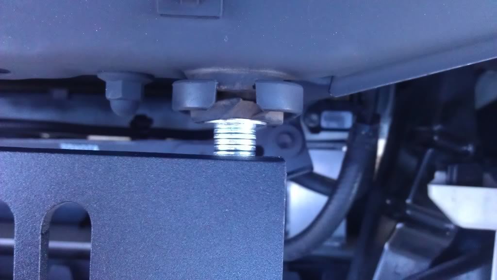

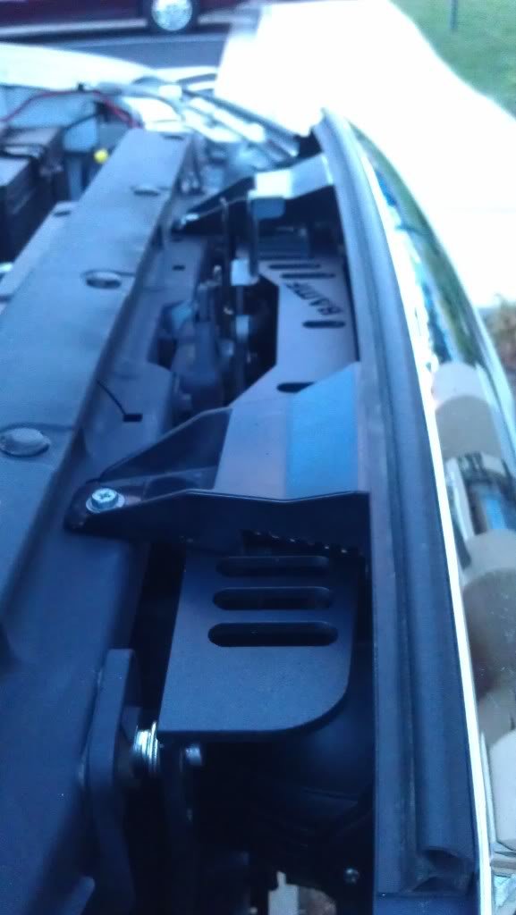

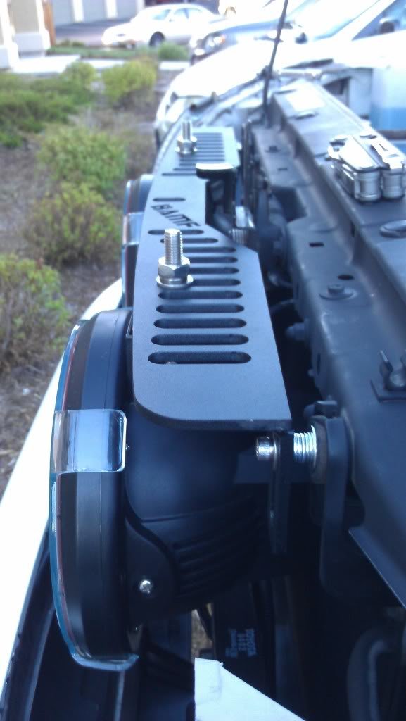

    Once this was done I found that the bar was not going to fit flush unless one of two things happened. Either it was getting cut or I was going to space it away from the radiator mounts with washers. I went with the washers.

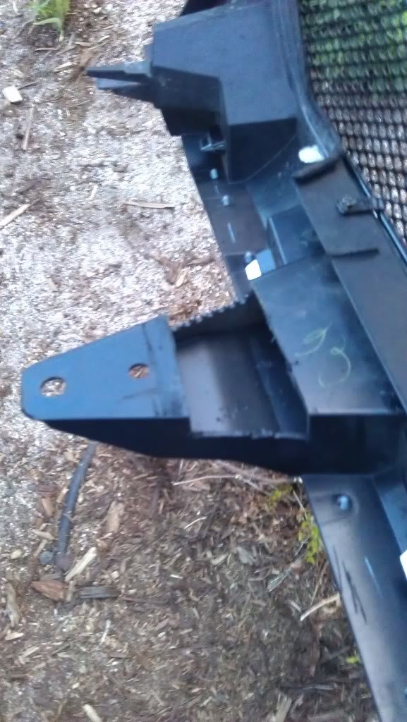

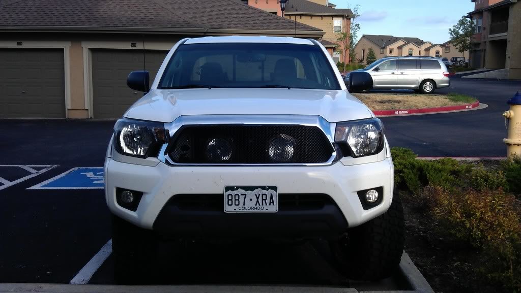

    With the bar now mounted I got the lights on and started to test fit the grill. It was not going to fit at all without modification either. This was for two reasons. The light bar itself was preventing it from sitting even remotely close and that where I mounted my lights were right under the two middle supports. I channeled out the supports and cut down the mounting bolts from the lights.
    Now once this is done it’s a little tricky to get the grill over the light mounting bolts while getting the bottom tabs in to the bottom bumper but with a little finesse success will be achieved!
    Now I can’t say for not if Jerry is going to offer this light bar setup, but for those who don’t mind carving out your grill… I would most definitely recommend this if you plan on running anything bigger then 4 inch lights behind your grill.

    Was there any modifications to the light bar other than flipping the mounting tabs over? I got some 7" lights I'm looking at using with my bamf lightbar, so if its just relocating the tabs, ill probably just cut and reweld them.
  15. Aug 17, 2013 at 5:25 PM
    mclovin
    mclovin [OP] chicka chicka, yeah!
    Aug 23, 2011
    #62195
    538
    Biloxi
    16 TRD OR DC Barcelona Red
    Prev, 04 Xtra Cab Prerunner, 12 SR5 4x4 AC
    yeah, the tabs just went from the top to the bottom.
