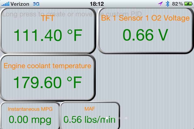

    My drive to work yesterday.

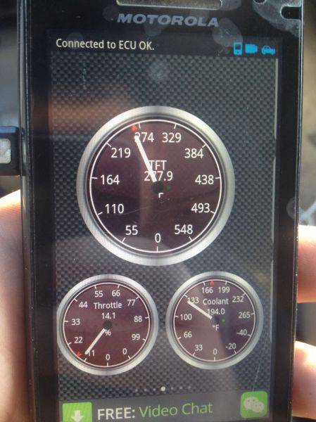

    I was able to create a custom PID with the free version of torque, I had to unplug and replug my ELM327 (OBD thingie) before the TFT showed up on the gauge.
    I'm not so sure of the temps i was getting though.
    This was right after i'd taken my truck for a short drive (.3 miles max) with very little idling.

    161.2

    I reentered the PID this morning to pull that number (i guess it disappears if you close the app) and then went for a mile long drive and got these numbers

    I'm not sure...
    I'm using an iPhone and an app called Engine Link, but they both require the same PID information, formula, etc.
    Here's another shot of mine while at the drive-thru pharmacy.
