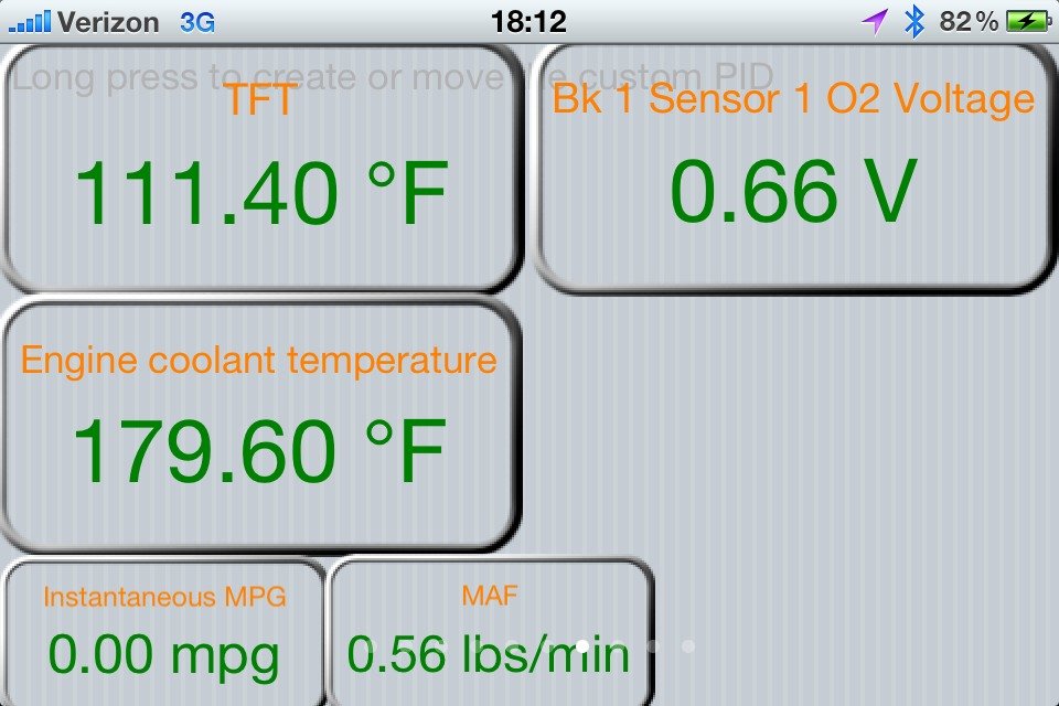

    Hey Guys,
    I bought the iSaddle Super Mini ELM327 V1.5 OBD2 OBD-II Bluetooth CAN-BUS Auto Diagnostic Tool from Amazon $10.99 and the Torque Pro app $5.00 and it looks like it can provide a lot of valuable info for sure.
    I also just bought a 26' travel trailer and I want to get a good baseline of important parameters of normal driving and then when towing the trailer.
    What would some of the displays you would be looking for that would be showing from my 2011 Prerunner 4.0L Double Cab with Tow Package (Stock)
    Cheers,

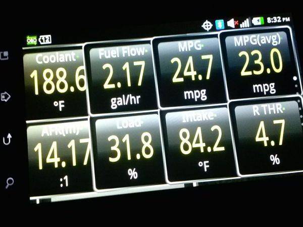

    this is my screen (i use an old phone that i had the app on so im not interupted by calls and text and i can leave it in the truck on the charger all the time) coolant temp instant mpg trans temp engine load intake temps and throttle position are all i really care about and i think that would be a good startin point for u to look at since ull be hauling.

    OK so I created these two custom PIDs and now have them as gauges to choose from. So now I am confused as to why there are two and how do I use them. I added them to one of my screens, I haven't been back to my truck to look yet but whats the deal with two gauges?

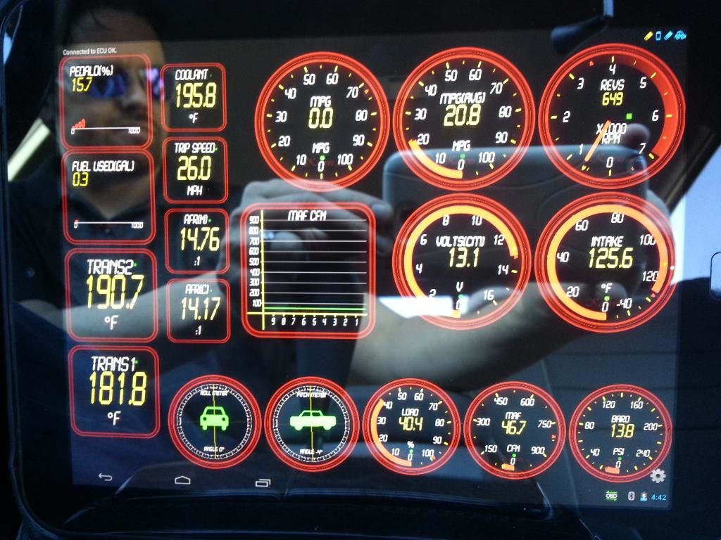

    This is my Torque setup running on an HP touch pad I got for $20

    Ok set this up and added the two guages to one of my screens.
    Keep in mind I live in Phoenix AZ and it's over 100F right now. I have the tow package so that includes the trans cooler.
    Does these reading look reasonable and again back to my previous question. Why 2 settings?
