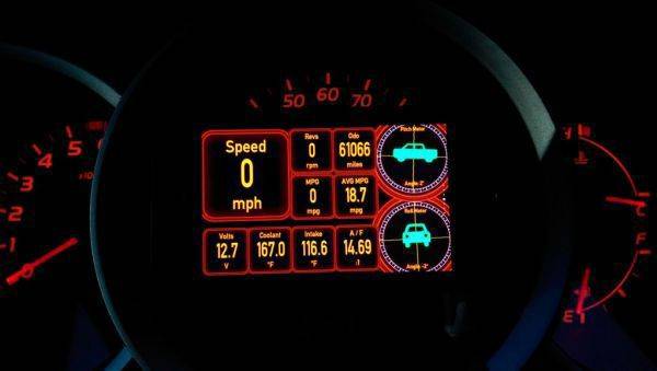

    My current setup/layout.

    What is this? I like it!

    I've created an extra PID on mine for a more accurate speedometer since I have 33's. I used PID 010D, and the equation (A/1.475). Seems spot on with the GPS. Assuming the original PID is accurate, my actual speedometer was off about 2~3mph compared to what the ECU was outputting.
    Oh and after reading through this thread, Torque has an option to automatically disable bluetooth and go into airplane mode when the phone isn't connected to power. No need to exit Torque all the time.
    The device? My old HTC Incredible (AMOLED version).

    That is an awesome find. I run this app on a few different cars and trucks which all run custom sized rims and tires. It's always bugged me that the mpg was off.

    No, the program. Your icons look different and I didn't know it told vehicle angle!?

    Torque Pro. It's all the standard icons. I've modified one of the themes to blend in more with the Tacoma.
