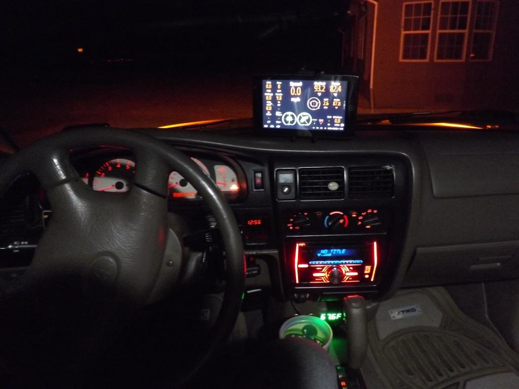

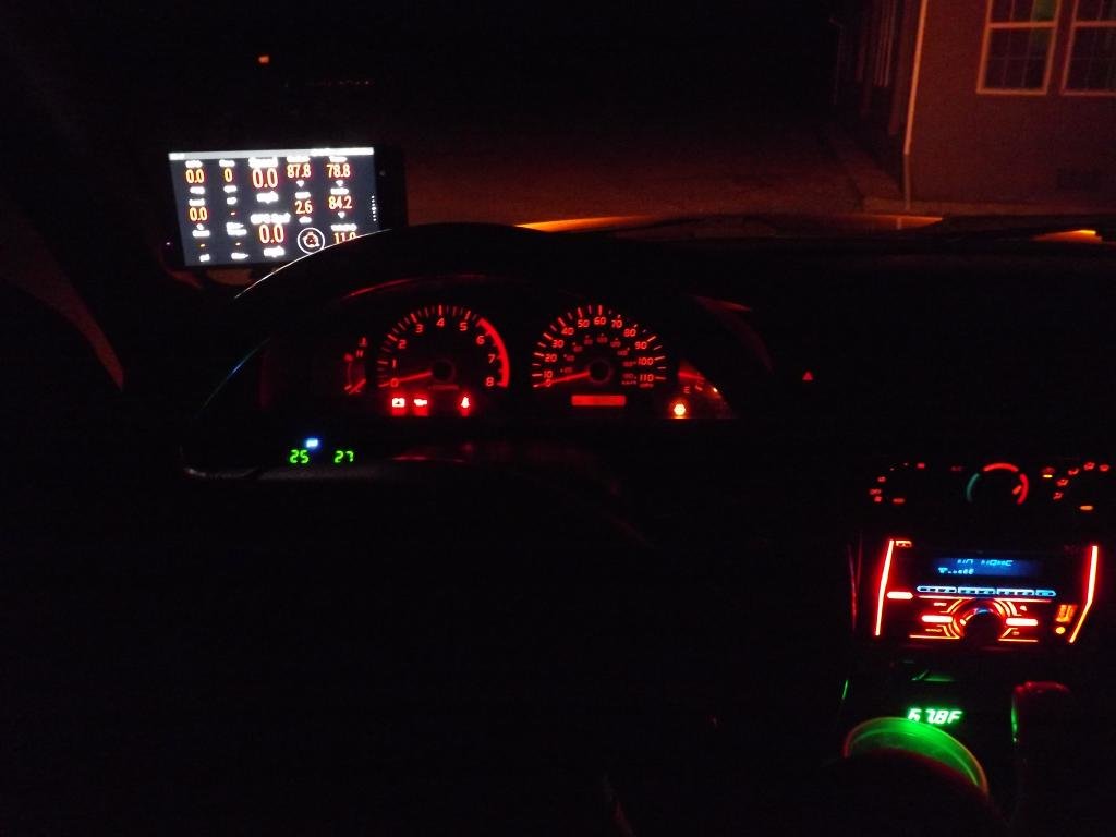

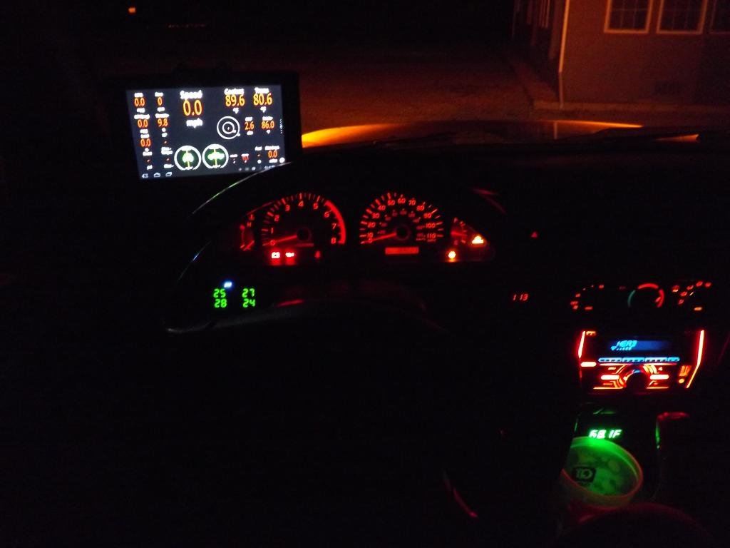

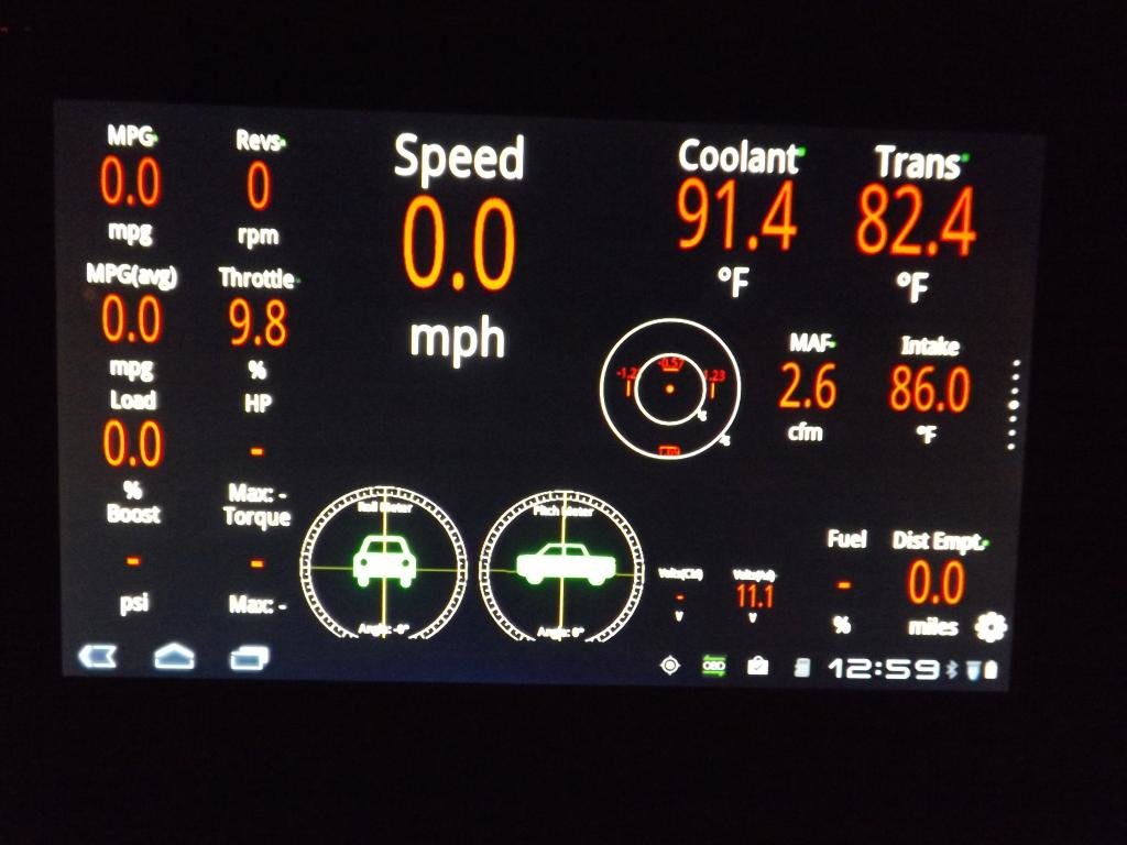

    Hmmmmmm... I just dont know. This 7" acer iconia a100 tablet is just letting me down big time:( I kinda like, kinda dont.Been messing with it all night. Got it pretty much set up and even connected it to my phone with the mobile hotspot if I ever needed it on the road. It LOOKS AWESOME as far as a tablet goes holding it in your hands, and the feel of it. Doesn't feel like a cheapo, yet it kinda performs like one. I think its probly worth the $60 I paid for It but... Idk, this tablet kinda sucks really. Screen viewing angles suck. It's pretty laggy when using it as a tablet as far as using things like live wallpapers, Internet browsing, downloading apps... Maps seems to work really well so thats a plus. Torque seems to run fine. And thats all I bought it for really. Dedicated torque display with nav and possibly music library. Although, I have to say the tablet is a little too big for torque. It's not even that much bigger than my phone, screen wise but still. The entire tablet is of course a lot bigger, but for what info there is for this app to go on screen, it was easily and PERFECTLY crammed into my HTC One Max. And thats a 5.9" screen. Fit perfect in the mount I got, And fits perfectly in the left hand side of the dash/windshield just behind the steering wheel. But the biggest factor for me with using my phone, is that I wanted to keep it that, a phone. I did not wanna deal with removing/replacing in truck every single time I get in/out! Sigh. So I tried multiple spots and angles and just couldnt seem to find the sweet spot for this tablet. I REALLY want it on the windshield as close to 'line-of-site' as much as possible so thats a no-go for mounting it low like in front of stereo or off to side. The gauges fit nicely on screen and were kept pretty much the same size (small for most), just spaced out a little more. They ended up just being a tad larger than on my phone, and I didn't really care for that either. If I had changed the size of the gauges one size smaller (to tiny), they were just way too... well... tiny, at that point (lol) and would've left a LOT of open space just on the main screen. And I didnt wanna fill it in with a HUGE speedo gauge, or fill it in with all the other useless gauges/sensors available, or something of that nature. Idk, I'll mess with it tomorrow in the daylight and take it for a drive and see how I like it. But I may end up selling this tablet to a friend and just use my darn phone. I took some pics too. Hard to tell how big it really is at night, which is why i'll take some shots tomorrow.
    And sorry for the blurry shots. Could not get my camera to focus properly for nothin. sigh..:(
    This is pretty much all the gauges I could throw on there, as I think anything else is just useless.
    Here's a shot of the tablet mounted just above the dash. (Not diggin it)
    And the left side where I like it best. 1st pic is the tab, 2nd is phone.
    Kinda hard to tell but It's a big difference. Maybe I should just take a video or something. If anyone is even reading and caring about any of this shit I'm rambling on about.. Ha.. But I'm hoping it may help some who are deciding on going "big" on their screen. When IMO, is not really a good idea. It really does seem to work/look better on phones. At least the larger "phablet" type phones which most everyone has nowadays. I would say it would be a better investment just to upgrade your phone to a larger screen if you've still got a tiny one;) and dont mind the mount/dismount hassle aspect of it.
